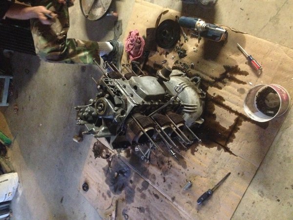

well after seeing how the 66 runs I really just need to stop trying to beat up on a tired old engine and just get a nice dependable drive train. Started going into my engine I bought awhile back which I was told was a good one. So far spirits are high, engine has lightly used pistons that are .020 over and a new oil pump and heads show no signs of a dropped seat. I plan to still put in new seats, seals all around and give it a good cleaning along with refreshing the trans and diff.
Advice is much appreciated, I just need to get a proper running drivetrain then I can focus on body work. :tu:

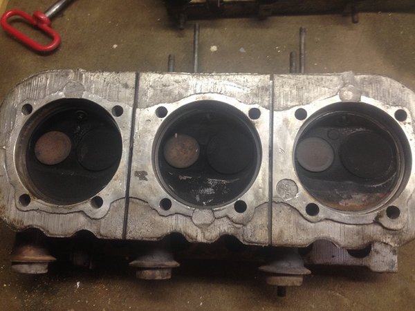

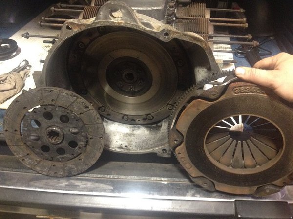

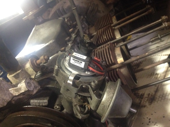

Started digging more into the engine I got. Looks like a lot of nice work was done on it even has reconditioned clutch and pertronix ignition. Still batting around if I should put new seats in the heads or not, if not I would put new valve springs seals and cut new gasket areas.

Spent this evening deflashing my heads. some of the holes were just not there. This should give some really good cooling now! :rafman:
