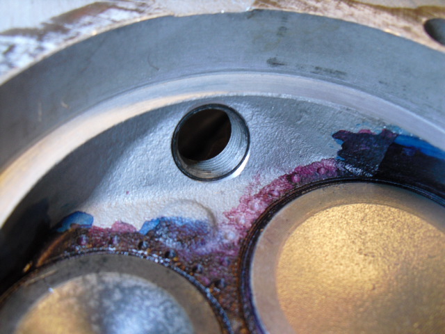

One of the spark plug holes is now stripped and nearing 18mm in diameter, don't know what the PO did to achieve this situation.
What are some options available for repair?

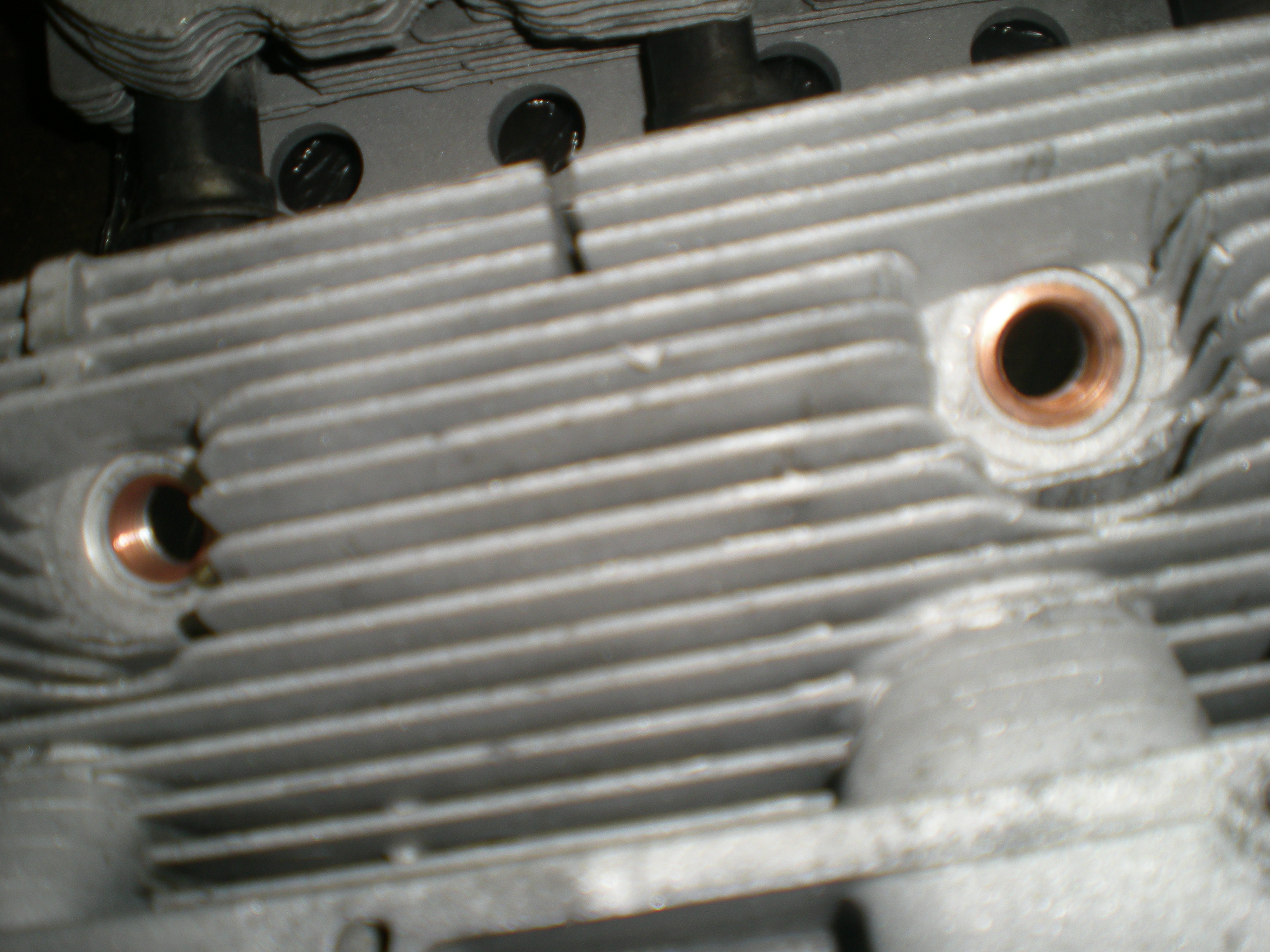

I ran into the same issue with my 63 spyder. I had two spark plugs that somebody, some where in the past, had stripped the threads out. Hey....it can happen. I ended up trying each of recommended Clark's methods for repair. They both worked fine.
Within a few short months of making those repairs, I was still fouling and pulling plugs for other major engine related issues. I hated to pull the plugs from where I had made the repairs for fear of having to do them again.
In the end, I had the heads reworked, I had 6 inserts installed. And it's now the way it should be.

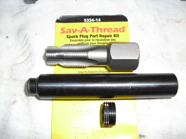

I like the save a thread repair kits as they have serrated top threads that embed themselves in the aluminum when installed properly and they don't come back out, I have used these a lot and have never had one come out :tu:

davemotohead wrote:I like the save a thread repair kits as they have serrated top threads that embed themselves in the aluminum when installed properly and they don't come back out, I have used these a lot and have never had one come out :tu:
DM - thanks for the confirmation, I had used the save-a-thread on one of the other spark plug holes seemed to install rather secure.
