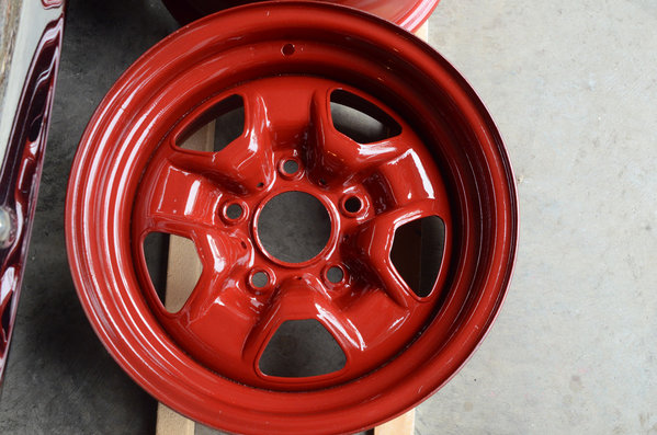

I put 205-70-14's on my 66....they look really nice...they are on 7 in wide rims and no problems....my speedo with be about right. As to correcting the speedometer if your go way off stock diameter tire, you can use a gps system and pretty much estimate how far off you are...also, I know on reg chevy autos that are a little older, there are differnet plastic gears that correct for any size tire just about....its about 30 min fix if that long and pretty easy...a screwdriver is just about it...I have about 4-5 different color ones in a drawer downstairs for a precise calibration...well almost precise.
You can find engine rpm at a particular rear end and tire size easy on the internet....our tires are about 25 + inches high...go with a 26, your rpm drops...and of course so does the acceleration and milege change also. I think a lot of dragracers just change tire size vs rear ends to improve times at different tracks....can make a pretty big difference in performance.
My 49 chevy has an all electronic instrument panel and I can program any correction by changing a few slide buttons....little hard getting it out to do so though...( gotta love that mega buck 59 impala wheel, its real...not a chinese replica that is out there in droves, it took about 80 hours labor for me to get this wheel to look like that...I painted it twice...like I did the car).
