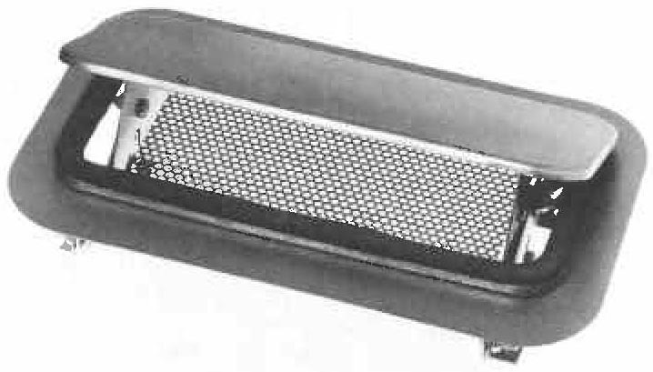

Came across this on the Internet. Not the same size as the Stinger air doors, but would probably work as a repro on a steel hood.
$32.50 each plus shipping....

What's it from? What's the store, specs, or part number? Might be interested in finding something similar myself.
Thanks!

Sorry, I should have posted the link. Here it is: http://polarmfg.thomasnet.com/category/cowl-vents
If you click on one of the pics, it will also give you the size specs and even a downloadable PDF drawing of them.
From what I see they are:
Outside Flange - 11-5/8" long x 6-15/16" wide.
Lid (Door) - 5-3/16" wide x 10-7/16" long
Finish - Zinc plated
Weight - 2-3/4 lbs.
They run $34.50 each plus shipping.
Hope that helps!
I'm going to take a whack at making my own first by cutting them out of an old nasty hood and try welding up some flanges myself. If that proves too hard, I might go the route above. Note that these vents are not accurate to the size of the Stinger originals. But, if you not going for authenticity, who cares...

Stinger doors are 14X4"

Item # 1700, Polar Double Action Side or Cowl Ventilator
:link: http://polarmfg.thomasnet.com/item/cowl ... ator/1700?
Specifications
Outside Flange Length 11 5/8 in
Outside Flange Width 6 15/16 in
Lid (Door) Width 5 3/16 in
Lid (Door) Length 10 7/16 in
Finish Zinc plated
Weight 2 3/4 lbs
All steel construction. 20 Ga. cold rolled steel.
Two way action allows for air intake or air exhaust.
Designed for O.E.M. or replacement on trucks, buses, sleeper cabs,. farm cabs, poultry bodies, vans and off road equipment. Supplied without holts for welded installation. Holes may be added to mounting flange for riveted or bolt on installation. Supplied with perforated metal bug screen.
Weight - 2-3/4 lbs.
