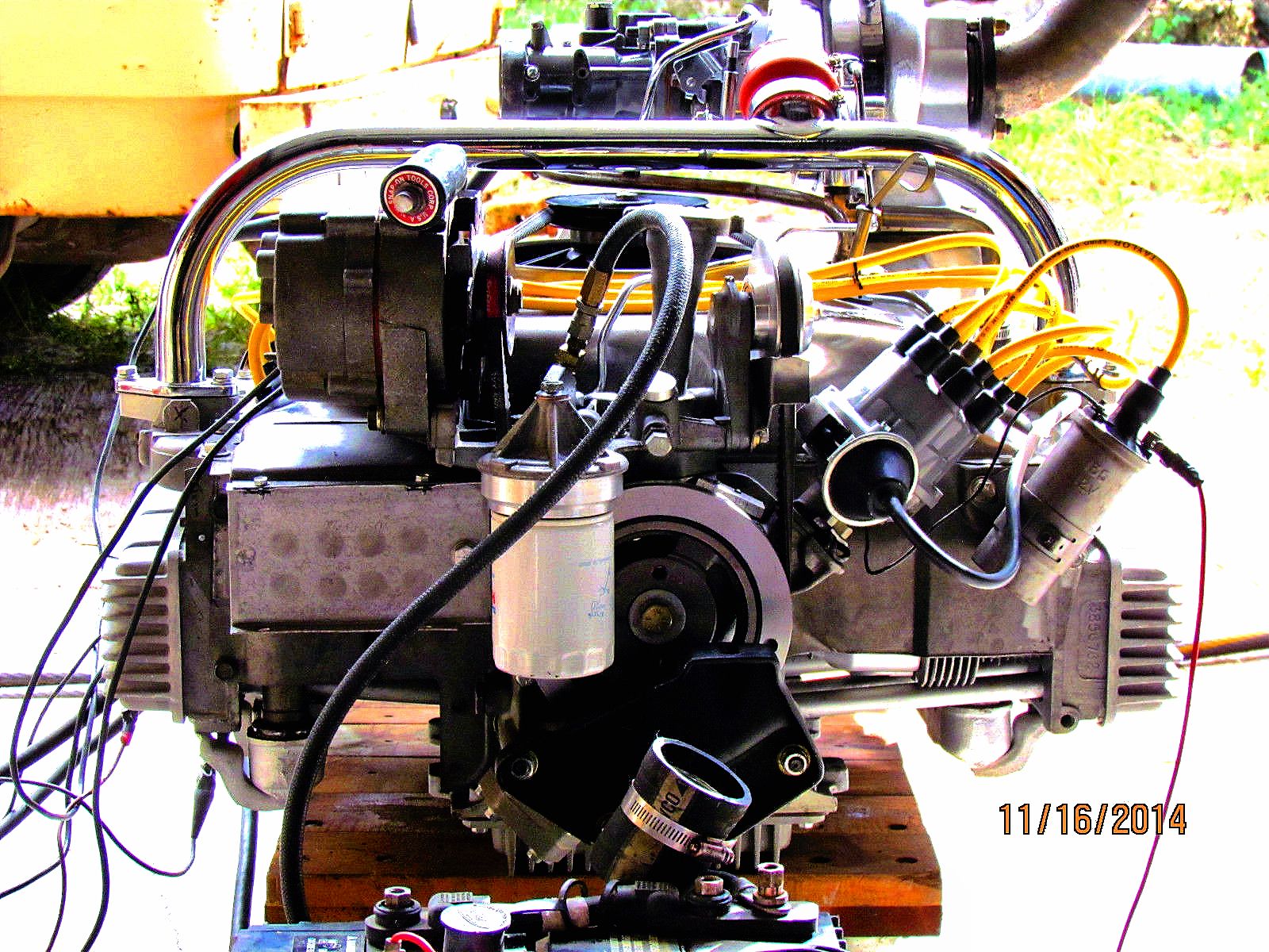

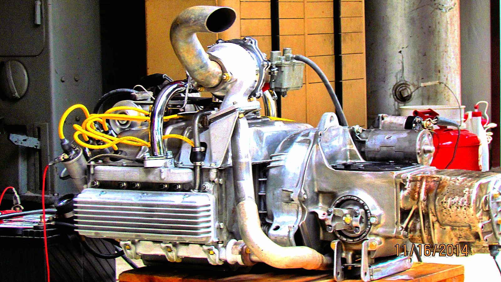

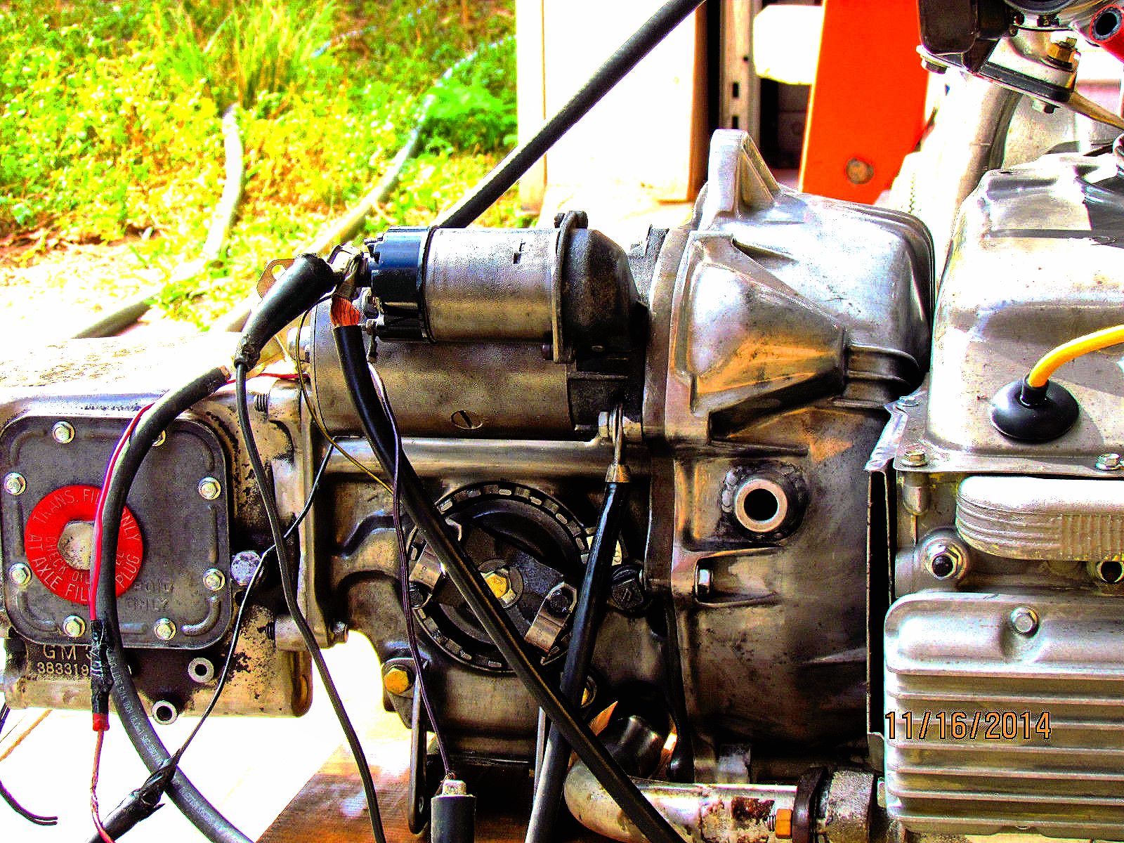

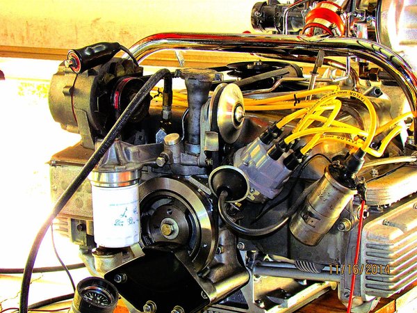

Here is an "ultimate" 180 hp turbo powertrain rebuild offer on eBay. The builder says he has over $13,000 in this powertrain. Bidding starts at $6000, but that won't meet his reserve or his expectations...
:link: http://www.ebay.com/itm/1965-Corvair-18 ... 1528454098
eBay Item No: 111528454098
There is NO TITLE this is for a rebuilt engine only, rebuilt from the bottom to top. Anything worn was replaced or upgraded. Has 3.55 gears. Mild cam / bored 30 over. New flywheel, new clutch. Too much done to the motor to list. We have $13K in receipts not including labor! Can hear run on dollie.
