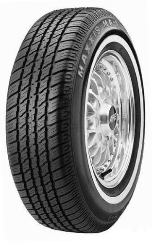

:link: http://www.amazon.com/P185-80R13-Maxxis ... ire+maxxis
P185/80R13 Maxxis MA-1 90S WW White Wall Tire
Eight customer reviews (4 5-Star, 4 4-Star)
Price: $99.99 & FREE Shipping
Only 15 left in stock.
Ships from and sold by BestWheelsOnline.
60,000 Mile Manufacturer Warranty
White Wall
Passenger Tire not Trailer Tire
420BB UTQG
