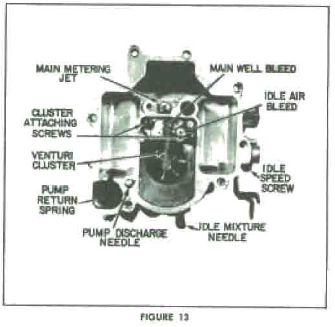

The fact that your idle mixture screws are generally unresponsive can be a clue indicating clogged or partially clogged passages. Also check the vacuum break hoses and diaphragms for leaks.

Ok, so I took off the carbs and cleaned them. Never saw anything so DIRTY inside. Noticed a couple of things: the floats are different from side to side. One has a spring on it and the other does not. The one that doesn't have a spring doesn't have the hole to install one either. How do I handle that? Have to buy two new floats? And which kind would I get, no listing for two different kinds. There was only the spacer under the carbs, no gaskets, spacer looked good. I made four gaskets and put on when I reinstalled them. The book shows a power enrichment needle, I'm not sure about that? I can see some brass where I think it should be but it won't come out and carb cleaner won't drain out of it, looks like a tiny hole there in the brass, but very hard for me to see down a half inch'ish. Its under the venture cluster, right?
Put it all back together and huge difference. Runs much better but still not right. I knew I'd have to clean everything anyway so decided to get that part done while saving to afford carb kits, base gaskets and balancer just to see if it would help, it did, a lot! I did all the adjustments in the book to and hope that by installing the carb kits some of them at least will only have to be checked. My mixture screws now do a little bit to. Still no vacuum at idle to speak of, maybe up to 5 in, raise RPM to 1500 and I get 10-15 in fairly steady. Is that anything like normal? Its a 4 speed so no modulator. I'm sure nothing is leaking air in unless something is cracked in the intake part of the head.

The Delco Rochester Models H, HV Carburetor Service Manual I attached in my earlier post describes this spring and the float assembly in detail on page 3. Your earlier float design will likely work OK. You would have to obtain a used float and spring assembly from a 1964 or later carburetor to substitute the correct unit.
It is possible that the two carburetors are not an exact match. The float may have been replaced, or the entire carburetor may have been replaced with a carburetor from an earlier model. There are subtle differences in different model years. For example, the radial venturi cluster in early years had equal spacing between the arms, while in later years they were staggered.

If the carburetors are mismatched, the differences may not be significant or noticeable. The design changes and the reasons for the changes are described in the Delco-Rochester manual. You will have to decide if the mismatches between the two carburetors are significant or minor.

Power Enrichment Needle...Delco Rochester Service Manual, Page 3 wrote:The 1964 and later Model HV carburetors use a torsion spring to increase the holding power of the float needle against the float needle seat. The float assist spring was added to maintain a constant fuel level during extreme rough road operation. Changes in the float pontoons and hanger were necessary with the addition of the torsion assist spring. The float torsion assist spring should not be used on earlier models as float settings and float levels differ.

There was no power enrichment needles in either carb. I was very careful during disassembly on a white piece of poster board, I'm sure I didn't lose any parts. I'm also pretty sure neither acc pump is working though the cups do look good. Is there supposed to be a check ball under the pump? Or does the pump discharge needle take care of that. By the way I am studying the carb manual But the drawings are so blurry and I'm not real bright so I don't get everything. I just want to make sure I order everything I need and nothing I don't first try. I just can't spend over a hundred on those super delux rebuild kits.
The metal tags are still on the carbs, WOW, HUH?. Both are 7025023 but the numbers under that are different, one is FS, or F5 with ABG or ?BG. The other is a backwards C or 9 S, or ?S, followed by again ABG or "something" BG. So they are different in some way. I found the 7025023 number in the manual link you gave me as that they are HV. Can't find anything about the other numbers though I'm sure they mean something.
