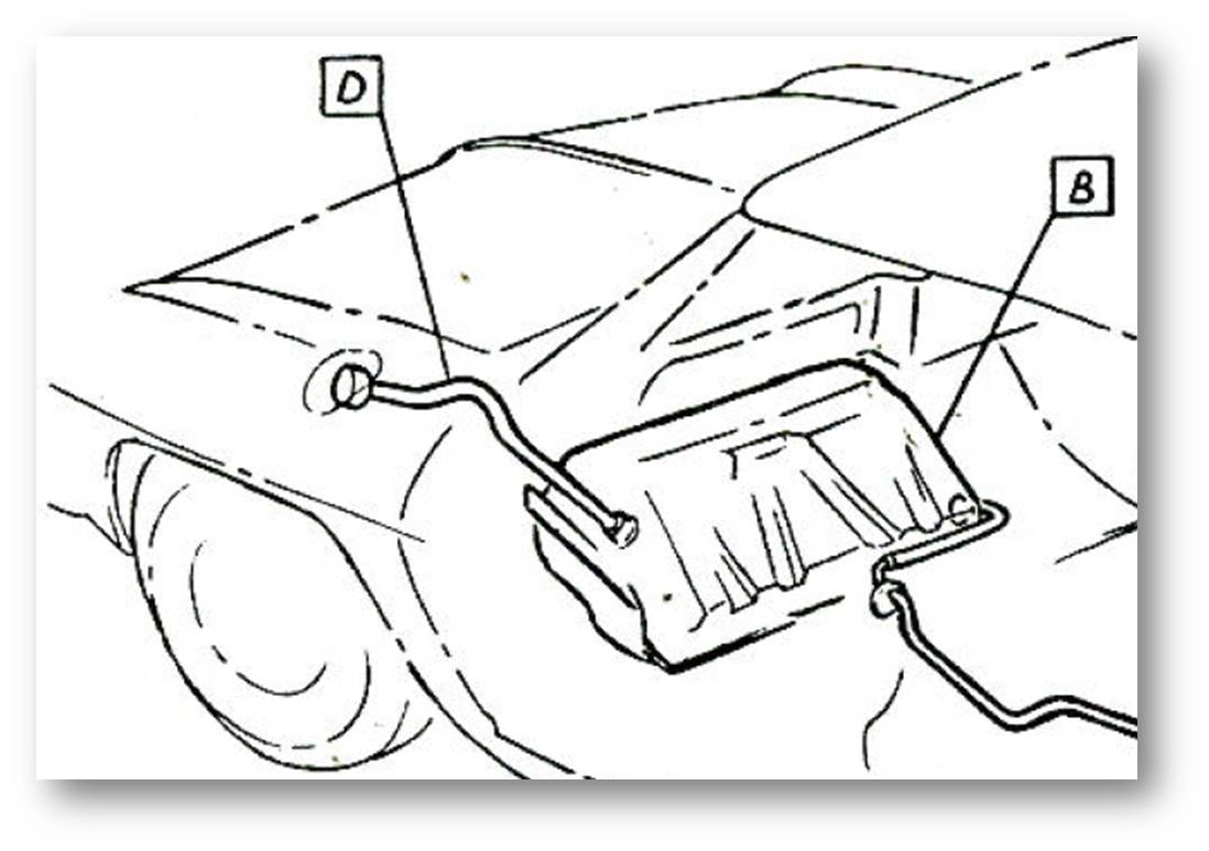

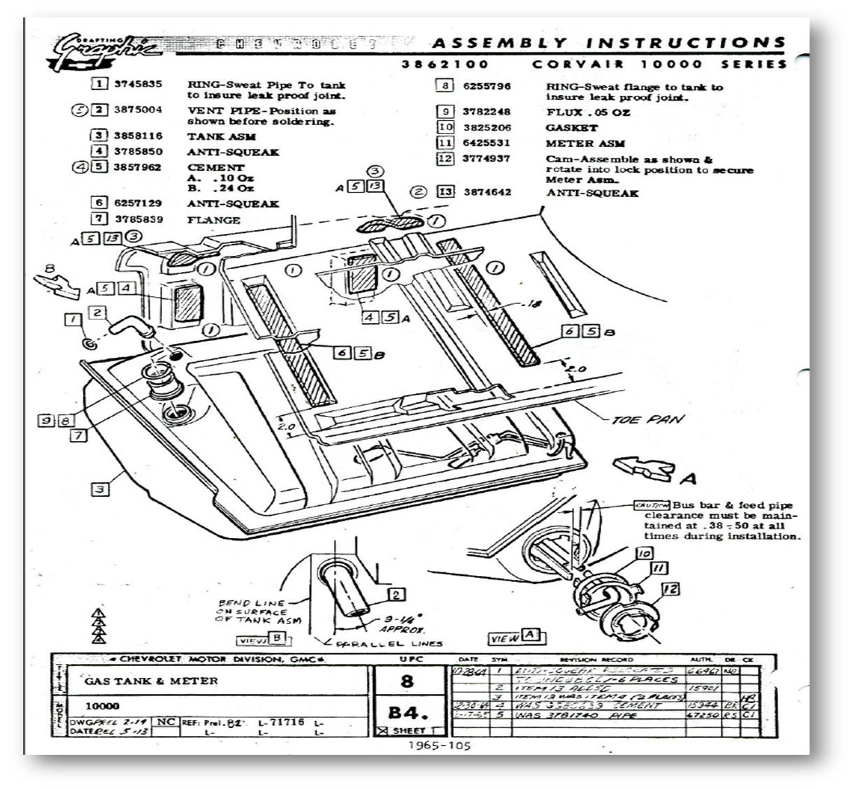

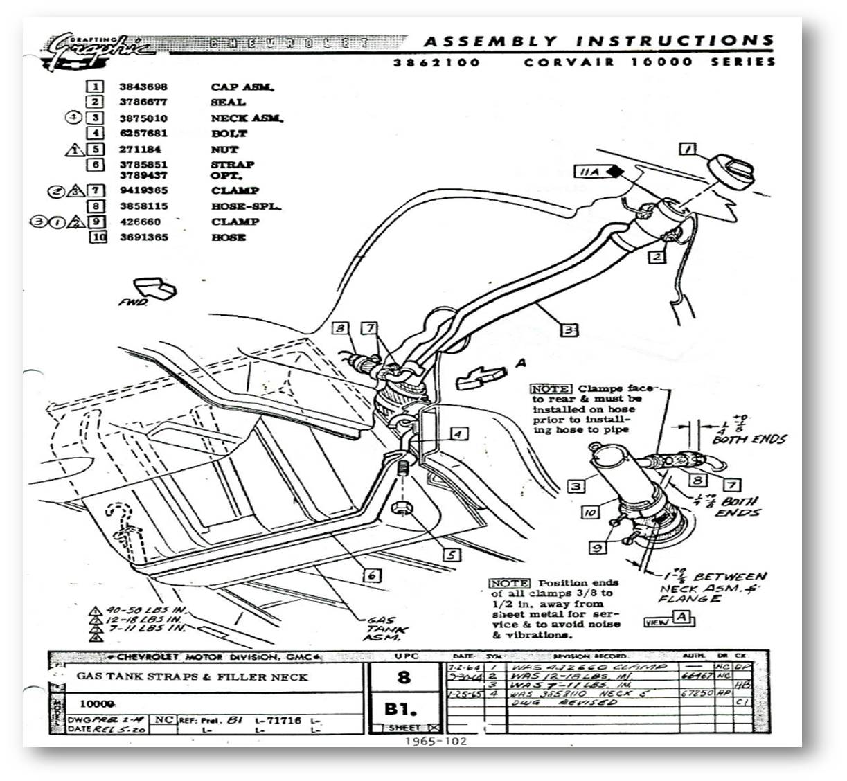

:wrench: I have attached diagrams from the 1965 Corvair Assembly Manual to illustrate the tank installation, and also attached the section of the 1961 Corvair Shop Manual and 1964 Shop Manual Supplement, as well as the 1965 Corvair Chassis Shop Manual (in Adobe Reader format) that will provide you with procedures for removal and repair of the fuel tank.
If the hose is leaking, it requires a special size hose as shown on the second page of the Clark's Corvair Parts catalog, as shown below...

1965-1969 Corvair Fuel Tank Diagram
1965-1969 Corvair Fuel Tank Straps and Filler Neck Detail Diagram
1965-1969 Gas Tank and Meter Diagram
