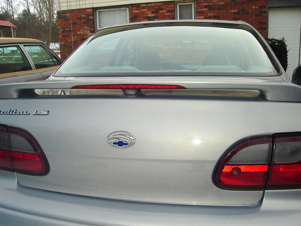

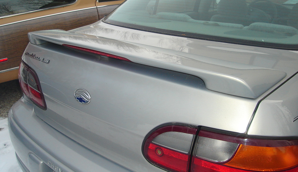

These pictures are from a 2000 Chevy Malibu.
I am not sure how this spoiler would work on a Corvair.

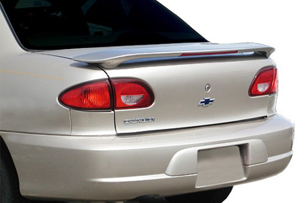

This is an older Cavalier one.......doesn't look too bad.
