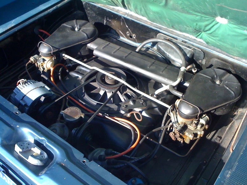

Do you have all of the engine lid and and side cover seals? Are they still soft? Do you screw down the rear lid and side covers? Do you have insulation on the under side of the engine lid?
If all of these are in place and in good shape you should see a big drop in noise.
I installed new door seals all the way around as well as new vent window rubber and and my windows seal very well. With the windows up in the cold weather it is still nice and not loud.

I think that the cars had a rubber mat when new maybe the 62 Monzas had carpet I am not sure.Thanks for the pics. I don't have the carpet & pad that go over the motor, It has the insulation pad underneath. Is the carpet factory or is it something you put in yourself? I just put my own carpet piece down that has a rubber mat attached underneath it, it made it a little more quite but could stand to be better.. Thanks again...
The carpet is from one of the vendors probably Clark's it goes all the way down behind the rear seat. I am sure it helps but the seals on all of the covers and having every thing screwed down helps more!
How are your seals? Do you have all of the screws installed?

Re: Sound proof a Lakewood wagon
If you mean under the Lip of the lid then mine are gone. I thought that it maybe shouldve had a rubber seal around it but it looked like one was never there. I've just not seen enough wagons to know just what is on them.
You can see it in the top picture it runs all the way around the engine cover. It will make a HUGE difference in how much sound gets threw, the same thing goes for the Side covers. The seal material and glue is not bad from Clark's. I will take a picture of one of the side covers for you and post it .
With all the seals and every thing pulled down tight it will be a new car!!
