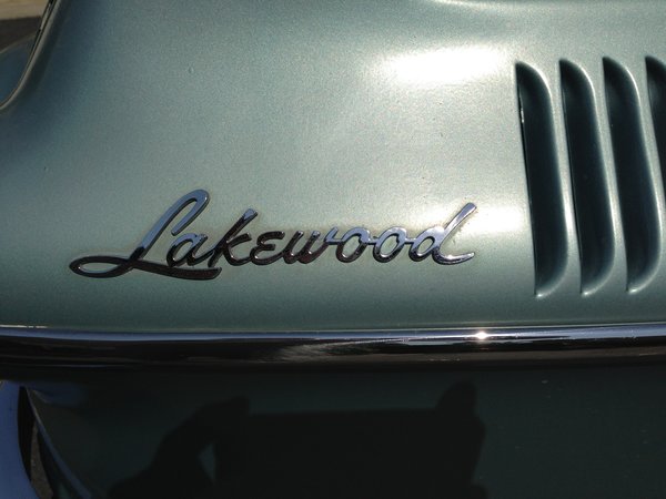

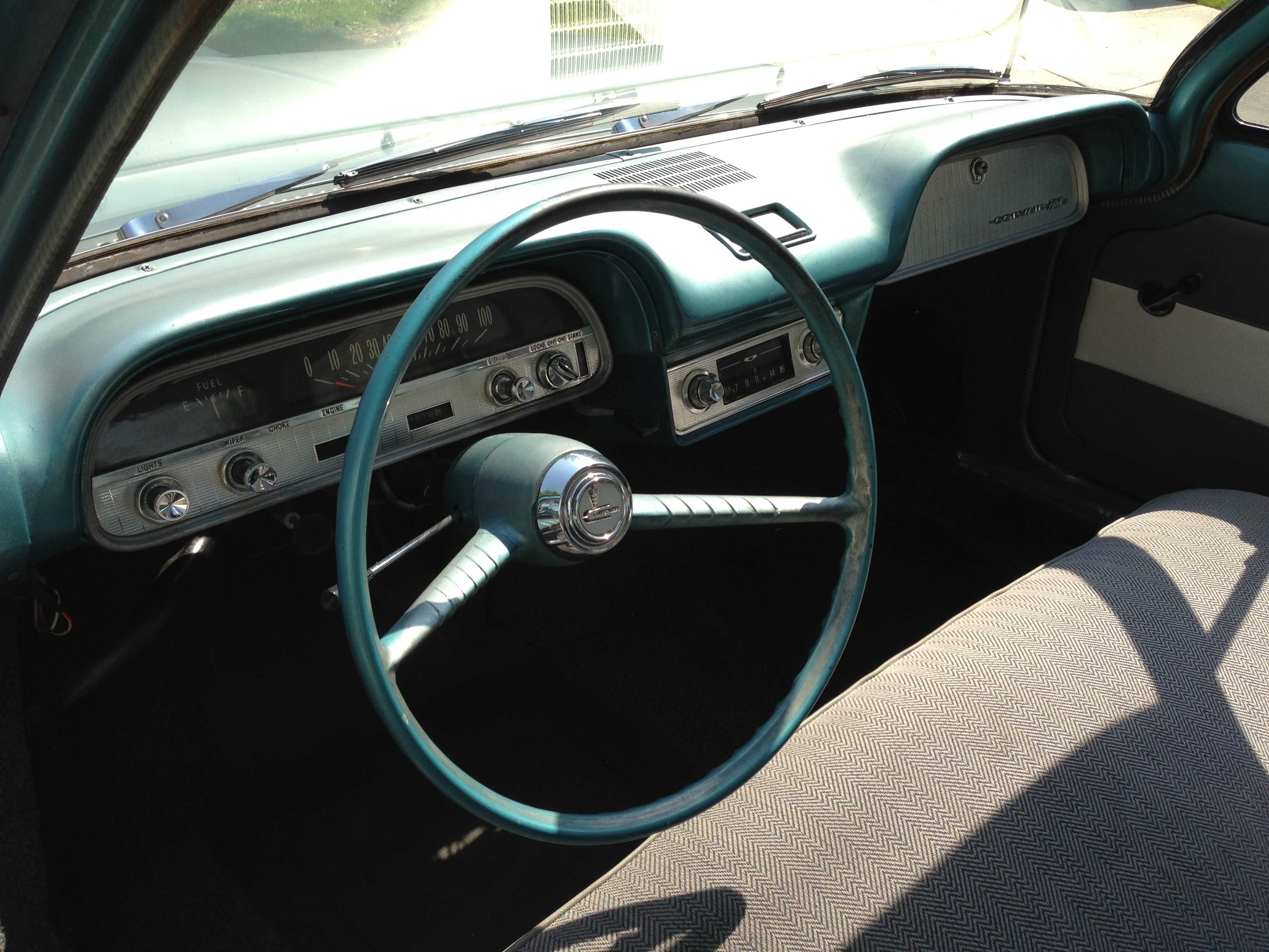

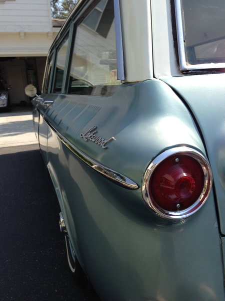

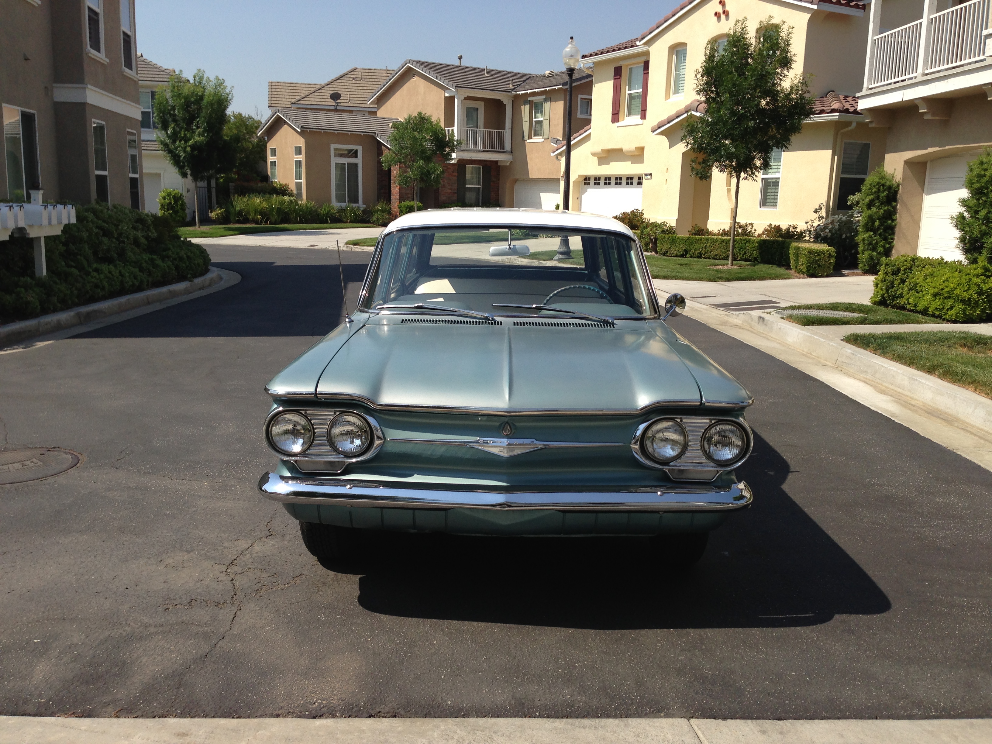

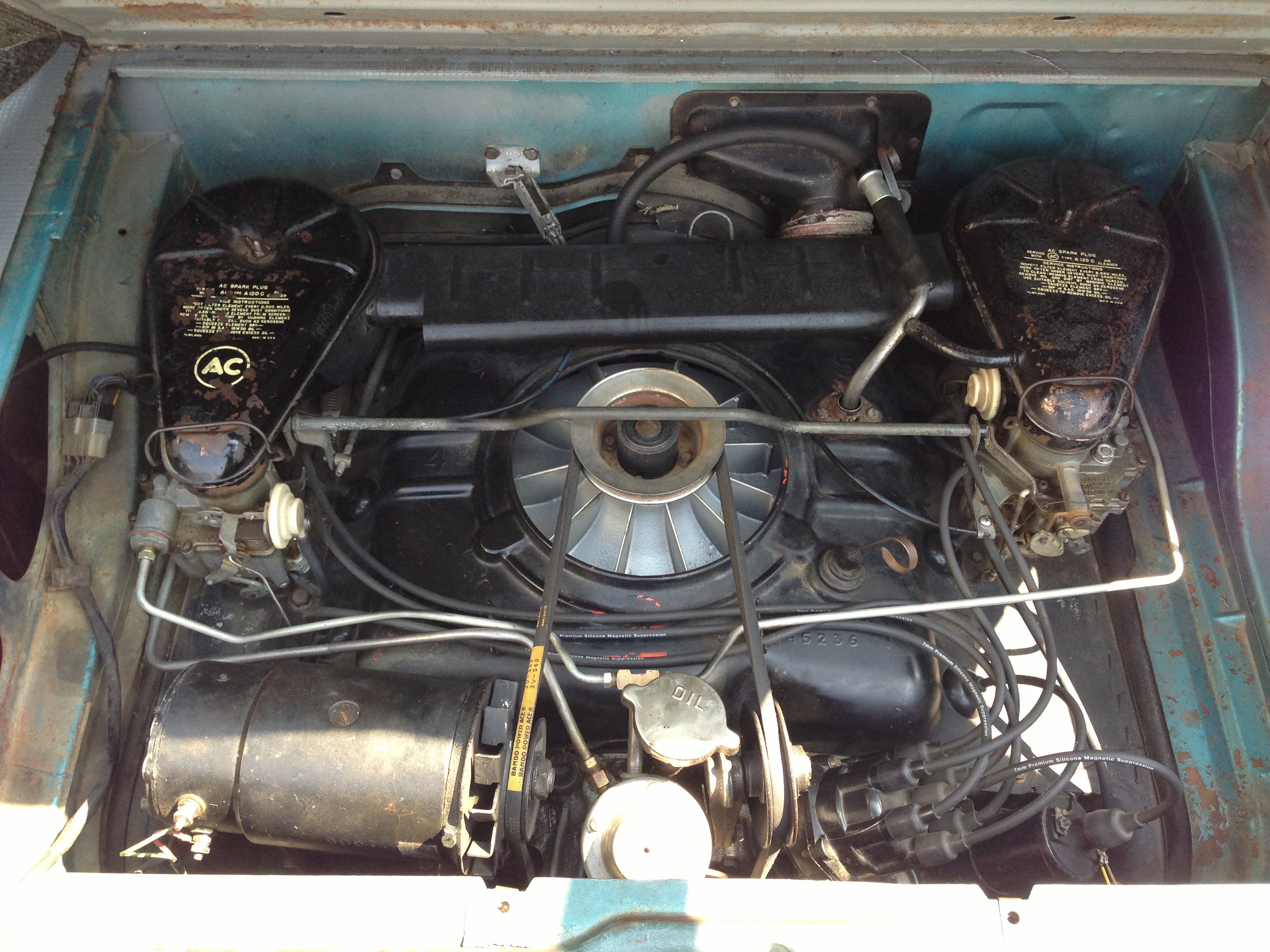

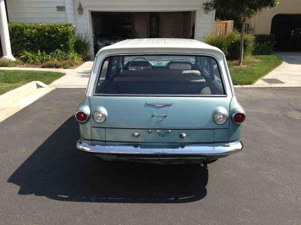

First time classic car and Corvair owner. I am 27 with a one year old and expecting another child in November, so I have been struggling for the past two weeks to post this introduction. I do not have any experience with cars older than 2000, so yes I will have those annoying I don't understand anything questions, just an advance warning. I have always loved the look of early model Corvairs, sorry LM guys, I like late models too just no desire to own one yet. Cruising around Craigslist I found this 1961 Corvair Lakewood 700 in Hesperia. Never seen a station wagon Corvair, never knew they made one. Saw the bench seats and the two tone paint and jumped on it. Drove out the next day and was on my way home with a new car. Actually made the two hour trip back to Santa Clarita on its own power.
I was so excited I took it out to a small car show that weekend and came home with the best sedan award. Running on a high from the car show I decided to enter the car in a larger show of about 100 cars. I knew I was not going to win anything but I had a little hope. So I spent two day and $100 in supplies and a new buffer and polished every piece of trim I could remove and every spot of exposed paint. The car looked so good I had to see it in the sunlight. I grabbed the keys jumped in and started the car. To my horror the engine did not purr like the kitten nor growl like a tiger. It rattled like a 60 gallon metal drum rolling down a hill with a large rock in it. I think it threw a rod, that may not be the right terminology just show s you how green I am, but I think you get the idea. So goodbye summer car shows and cruise nights, hello my first restoration job.
I did plan on restoring the car just not this soon. I originally wanted to keep the car as original as possible, proper grammar here I don't think so, but the 80hp engine has already been replaced with a 110hp. I know thats an upgrade but thats not what I was going for. So plans change screw it lets make this car mine. Hello Judson supercharger if I can get it to fit. Well I actually go to see the supercharger tomorrow, but thats another story. The car appears to be in great shape but looks are deceiving. As I was cleaning out the car I removed the 100lb bag of cement out of the trunk and found a nice patch of rust. Hmm, I wonder if that bag of cement was there for better control while driving or to cover the rust from prospective buyers. Other than a couple spots of rust it looks pretty straight.
I plan on removing all the trim and interior myself, if possible, then sending the car to the body shop and to have the engine completely restored and tuned up. Hopefully I acquire the Judson Supercharger tomorrow and can add that to the car. Lakewood with a Judson sounds like it will look pretty cool. I know the Lakewoods were never offered with an a/c but living in so cal that was my wife's first complaint. I do plan on shipping the car to Maui when I retire so I may add an a/c system to the car. I know the a/c and supercharger will probably work against each other but thats why I have you guys, to set me straight. Let the opinions, suggestions, and advies come rolling in. As I said I am a Noob. I want to paint the car to its original colors so I will post the fisher tag in the vin section and hopefully someone can decode it for me. I also want to know what year engine I have in the car. I know it can be difficult to tell without breaking down the engine, but hopefully someone can tell. Well here are a couple pics of the car. Please enjoy ...

As far as your engine trouble goes it sounds like the lifters leaked out the oil and collapsed. It's common in these horizontal motors. It doesn't happen all the time but its common enough. Usually happens to a new owner.
Welcome to the wonderful quirky world of Corvair ownership.
These cars are amazing and we all dig them. Go start it up again and let it warm up. I bet it quiets back down.
