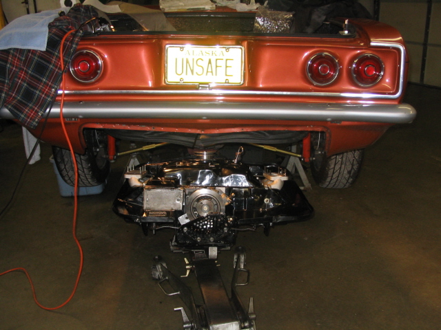

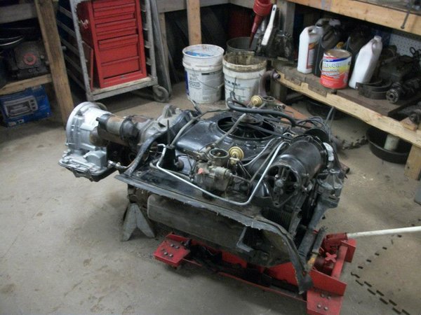

METHODS MY BROTHER & I HAVE USED TO REMOVE THE POWERTRAIN - The hardest one was the grocery cart frame- we had to lower the car putting the powertrain on the frame before finishing unbolting it - then jacked the car back up leaving the powertrain on the cart.
USING AN OLD GROCERY CART FRAME
USING A FLOOR JACK AND JACK STAND - WAS BALANCED BY HAND WHEN REMOVING
USING A FLOOR JACK WITH A HOMEMADE CRADLE FOR POWER TRAIN - ONE MAN OPERATION
IN THE 1970's MY NEIGHBOR HAD A TRANSMISSION JACK - That worked super - one man operation, I also borowed one from a friend in 2007.
THE STEPS FOR DISCONNECTING THE POWERTRAIN AND RE- INSTALLING ARE MUCH THE SAME AS Brad STATED.

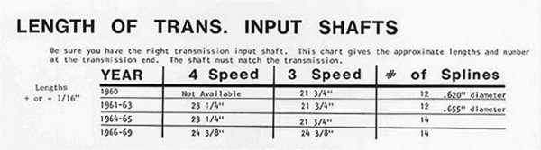

It is little more difficult to separate the transaxle from the engine. Invariably the 24" splined input shaft stays embedded in the clutch and begins to pull free from the transmission. This would mean that you need to pull the heavy transaxle STRAIGHT BACK 2 FEET before the other end of the input shaft clears the throwout bearing shaft that protrudes from the differential. If it slips or falls it could damage the input shaft, clutch disc or throwout bearing shaft. I have done this alone, but it is difficult. It is best to do the whole thing with a couple of strong friends to provide assistance if you need it. This is the best way for safety and to avoid personal injury or damage to your Corvair.
When separating the transaxle from the engine, I would recommend the following procedure: With the engine resting on two stacks of wood or some similar support, the jack is now free. Place it under the differential and raise it just enough to support the transaxle weight. Remove the bolts that hold the clutch housing to the differential. Assuming you have a couple of helpers, have one person on either side of the transaxle, and a third person will control the jack. The people on either side of the differential will steady the transaxle (weight: about 150 lbs). The person manning the jack slowly pulls the transaxle straight back while the two helpers keep it straight and aligned with the engine. As the differential moves away from the clutch housing, your helpers can look inside to see if the input shaft is staying engaged with the clutch and engine. If it is, one person can reach inside and pull the input shaft toward the transaxle to release it from the clutch disc and clutch assembly. Doing so will eliminate the possibility of the long input shaft from applying pressure to the side of the throwout bearing shaft, which can crack or break that piece that protrudes from the differential. These throwout bearing shafts, which the throwout bearing slides back and forth on , are a cast component that is machined smooth. Because it is a thin casting, applying lateral pressure on it from the input shaft, or possibly even a screwdriver when attempting to pry the input shaft seal and ring out, can potentially crack or break a section of the casting out. If that happens, the throwout bearing shaft must be removed from the differential and replaced. This is not an easy procedure, because it must be removed from the inside of the differential, which means that the differential would have to be disassembled. This is something you want to avoid, so treat the differential throwout bearing shaft gently!

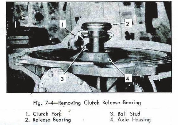

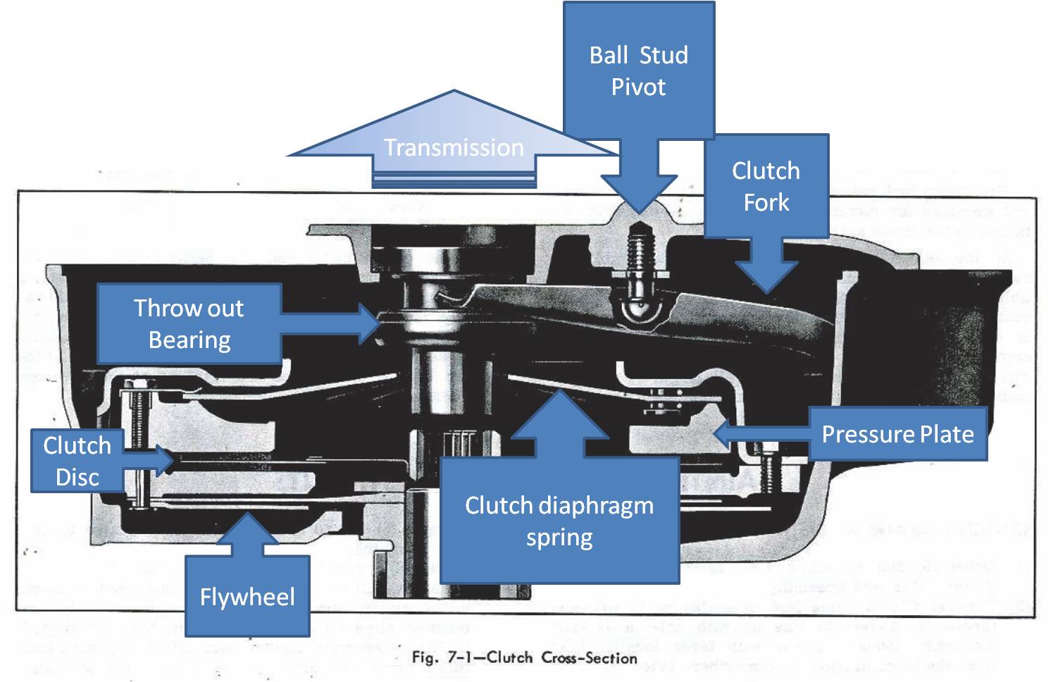

The pictures below will help you to visualize the components that are inside the clutch housing...

This whole process involves a fair amount of time and work. Your clutch assembly is old enough that it has developed a loose flywheel. That means wear is a possibility on the entire clutch assembly. It is entirely possible that you may discover other worn parts when you have it all apart. What you don't want to do is ignore worn components and reassemble a worn-out clutch after only replacing a bad flywheel. If the clutch disk surfaces are worn out, replace the clutch disc. If the pressure plate surface appears damaged, you may have to replace it. Be prepared to have to replace worn oil seals or a throwout bearing if it feels rough. Certainly any worn-out parts cost money, but reassembling your clutch using worn-out parts is a waste of time.
The factory shop manual describes how to examine each component to ensure that it is still serviceable. If you find a small pool of oil collected on the bottom of the clutch housing, you need to determine where the oil came from. If it is engine oil, you may have to replace the seal and gasket in the clutch housing. If it is the heavier 90 wt. oil from the transaxle, you need to examine the throwout bearing shaft for cracks or missing pieces. Hopefully the throwout bearing shaft is fully intact and you would only have to install a new oil seal. If the oil leak was significant, you may find tht the clutch disc friction surface is soaked with oil and may need to be replaced.
When you reassemble your transaxle and mate it back to the engine, you want everything that is inside of the clutch housing to be in 100% first-class operating condition, with no oil leaks, so you don't need to do this job again anytime soon!
