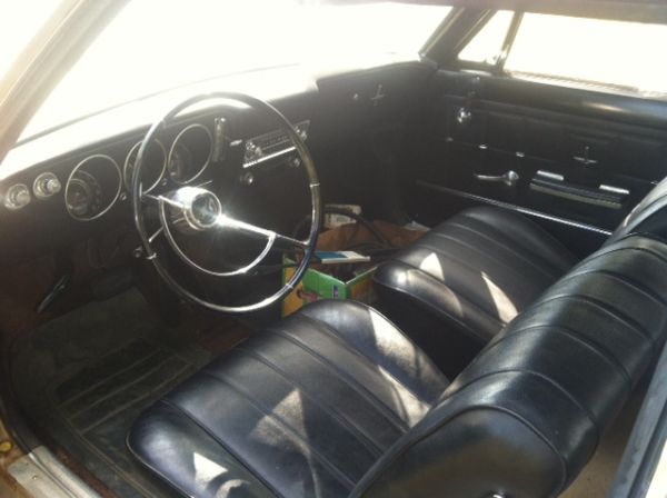

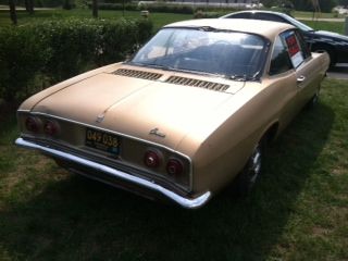

I'm thinking of buying my first Corvair and found one pretty cheap with some slight rust. The worst cancer areas are the front and rear windshield frames and the floorboards. The rockers have some surface rust but no holes, and the front fenders both have small holes behind the wheel. My question is if the areas have readily available parts for replacement if necessary, and are there other hidden areas I should be looking at? The good thing is the vehicle has original paint with no bodywork ever done, and the door gaps are pretty good. I attached some pictures. Any expertise would be greatly appreciated!

I appreciate all the input and looking for a little more. Let me explain myself and the car a little further. I was a Toyota tech through school, and now a mechanical engineer at an engine technology company. I'm experienced with all facets of engine design and control systems, and pretty decent with racecar suspension theory. I've painted a car and a motorcycle in the past, but they didn't require much rust repair, just fender replacements and some body filler touch-up. I'm a decent fabricator... can hold my own with a MIG welder and a can run a Bridgeport (hopefully getting one for the home soon).
I'm now living in Michigan, and this state ridiculously saturates the roads with salt in the winter time so rust is common. Sorry the pics aren't better, but I just reposted them from the original advertisement. The owner claim's 35K original miles and that's what the speedo shows... whether it's true I don't know. I can confirm the paint is original and no bodywork has ever been done. My main concern is repairing the windshield framing and if the rockers are rotted from the inside out. The rockers still seem structural, but replacement could very well be necessary, and I've heard that replacement of the rockers can be one major headache due to the low torsional strength of the unibody construction, but I'm also thinking this may only apply to convertible models. Also, the driver's floorboard is rotted thru, the rear floorboards look solid. I'm not sure where to look for replacement sheet metal for these areas either, and may end up having a body shop do some of the work.
The overall mechanical condition is fair. The engine fires right up and idles well... the valve covers leak like a sieve. The vehicle can be driven home, granted it's only a ten minute drive.
I'm not sure of my intent for the vehicle yet... could go the restoration route or do something with a Porsche transaxle and vette suspension. I think I can get the guy down to $1300... what do you think?

It sounds like you have a lot of mechanical and technical background to help you. All Corvairs are subject to chassis strength and body rot problems, but those issues may be more noticeable in convertibles. Your description indicates signs of a lot of exposure to salt damage an body decay. Is this a mechanical parts car or a car worth restoring? How much time and money are you willing to invest in rust and decay repair? Have you examined the suspension components for rust and decay? A weakened front cross member sub-frame can be an issue. Fuel tank rust and decay can be a problem.
Valve cover leaks are usually easy to fix, and new gasket and o-ring materials, such as Viton, makes these leaks less-common. Since it is easy to fix, it seems strange that the owner has not taken care of such an obvious issue already. Neglect? Are there any missing, stripped, or broken valve cover bolts that would complicate the repair an make it more than a simple tightening or new gasket issue?
If you are not completely certain about bodywork and repair, and capable of fully diagnosing and analyzing the full condition of this Corvair body and accurately estimating the extent of needed repairs or methods needed to do those repairs (or the costs and time involved) it seems that it would be easy to get in "over your head".
The car has an automatic Powerglide 2-speed transmission. Is this what you want, or do you want a car with a manual transmission? Did you check the transmission fluid on the dipstick? Discolored transmission fluid or a burned smell of the transmission fluid can indicate transmission problems or a worn transmission.
Overall, the price does not seem excessive, but the cost of restoring a rotted body could be excessive. The value of the car, even as a parts car, is uncertain. I tend to be inclined to be willing to pay more for a clean car up-front, and would shy away from a northern-USA vehicle that is already displaying a lot of body rot. Realistically, do you want to restore such a car, or would you be happier looking elsewhere?

Sure looks like that passenger door has been painted to me.
Re: '66 Corvair Coupe - treatable rust?
no disrespect to bbodie, i also live in Michigan and bought a Michigan car, yes there's rust but if that car really has original paint and is only 35,000miles rust would be the last thing i would worry about, if you can't poke holes in it its fine, these cars are some of the most solid unibodied cars. bring a magnet and drag it along the bottoms of the front fenders and rockers, but like i said if is 35,000 miles and looks like it i wouldn't worry about structural so much, the windsheild, you would have to pull the trim off to get a decent idea of whats there, but if all you have is winsheild frame to repair, i would imagine a decent body shop could handle it, you would have to get an estimate, i don't know how much it would be

vair coupes have very good torsional strength if the monocoque structure hasnt been compromised by rust or collision damage. verts have a added z-panel in the rockers for more stiffness but verts are kind of flexy.claytco wrote:My main concern is repairing the windshield framing and if the rockers are rotted from the inside out. The rockers still seem structural, but replacement could very well be necessary, and I've heard that replacement of the rockers can be one major headache due to the low torsional strength of the unibody construction, but I'm also thinking this may only apply to convertible models. Also, the driver's floorboard is rotted thru, the rear floorboards look solid. I'm not sure where to look for replacement sheet metal for these areas either
replacement rockers, floor pans, etc., are available from clarks corvair parts. http://www.corvair.com/user-cgi/catalog ... N&page=193
the windshield/dash area repair is somewhat difficult as there are a number of different panels that join together in that area.
