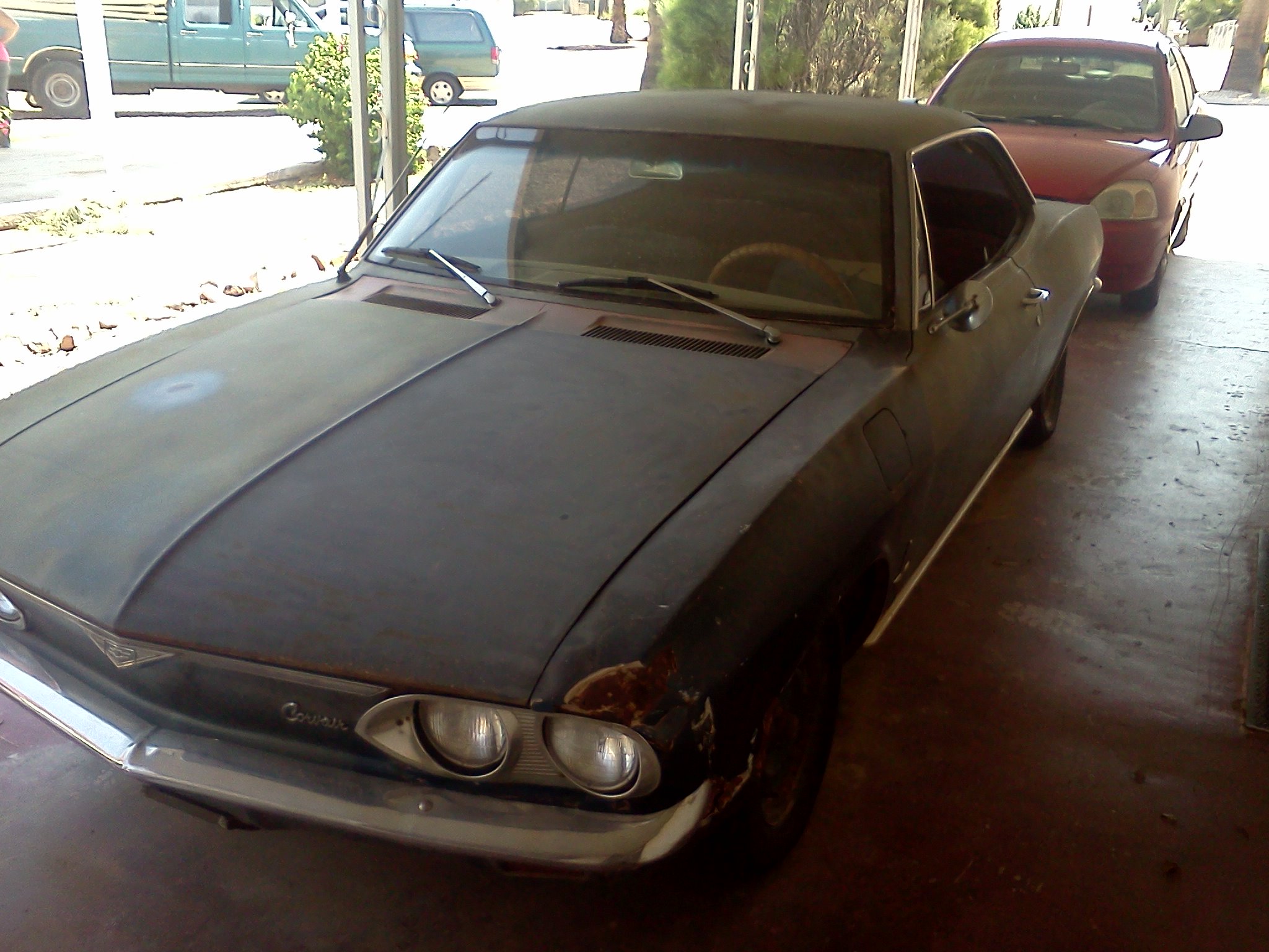

anyway, here are some pictures iv taken.
i know she aint too pretty but she has potential.
i am replacing the spark plugs, changing the oil and getting the owners manual (didnt come with the car) soon.
i think the fuel pump may be the next thing to check, a car savvy friend of mine came in and looked real quick and said it looked like the carbs were not getting any fuel.
i am short on tools (basic socket set, jack, jack stands, and elbow grease) but am more then willing to buy them because i want to be able to work on this car without having to go to a shop latter on. but i could probably only afford hand tools and not the big air sets or anything like that.

I would not bother converting to single carb. The duals work just fine. The cars have been working for the last 40-50+ years with them. You'll need a uni-syn tool to sync them but its easy and kinda fun to do.
Basic things a car needs to run is spark, and fuel. Well it needs to be able to stop too lol. Start there. Carb rebuild kits are cheap and readily available, so is the tune up kits, plugs, wires, points, condenser, cap rotor. All are easy to do too. If you have ANY questions, please ask. There are allot of very helpful knowledgeable people here that will be glad to help. That was the first thing I discovered when I got my first Corvair. The people who own them are some of the nicest and most helpful I have come across. (as you can see already) Dive in and keep us posted on what you are doing.
