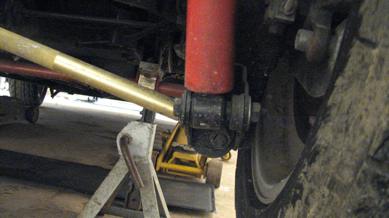

I had to move my lower shock mount too but not as much as Tony. If I made my brackets again I would rotate them up a bit and then the shock could stay in original position. Not a big deal either way.
Here's a pic of mine. I cut off one side of the shock bushing and shimmed it inboard in the mount bracket. There is even more clearance when the car is on the ground.
