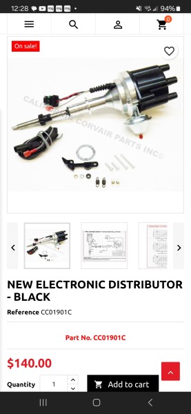

I seem to be having a similar issue. Replaced points, condenser, cap and rotor, but still having a hell of a time. Timing seems close, but vacuum advance keeps getting stuck and when that happens engine chugs and wants to die. But when it's idling lots of misfiring and carburetor backfire when given throttle. It was better before I changed the points, I ordered another set to see if that helps. Pretty sure this thing has more issues than I can count but my question is about the electronic ignition distributor from CAcorvairs. Says it's pretty much plug and play. What are y'all's thoughts? It's a great price right now, or is it a get what you pay for scenario? I'm not trying to build a racecar, just want a running daily driver

I have a "Stinger" distributor from Perfvair. The one you referenced looks very similar, if not the same one. It states that all the electronics are self-contained in the cap, which makes it very easy to install. At that price, that is a great deal. Just make sure you ask the vendor what coil to use. Mine must use a 3-ohm coil so it won't burn out. Anything less than 3 ohms will cause issues with over voltage.
Depending upon the cap type you may have to buy news spark plug wires so ask the vendor what it comes with and what wires to use.
I like mine. It works great; it is a brand-new distributor too so once it is in you will never need to replace the distributor again.
