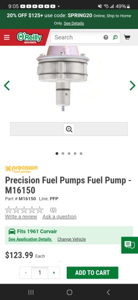

Fuel pump from O'Reilly's?
Got the 61 running in a decent manner until the fuel pump went and flooded my crank case and spewed fuel and oil everywhere!!!! Now time to change the oil and replace the fuel pump. Looks like Clark's no longer has any manual pump options. Amazon has a couple with very poor reviews. Has anyone tried the option from O'Reilly's? Should I just get the electric kit from Clark's? I appreciate any of y'all's thoughts.

I used to buy fuel pumps from O'Reillys and replace the spring with one form an original AC because the new one put out too much pressure.
That was probably more than 6 years ago and I quit doing it when they went from $42 to $92.
I've been mainly switching to electric fuel pumps for the last 6 years or more.
I've never had a Clarks EFP kit so I can't say how it is. It may have the Made in China Airtex electric fuel pump. I've never tried one of those either.

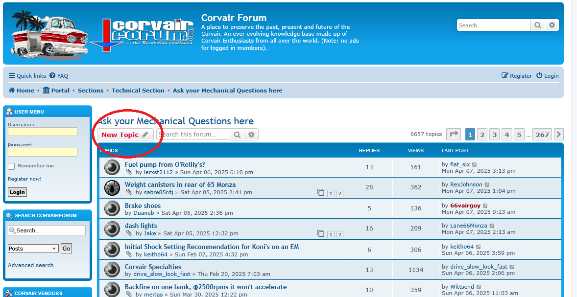

Re: Fuel pump from O'Reilly's?
Sorry to hijack this post, but can someone please IM and tell me how I can start a new topic (fuel pump related)?
I see no option to do this while logged in. Frustrating!
Mike D

Go to the Forum Section you want to post to, for example, "Ask your Mechanical Questions here" Click on the New Topic button.
Thank you. I am easily confused between the terms "forum" and "section".
