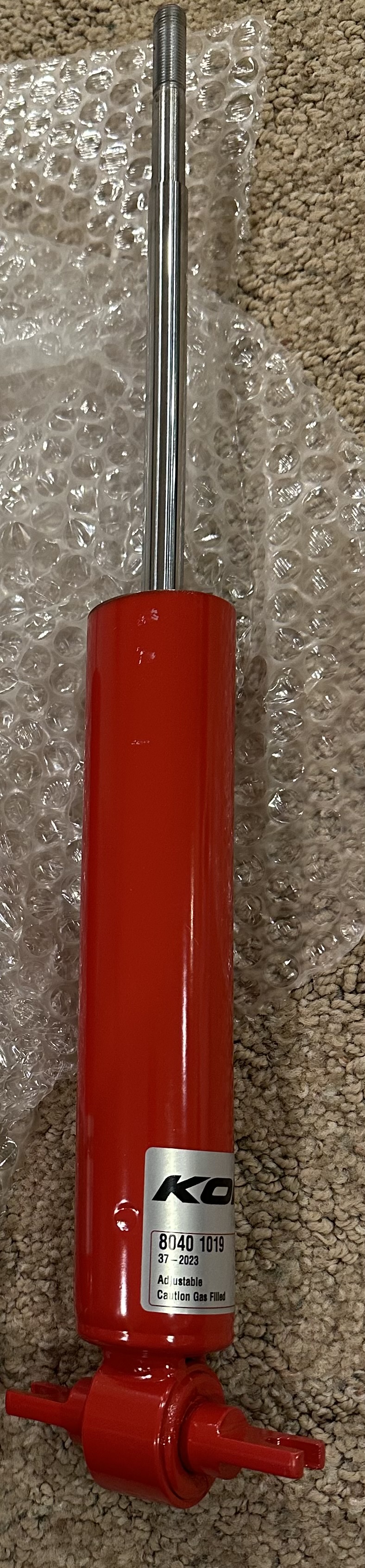

Good afternoon,
I purchased the Koni shocks from Clark’s for my 64.
From the instructions:
Full counterclockwise if full soft
Full clockwise is full firm
The instructions state there is 2 1/4 turns for adjustment
I am looking for more handling vs comfort. I figured I would start at the middle of the road setting but would love to hear what others running Koni's use for their settings.
For those of you who have an EM with Koni’s, where would you suggest is a good place to start with the shock settings on the front and rear?
Pictures, just because :-)
