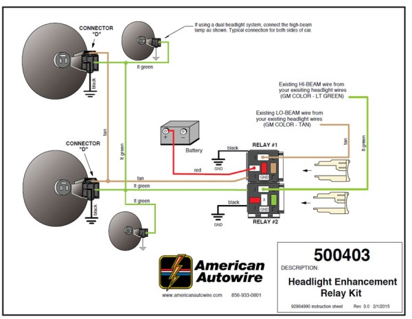

If not, pull light from cup and jumper a wires to the battery and ground to see if beam increases intensity. If not, get a replacement . Use this diagram for use of each terminal Confirm your car is wired this way. If not, use your car's wiring as a guide. This is a generic diagram by AAW.
