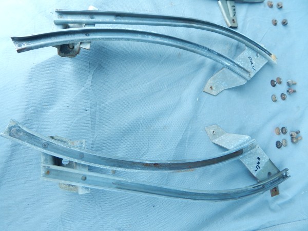

Not sure what others will say, but getting at the rear quarter window mechanism is NOT easy in my opinion.
I like to pull out the glass, guides, etc. and clean, fix, lube things. It is NO fun, and takes time and patience. However it IS doable.
Out comes the back seat, remove the arm rests, I recall a galvanized panel.
Unlike the front side doors with the "fuzzy" channel guides the convertible (like coupe side rear quarter, or 4 door rear door windows) the glass has rollers on it (that can wear out) that move in metal channels. Even when well adjusted there will be some play! I could not find my pictures of the glass, but here is a picture of the roller guide channels. There is also the window winder mechanism that I remove and clean and lube. I recall the glass and guides MUST come out before the window winder. BTW I had NO "fuzzy" window strips in the fender window openings that made removing parts easier.
Once I got repaired, lubed, adjusted, then the window when up and down with little effort!
I hope this helps - regards.

Thank you! It looks like maybe the rollers just wear out, and that might be my problem. It's not a pressing thing, and it might also be one of those times where I just let it ride: It's not anywhere near air or water tight, so I try not to get caught in the rain!

The rollers are known to break also. But if it does roll up and down, then they are not broken, as broken usually means the glass goes in an odd direction.

Re: Loose Quarter Windows on '65 Convertible
Agree - The rollers will last a long time IF they are lubed. Problem is getting them lubed. White lithium grease was the norm back then for window mechanisms, door latches, door hinges, and seat tracks because it did not "smell". Also some say it the color did not stain clothing. White lithium grease dries out and then it acts like "cement". The careful application of WD-40 sometimes softens up the grease. Don't use penetrating oil like PB-Blaster as the smell will foul the interior for weeks.Frank DuVal wrote: ↑Sun Sep 15, 2024 10:00 am The rollers are known to break also. But if it does roll up and down, then they are not broken, as broken usually means the glass goes in an odd direction.
