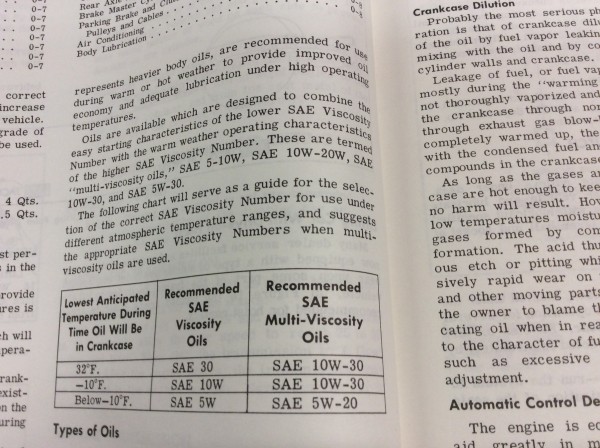

Absolutely!! in one of my shop manuals, it recommended straight sae 20 when the outdoor air temperatures werent going to exceed 60 degrees. I think it also had a sae 10 recommendation but dont remember what the air temperature was. That was kind of the old way of handling the cold viscosity problem in the days before multiviscosity oils were common.

Here is what the shop manual says: :chevy:

Oops! once again it has been demonstrated that my ever increasingly fragile memory is not to be trusted. The last part, under that spec is the interesting one... its not recommended to use SAE 10 above 60 degrees
