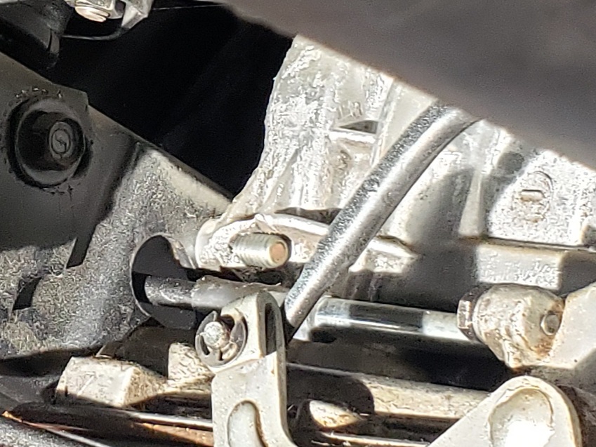

On another issue, if you look at some of my pics, I show what looks to be a cracked housing where the bolt holds the transmission (PG) to the trans mount, (may need to zoom in on a few pics to see). I would have never noticed this until I crawled under the car. It does seam to shake the vehicle a little when idling at stop lights not bad but seams a little rough. The noticeable shake goes away as the rpm's increase (at least it seams that way). Barely noticeable at this time, but it has raised a concern in me. I now see this cracked mount and am wondering if this may be the rattle or light shaking at stop lights issue? I also see I need to replace the strut rod bushings and am wondering if I have worn out that rt rear axle bearing do to the misalignment and twisting of the strut rods? Just an idea, any thoughts would be much appreciated. The left side or drivers side is quiet and spins somewhat freely, even though that inner strut rod bushing is absolutely shot. Pulling wheels, axles, brake drums, etc. and to un-assemble is above my pay grade and knowledge. Just trying to get a rough idea of the issue. I will be putting new wheels and tires on the vehicle along with a 4 wheel alignment, but I believe I will need to address the strut rod bushings and control arm bushing replacement before going for an alignment. The squeaking should also be addressed at this time, I am thinking either wheel or axle bearings. The issue with the compromised transmission mounting bolt hole, please share your ideas and remedies? I have reviewed the portals past write ups on some of the same issues but they were from an older time period and I am hoping some new remedies have surfaced. Thank you all in advance for your vast amount of knowledge, and your time trying to help a fellow Corvair lover. Ok sorry cant upload video so disregard helping on squeaking noise.

That is not a broken transmission mount, it is a chuck of aluminum transmission case missing. Working so far, I am inclined to leave it be for now. Looks really clean under there, did you just wash it?

To all whom responded I thank you. All great direction and idea's. I will have further inspection performed when the rear strut rods are replaced. I am not going to touch that bolt on the transmission. I will still be trying to upload the 20 second video of me turning my rt rear wheel by hand and getting the annoying squeal. Which I can only hear when the car is off and if I am rolling it in neutral. At thigh speeds I cant hear it at all. My phone shoots an MP4 video and I don't think this portal likes it. I will try to get a link to the video set up. I really appreciate everyone's professionalism.
Oh, to answer Frank. The car is in southern California, I had recently purchased from an elderly gentleman's collection whom had all his vehicles stored indoors. I had not washed the underneath.
