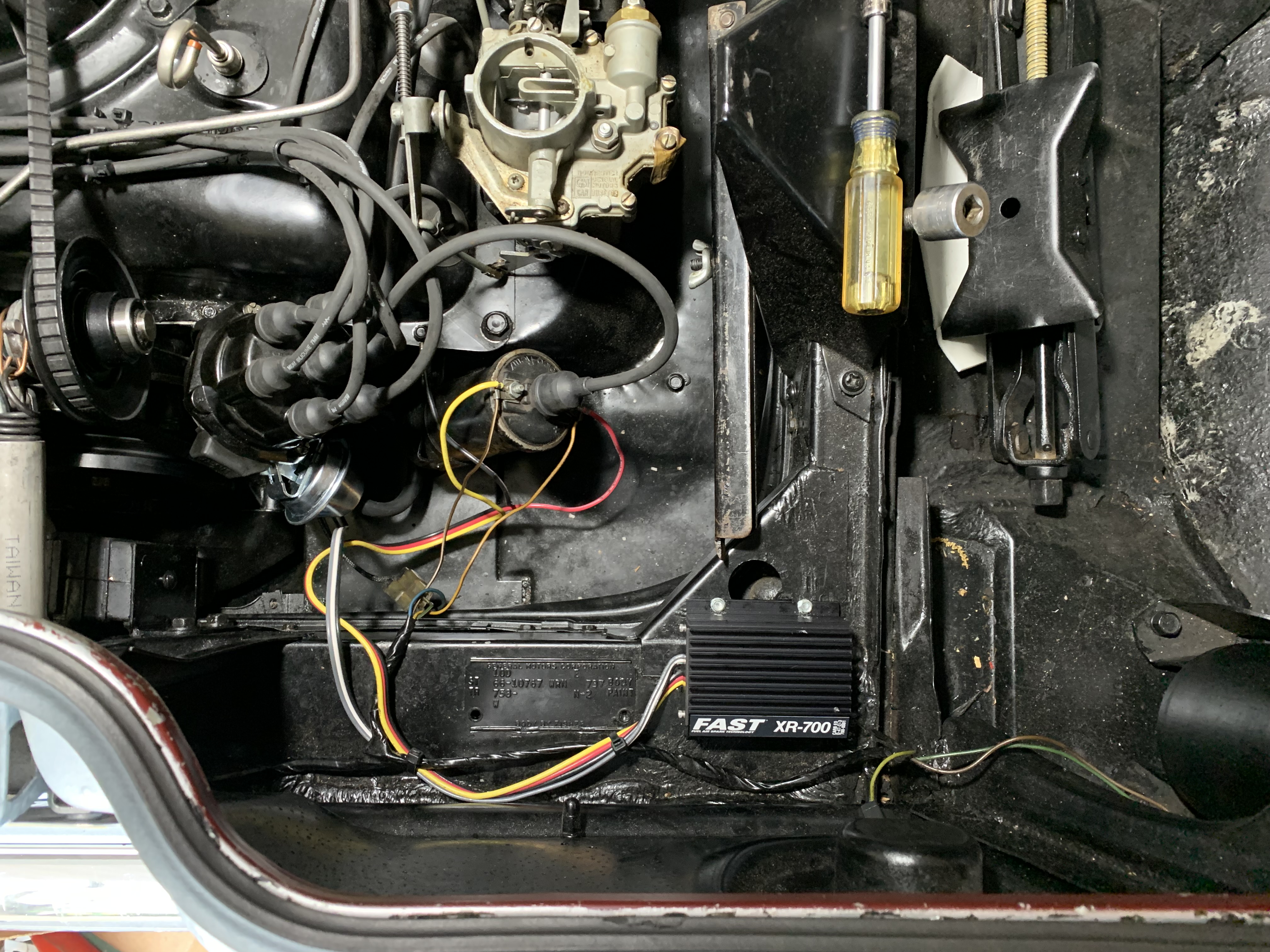

If you don’t mind a separate box I’d recommend the FAST XR700. Highly recommended in the Corvair community and installs and work fine. Also just uses original wiring and coil.
I had an Ignitor I in the SBC of my 55 Chevy, worked fine for 10 years, about 9K miles then got intermittent for a few hundred miles and quit. I had an Ignitor (don’t know if it was I or II) in a 79 MGB that worked fine during the 4 1/2 years I owned the car.
Attaching a photo of XR700 external box.

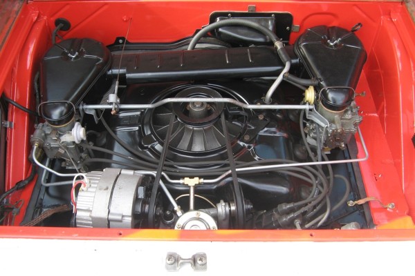

Greenbrier engine compartment after gone through. It looks and functions better now.

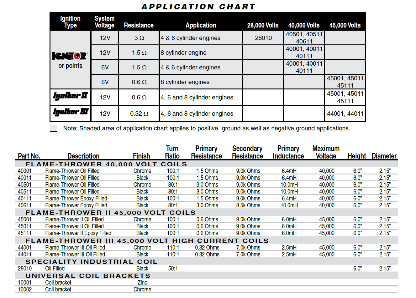

So the flamethrower coil and the stock Impala coil run the same price. Are you saying don't get the flamethrower?

Is flamethrower 1 coil same as original specs or not?

Gasman63 wrote: Wed Dec 20, 2023 9:52 am Is flamethrower 1 coil same as original specs or not?
First - Petronix says to use a six cylinder coil 40501, 40511 with a 3.0 ohm primary resistance that is INCORRECT as the Corvair used the same ballast as the Chevy V8's. Yes Brad insists it can work IF you remove the ballast, put that destroys the GM design and I have no idea why he insists on pushing his argument.
Second - The Corvair used a number of different Delco coils for different engine HP. The best is mentioned in the following.
The Flamethrower 1 #40001, 40011, 40111 (1.5 ohm for V8's) is not exactly the same as the original Corvair coil specification. The sad fact no coil is. So we use what works the best at this time. Understanding the dynamics of an ignition coil function is amazingly complicated. You can go online and spend hours reading, but unless you want to spend a lot of money upgrading your Corvair ignition, your choice is the basic Impala V8 coil or the Flamethrower I #40001. The typical points, Ignitor I, Fast XR-700 require a coil that goes with the stock Corvair ballast of 1.8 ohms to equal at least 3.0 ohms. GM used about a 1.3 ohm coil and the Flame thrower I is 1.5 ohms. Both are in the "it works range". That is the basics. I've encountered a number of failed Flamethrower coils over the years so I no longer use them.
Bob Helt did a real world test of coils years ago. Doing the math is great, but all designs need to be real world verified and some Corvair folks and Bob Helt built a rig to check how bit a gap a coil would jump using a Corvair ballast and different coils. Granted it was a crude test, but it DID demonstrate the difference in coils available, including the best performing coil - the Delco #200 coil (some GM books call it a #202) used for the 65-66 140HP and turbo engines. It performed better than the Flamethrower 1 coil. Unfortunately the Delco #200 coil is no longer produced, nor is there a reproduction I can find. So the next best thing is the basic 1965 Impala V8 coil. I've used it for years and it works fine right up on all the non-Turbo engines to redline with points, Ignitor, or Fast.

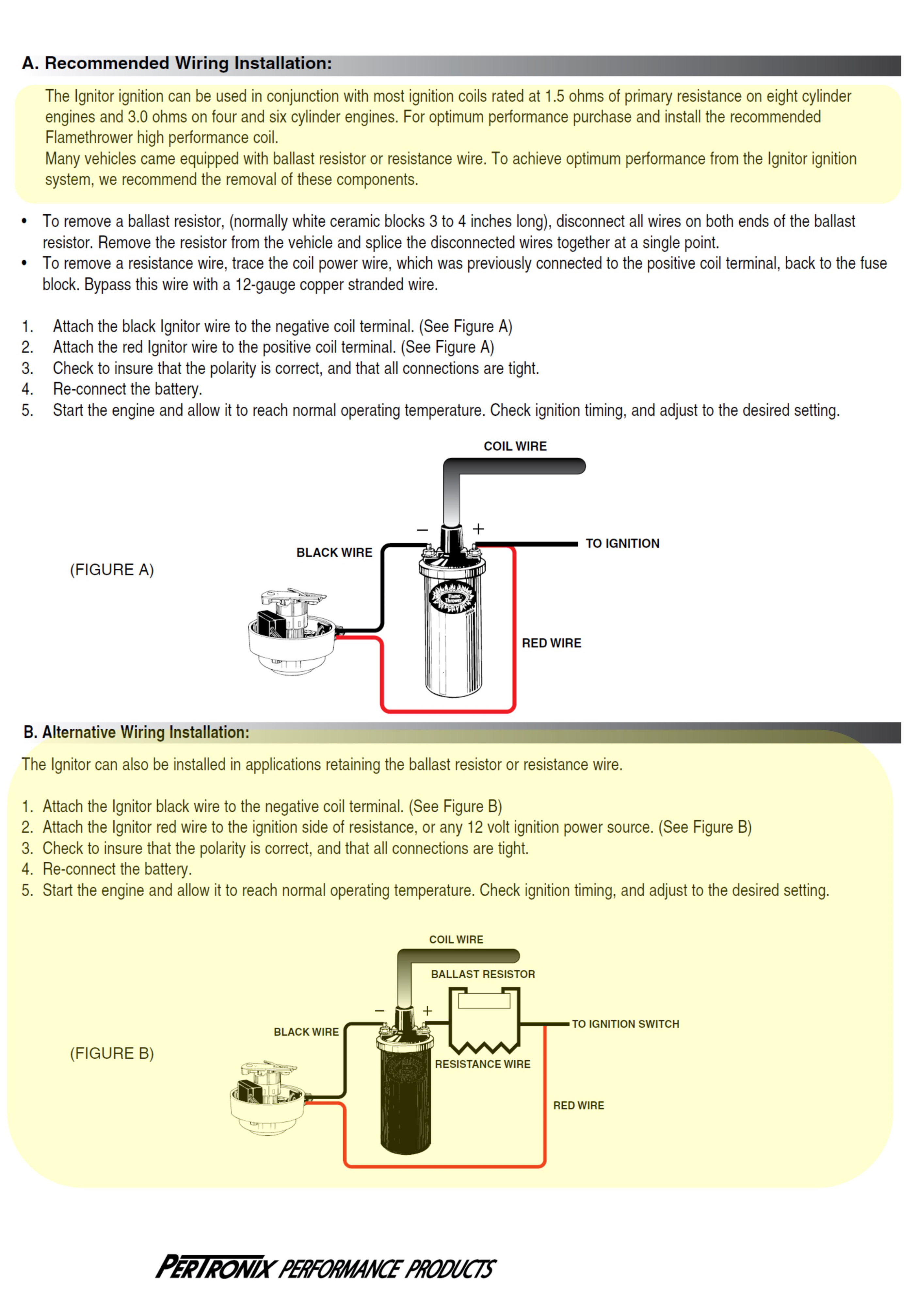

Re: Ignitor or Ignitor II
66vairguy wrote:First - Petronix says to use a six cylinder coil 40501, 40511 with a 3.0 ohm primary resistance that is INCORRECT as the Corvair used the same ballast as the Chevy V8's. Yes Brad insists it can work IF you remove the ballast, put that destroys the GM design and I have no idea why he insists on pushing his argument.
Eliminating the ignition points destroys the vintage GM design — electronic solid-state transistor-switched coil control does that. If you believe that a "breakerless" ignition system, such as a FAST (Fuel Air Spark Technology) or Pertronix system is the right way to go for improved Corvair ignition system reliability, then why do you choose to selectively ignore or disregard the instructions provided by Pertronix? The installation of the FAST or Pertronix electronic control systems necessitates modification of the GM ignition system wiring to match the new electronic components! However, the use of the new electronic switching, sensor-based (optical trigger or magnetic trigger) still retains a portion of the old Corvair design — including the 1.42 ohm ignition coil, the distributor, cap, rotor, and spark plug wires.
Both the FAST and Pertronix systems need a source of voltage to power the electronic module. The most-convenient source for power is the ignition coil positive terminal.
Allison/Crane Cams/FAST knew that the voltage available at the ignition coil positive terminal was not normal vehicle 12-14 VDC power. The vehicle's ballast resistor was designed to drop that voltage down to only about 6-7 VDC. The FAST XR700 electronics took that into consideration, and the designers built the XR700 to operate correctly using only 6-7 VDC as it's power source. In fact, the instructions cautions about removing the ballast resistor from the supply circuit, as this will cause the XR700 to overheat and begin to malfunction if it i powered by a full nominal 12 VDC source! So, with the XR700 module the ballast resistor wire is retained and the Delco 1.42 ohm coil, or an aftermarket 1.5 ohm coil continues to be powered by a nominal 6-7 VDC power source that is reduced by the original ballast resistor wire. The FAST XR700 module was engineered to take that into account.
HOWEVER, the Pertronix Ignitor or Ignitor II modules were designed to run on full 12-14 VDC vehicle power. The voltage that is reduced by the ballast resistor wire is too low. It is at or slightly below the minimum threshold that the Pertronix modules can tolerate. in some cases the Pertronix Ignitor or Ignitor ii may work, and in some cases it may begin to malfunction if the voltage drops so low that the electronic module may malfunction.
The solution that Pertronix decided to adopt was to recommend elimination of the ballast resistor wire from the vehicle ignition circuit. This would provide a full 12-14 VDC power to the Ignitor or Ignitor II when tapping its power from the ignition coil positive terminal.
To keep the ignition coil internal heat down, Pertronix offers two solutions...
1. Power everything without an external ballast resistor, using full 12-14 VDC power. To do this with a six cylinder engine, they recommend switching to a 3.0 ohm coil, which is considered to be optimum for a four or six-cylinder engine and its associated longer coil primary charging cycles related to a coil supporting fewer engine cylinders. (With an original Delco coil, the total primary coil resistance is 1.42 ohms plus 1.8 ohms from the external ballast resistor... 3.22 ohms!) If your installation eliminates the ballast resistor, the Delco coil would run hot, but switching to a Pertronix Flame-Thrower 3.0 ohm coil would bring the coil resistance back down to a nominal 3.0 ohms — keeping the 3.0 ohm Pertronix internal heat buildup under control, while still providing the external Pertronix Ignitor module with the desired nominal 12-14 VDC power for its electronic module!
2. The other way to handle this, if you retain a Delco 1.42 ohm coil, is to wire things up so that the Pertronix ignitor receives power from a bypassed ballast resistor, while the Delco coil gets its power via the original 1.8 ohm ballast resistor wire. This keeps the total coil primary resistance around 3.0 ohms (1.28 ohms to 1.42 ohms (coil) + 1.8 ohms (ballast resistor wire), while tapping before the ballast resistor wire to supply the higher voltage needed by the Pertronix Ignitor module. This is depicted in the final wiring diagram above.
