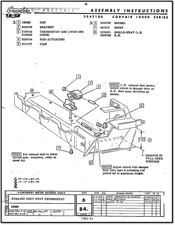

Baffle? Are you talking about the thermostatic bellows itself or something else. Good original bellows units are worth at least $50 each and I have seen them sell fast at $75 each. The lower shrouds are available new from Clark's and I would guess used prices for straight non rusted units to be $20-50 each depending on condition and year model. Early shrouds are different from late shrouds as are the rod lengths.

This illustraton and the attached sections of the 1965 Corvair Assembly Manual and the 1965 Corvair Chassis Shop Manual should help to clear up some of the terminology used to identify the components you are looking for.
LEFT-CLICK THE IMAGE BELOW TO ENLARGE FOR BETTER VIEWING...
The Corvair Ranch may be able to help you in your used parts search. They can probably answer your questions about fitment and parts interchange.
They should be able to meet your needs for used but serviceable Corvair parts.
