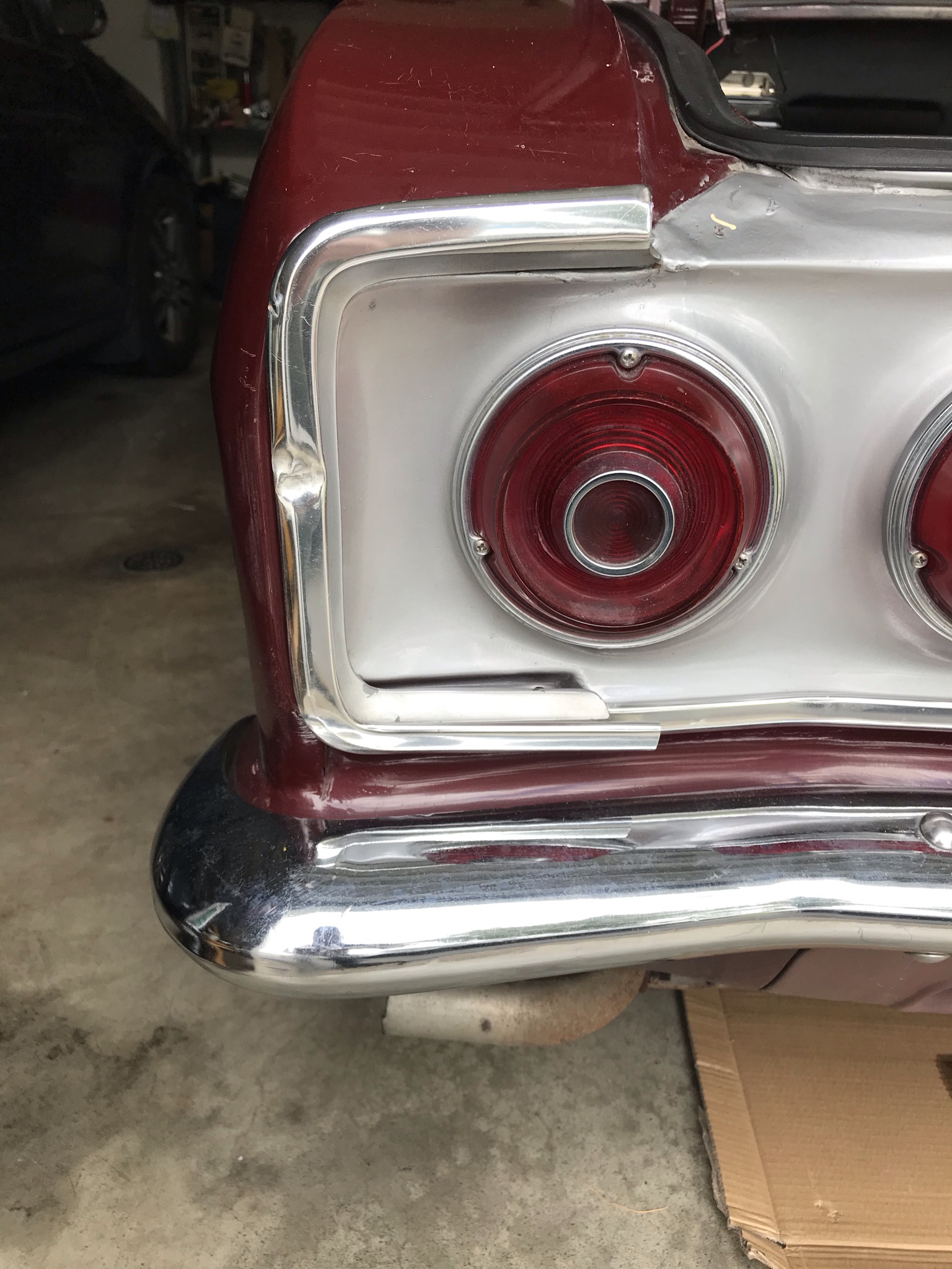

Found a couple of pictures on my phone of some stuff I worked on about a month ago. The rear cove trim is banged up a bit, especially on the driver's corner where the casting is bent and one mount is broken off. I figured it was worth a try to get this one to fit better - I have another cast piece but it needs to be painted, I'll probably do that when I'm ready to repaint the entire cove.
Here is the before picture:
I was able to get it apart and separate the stainless from the casting. Some gentile hits with a small hammer and various dull chisels and the big dent in the stainless came out pretty well. A bit of gentle bending and I was able to get the casting to fit the body better. I drilled a hole where the broken mounting post used to be and tapped it for 8-32 - a piece of all-thread a couple inches long worked pretty well to pull it back to the body better. Didn't polish the stainless yet, but that'll be easy enough to do another time.
The after picture - a little different angle that showed the improvement to the stainless better:
I noticed then that the trim on the deck lid didn't line up very well. I took it off and tried to adjust it a little, but it seemed to want to go back to the same spot - the long plastic nuts hit the body under the weatherstrip and pushed the trim out of alignment. After some online research, it seems that someone had all the trim off the back of the car sometime long ago and managed to swap the clips in the top and bottom long stainless strips. I was able to slide them all out and swap the clips back to the proper stainless - It lines up much better now and doesn't hit the body when the deck lid is closed!
