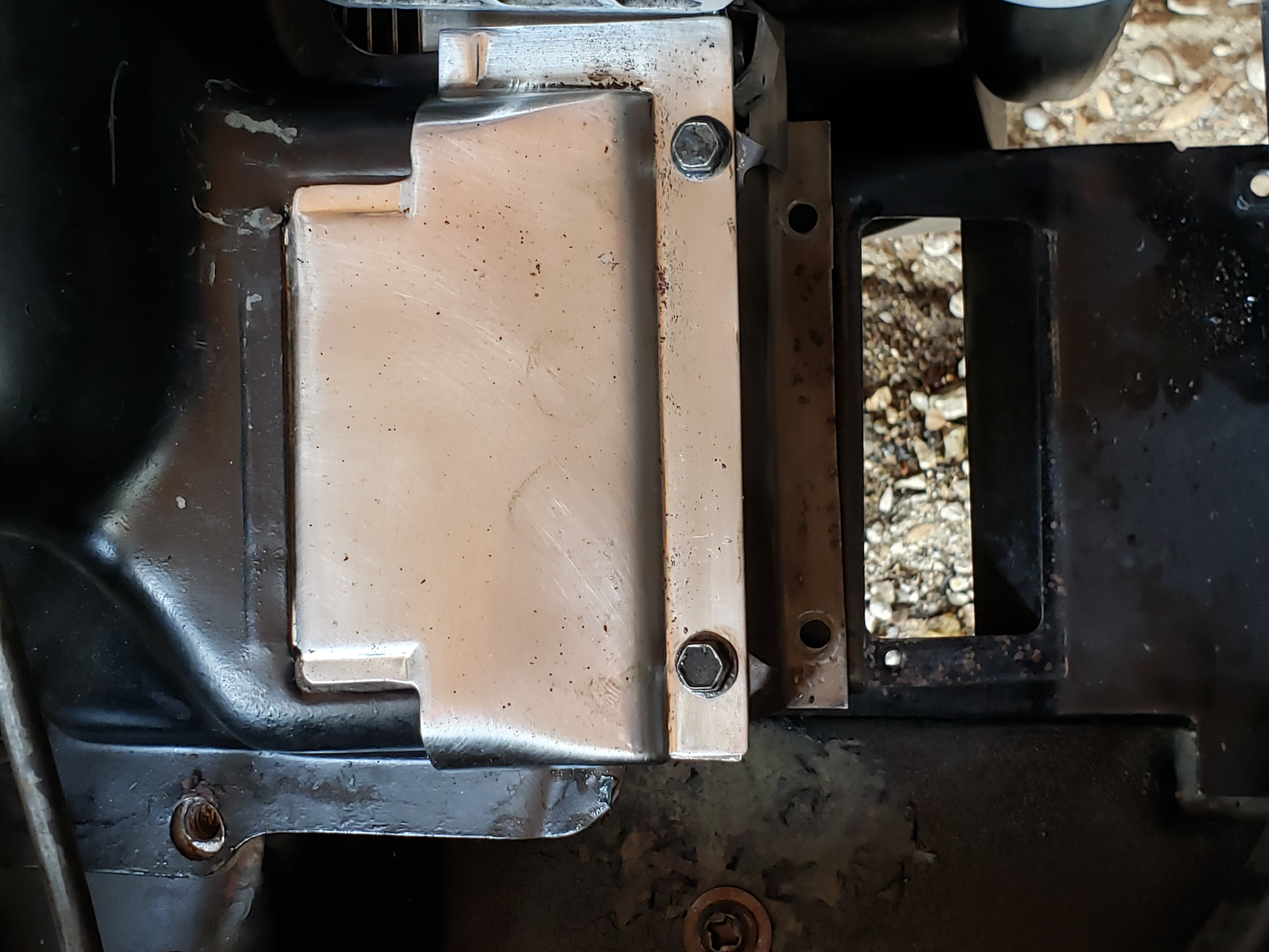

Re: '65 '500' sedan project from the dry Central Valley, CA
FUDGE!!!!!
All that cleaning and painting...
The good thing is all you need is a new cooler cover. The only difference in the top shroud is the area with the 2 holes is cut off for the 12 plate cooler.
But you already knew that.

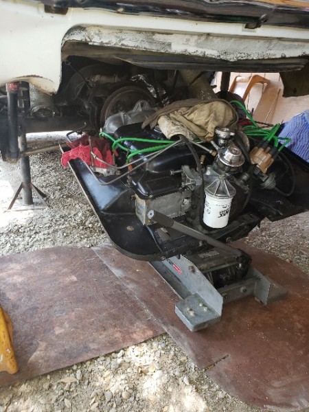

Okay...finally getting back to this rebuild swap. This morning, got all the final tin and brackets transferred, and the old beast tucked away for a teardown at a later date. The fresh 95 head rebuild is down on the transmission jack, and ready for hoisting up into the engine bay first thing tomorrow morning. Had to make some duct work for the heater system before I make it more impossible to do, once new engine is in. UGH!!! But, with some luck, she will be on the road again soon.
-m
-m

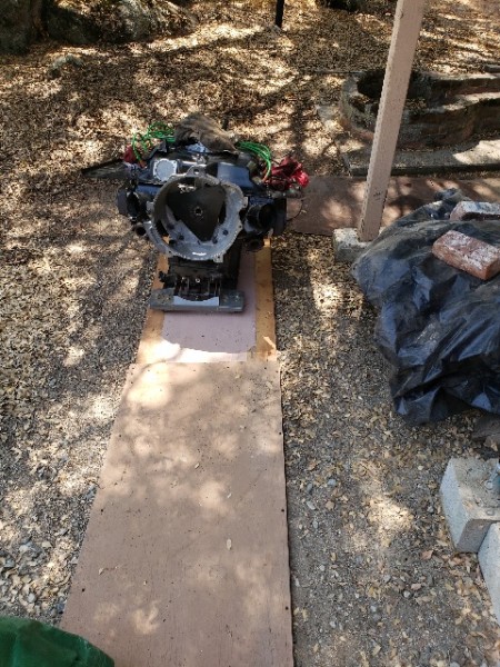

Out of garage, around two corners, about 20 yds. of travel...on my makeshift, leapfrog panels runway. LOL. Took about 10 mins., and she is now nestled under 'whitey', the 65 110 PG Sports Sedan, ready for install and deployment.
-m
-m
Got it put in...after getting everything buttoned up and realizing that I didn't put the flex plate bolts in. UGH!!!! (I'm getting some deja vu here) backtracked, and re-assembled. Took the drill and primed the oil system. Found a leak, which I thought may be,in my oil cooler. I saw some oil in the corner of it, as I was cleaning and straightening fins. Yep....small hole in outer bottom corner. Dang. So....had to go with the 12 plate cooler, since I had no spare 8 plate. But.....I looked in the stash, and found a 12 plate cooler cover, AND ITS CHROME,...and doesn't leak I'm stoked about that. Runs great, so far. Will take a shake out ride down the hill, into town and back. I'm confident that all will be well.
