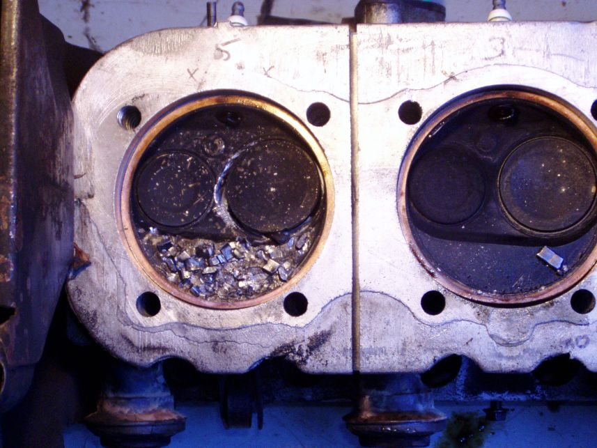

For reliability, deep valve seat heads are used to prevent "dropping a seat", which is no fun. Here's one I dropped years ago Larger bores: Stock cylinders are often bored to .030 oversized, which is popular and still reliable IMO. VW cylinders have been adapted to Corvairs for decades. Popular are 92mm and 94mm piston/cylinder kits, the 92mm are available in a "thick wall" cylinder, which helps to keep the cylinder round during operation - a good thing with a turbo. You can read about this conversion at Kent Sullivan's site http://www.corvairkid.com/mm01.htm
