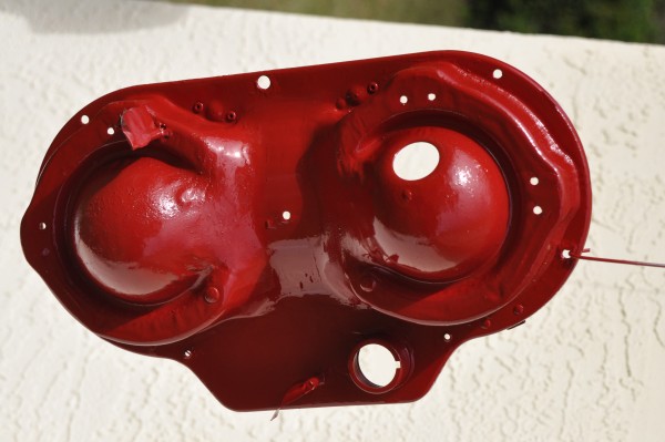

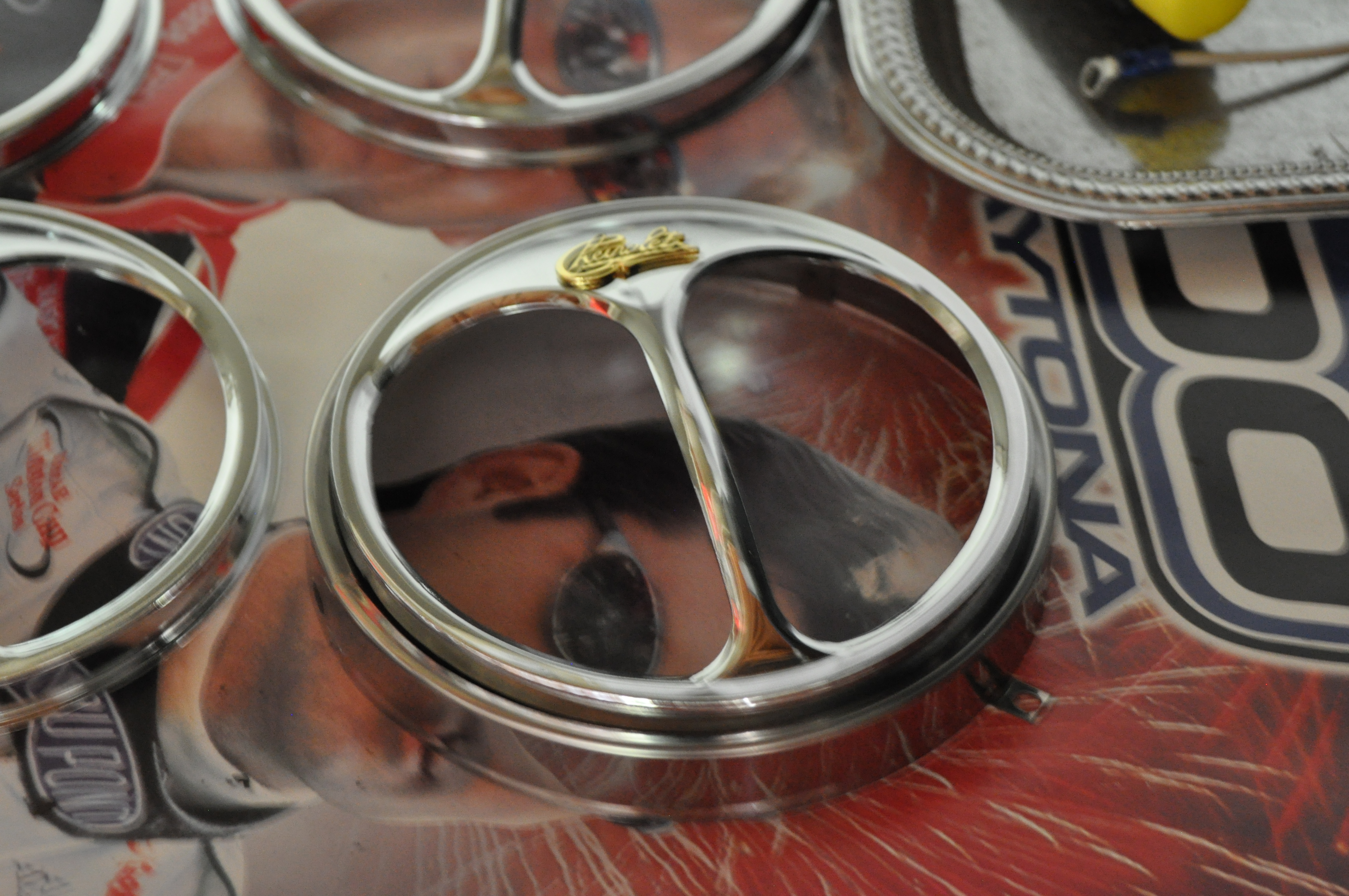

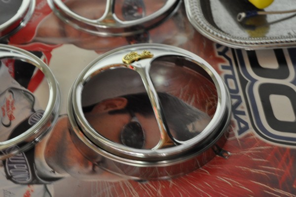

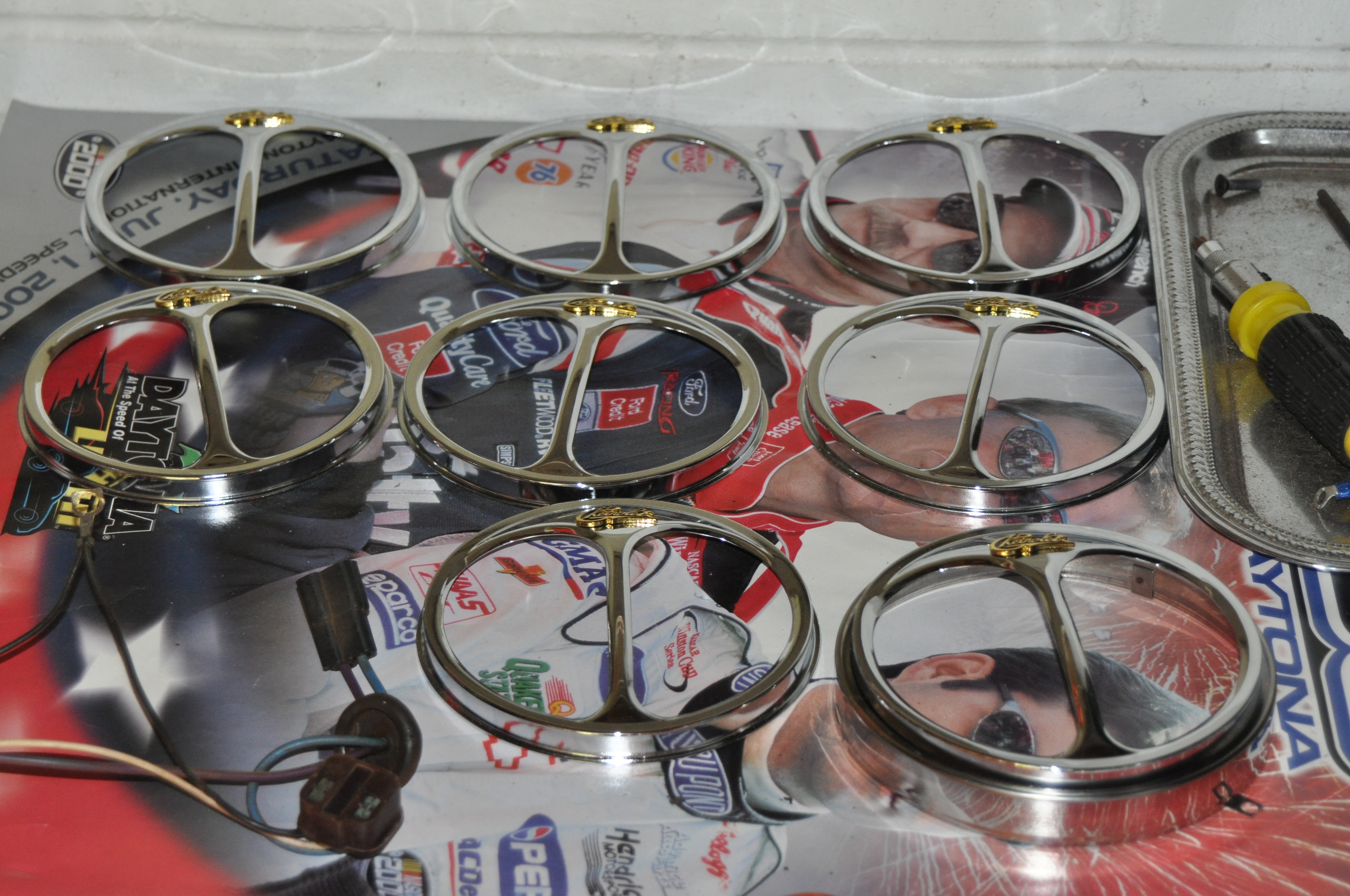

Bout ready to spray paint and assemble my headlight adjusters and glue the gasket onto the back of them and finally get them installed. Some idiot decided to cut square holes in one of them and install modern headlight adjusters and plaster them with black RTV. Well, it was tedious work but I removed the plastic and RTV and cut tiny metal squares to the shape of the odd Dremeled out holes and tack weld them in as I did the two new (non galvanized) stove bolts. The 'domed' heads fit perfectly for this and were a good base to weld from!! .025 wire on a low setting works great for touch and go and it's the preferred wire that body shops use for sheet metal work because it melts like butter. Good thing I have a pedestal grinder and wire brush for shaping them squares as it took a few trips back and forth. Anyway, it worked great and after some rust pit Bondo filling, I'm ready to sand and evaluate before painting. That Bondo looks plentiful now but will look great after it's sanded and the bolts are cleaned up.

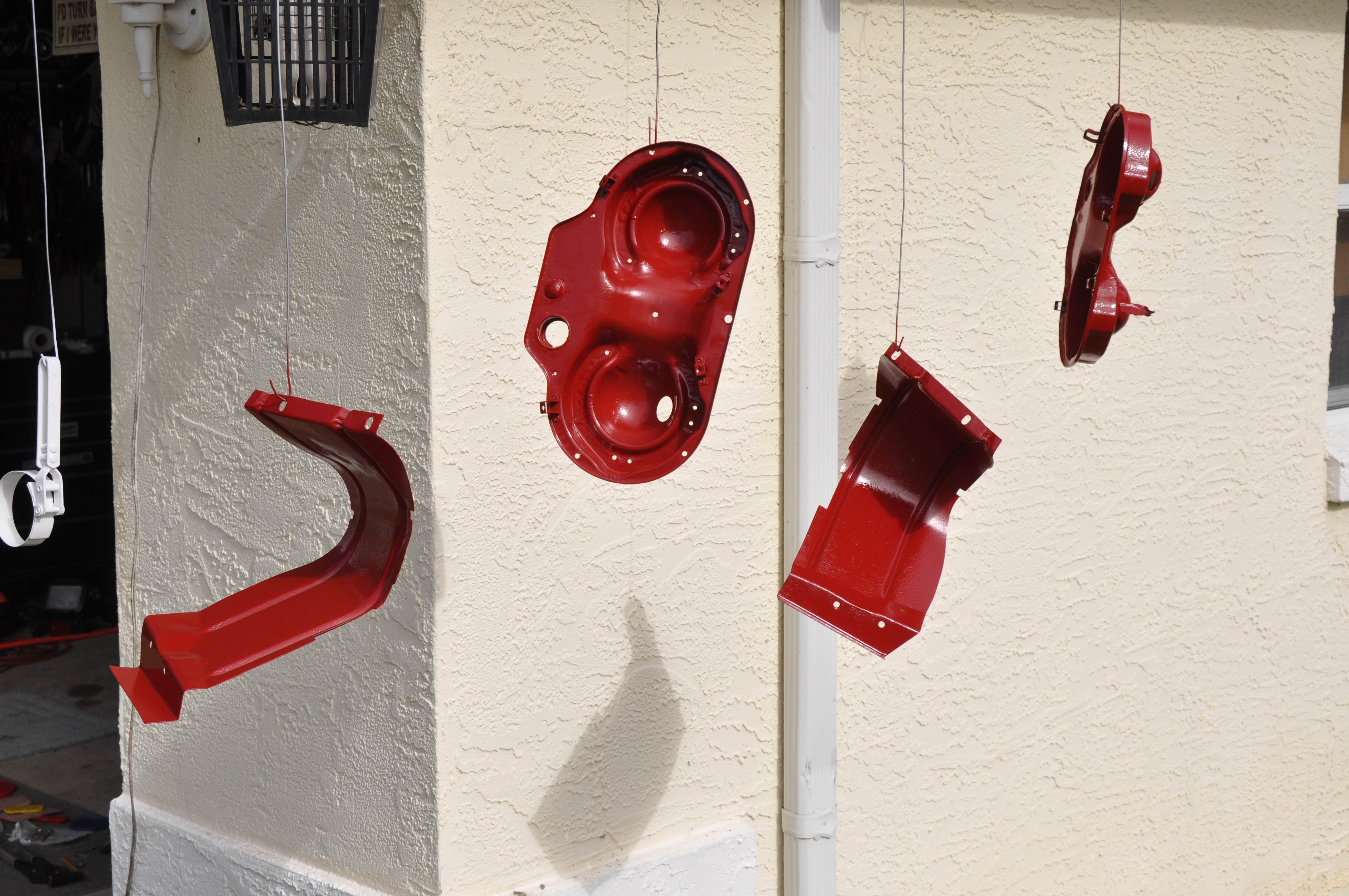

I finally got to paint my parts today and now after about a 3 day cure time, I will be able to glue my gaskets in place and install after I install my headlight adjusters. I'm really getting excited but won't rush things. Got my parts hanging in the sun so the paint can cure. I think once the mud shields are in place, they should be rubber coated with undercoating to help kill the sounds of debris that the tires may throw at them. Anyway, stay tuned for headlight assembly w/ the custom headlight covers being installed. The chrome trim rings I got from Clark's fit the headlight covers perfectly!!! I was afraid I'd have to do some Dremel trimming of the edges....

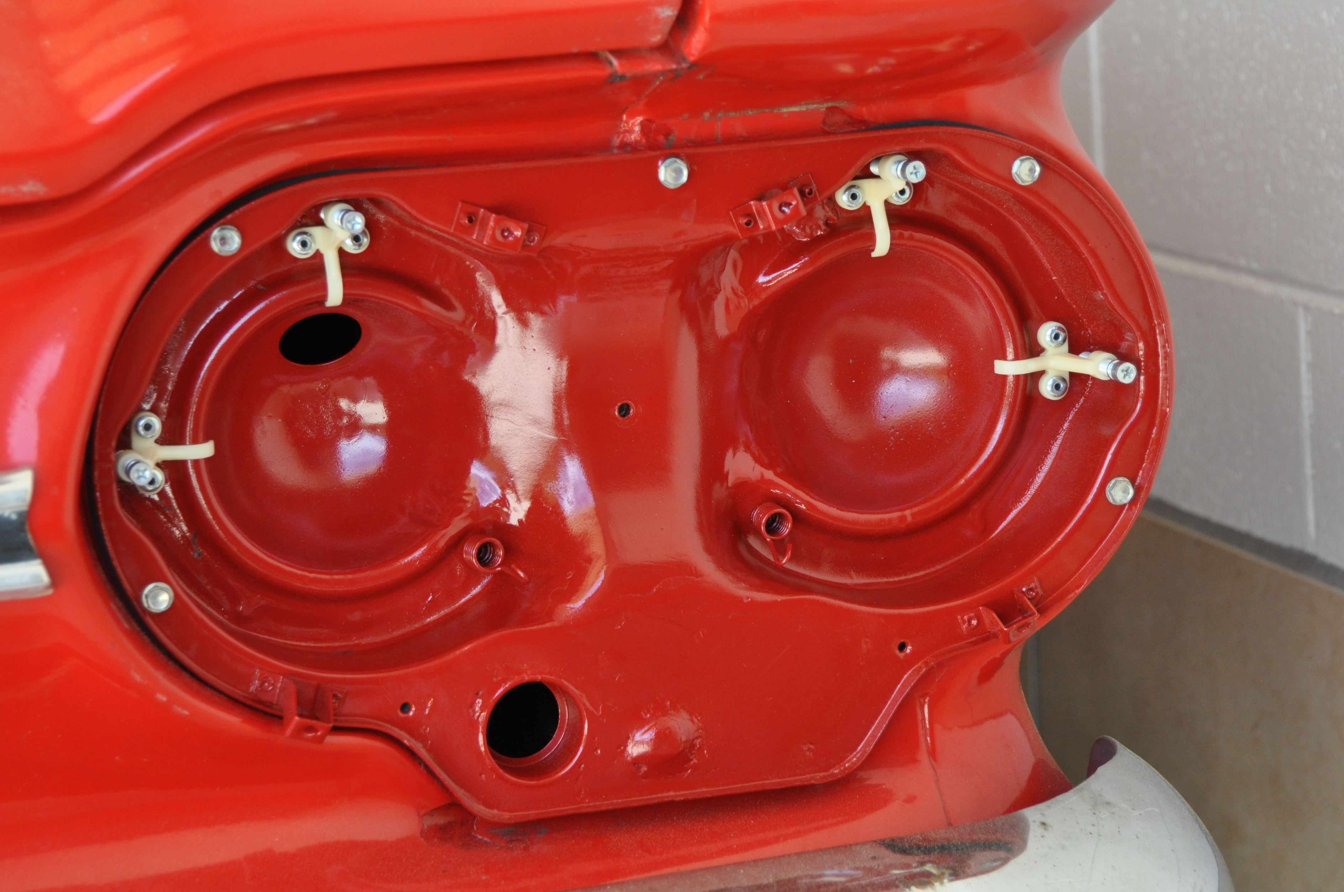

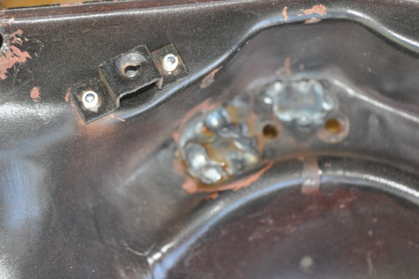

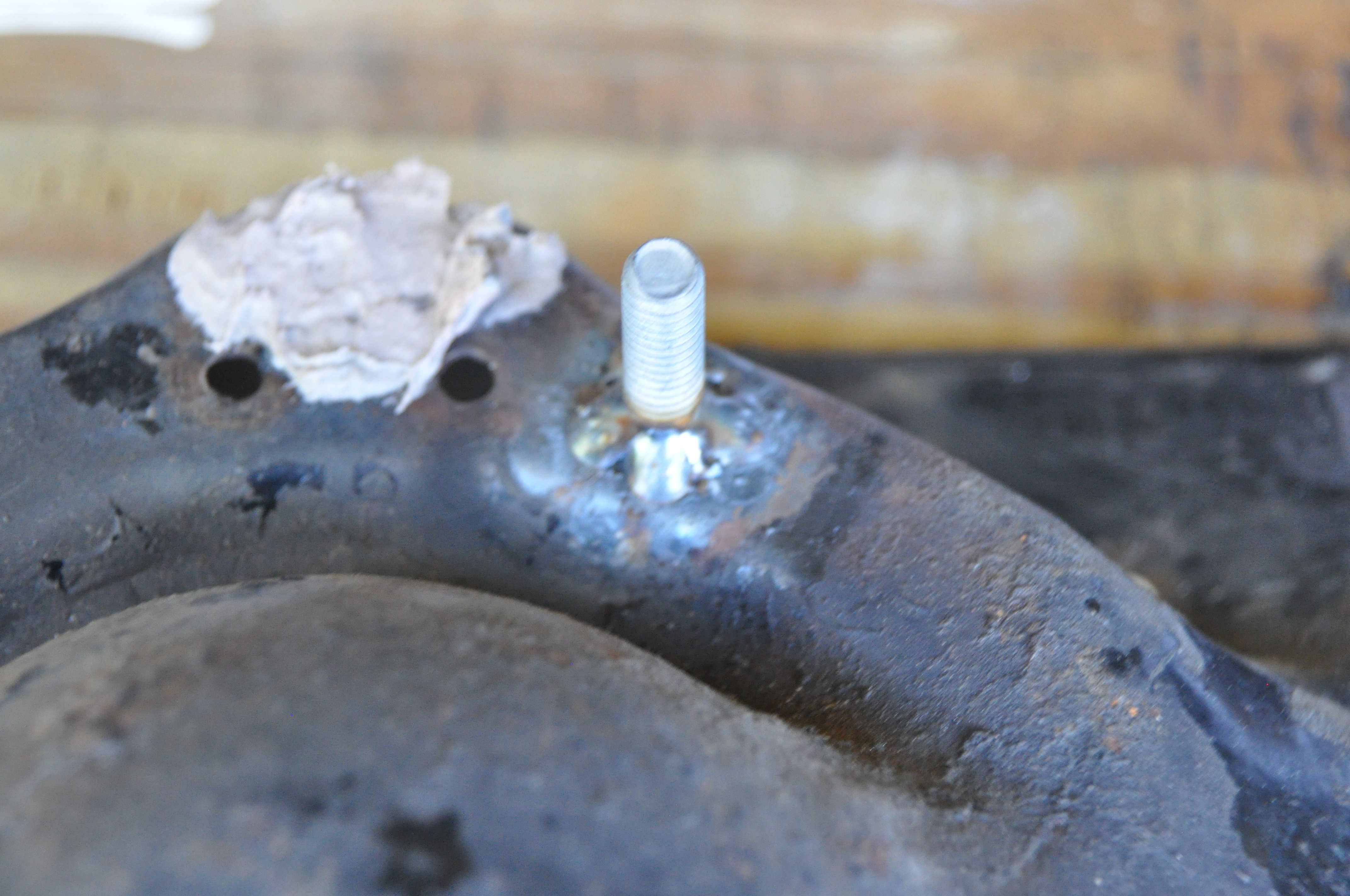

Also can someone please tell me or send me a link on the subject of > How do you install the new springs in the headlight buckets? My rivet gun won't go down into the spring and that hook is in the way anyway, but, I can either use a screw through the spring from the top or use a rivet from behind maybe by dropping a rivet washer through the inside of the spring. I'm thinking a screw would be the best procedure.
I didn't get any fasteners with my springs but I think I recall other kits including screws. I did get rivets to secure my headlight adjusters in place and I will have no problem there with rivet gun accessibility. Thanks for all your help. :tu:

A properly sized screw should work. The rivet from the back with a capture washer in the spring sounds like an elegant solution but will need to be pretty strong as the spring has pretty good tension on it. A screw and nut set up would certainly be strong enough I would think.

I found nice 2" tapered Phillips head screws and washers and lock washer to lock the nuts in place. I had to trim about 1 1/2" off the scew to make them the perfect size and they snugged them springs down nicely. I slipped the bucket gaskets on and all holes lined up great and stuck the buckets in place and drove the screws home!! That bottom bolt was not fun,but, at least doable. I have big hands but managed to slip the washers and nut on and with my short 7/16" box end wrench, I snugged them up!! Then I hooked up the grounds on the harness and tested them and that's where I am for the night. Tomorrow I will install the headlight bulbs, and the turn signal gaskets with the new turn signal lenses I got for it, then light covers, and front trim and I'll be finished!!!! Can't wait to get photos of the finished front end. The front emblem with the Chevy emblem looks much better that with it being black. Let's see what I have in my photo bag for now........

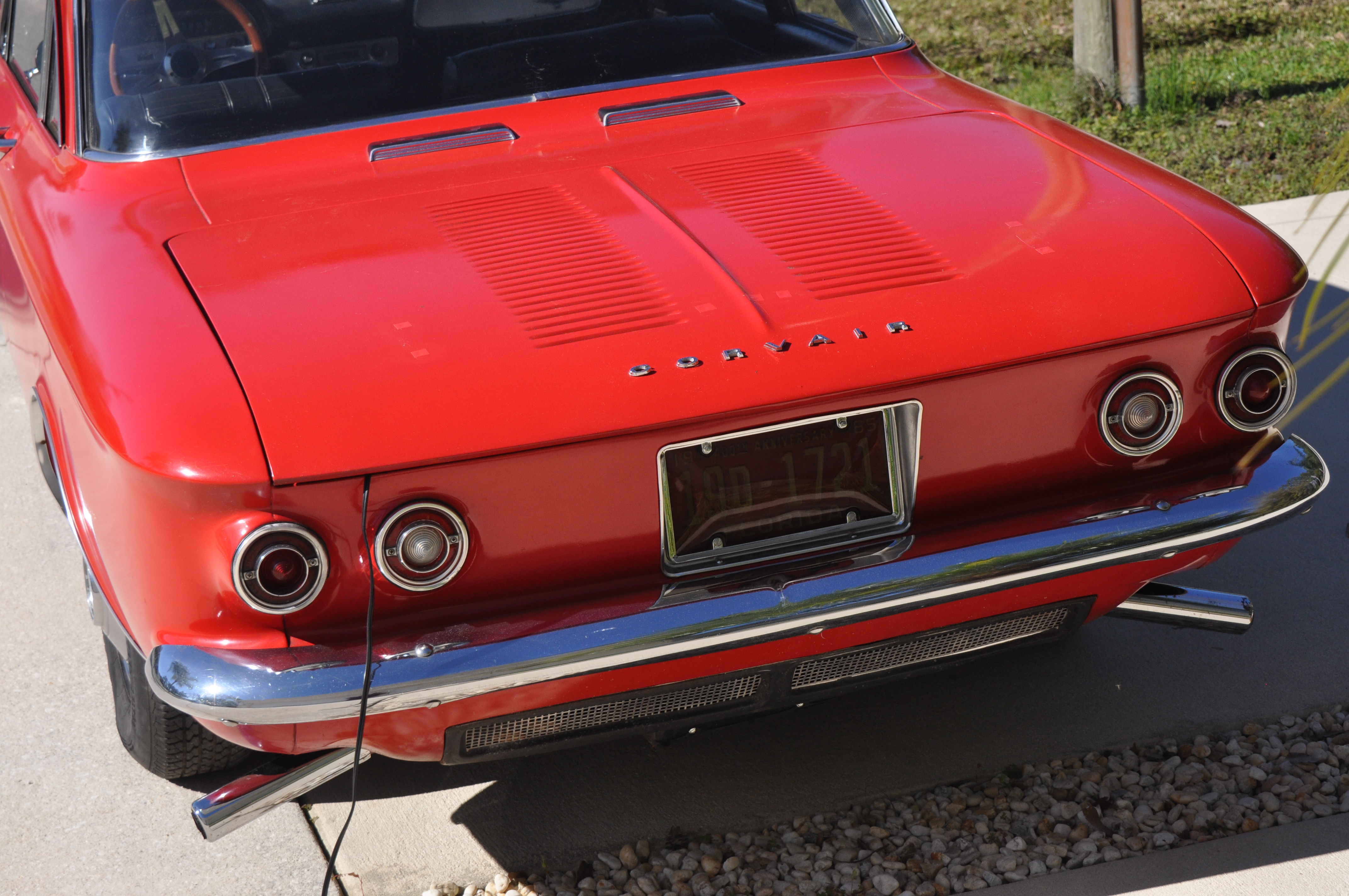

I finally looked under that rear of my car and located the two air engine vents. They're cool looking like that on the front sides of a stealth fight LOL... I took my fingers and found the passenger side springy and workable, but, the drivers side was a bit stiffer and not so springy. Are these easy to clean and to get working properly? Maybe it's a matter of spray lube or WD-40. I finished assembling the front end headlight system and what a difference!!!! I had to put my camera battery on the charger because it was too low to take photos. Later, Scott

OK, just took fresh photos of my beauty sitting in the Florida sun after finishing the headlight system!!! These are for my 'sale ads' also for $3000.
