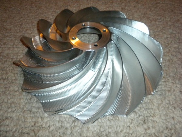

There is a guy on the other forum developing a fan that will take a lot less HP and push a lot more air. Coming along great but not ready to sell yet. I'm buying several when they are available. Good read on all the development.

As previously stated, don't waste your time or money. Kevin Nash has prototyped a new fan with some pretty amazing results. Looking forward to this hitting the market.

That's the one. Thanks for the link Brad.
Here's the companion bell he is working on: http://corvaircenter.com/phorum/read.php?1,1034739

Yep. Can't wait for it to come out. Will probably be the biggest "innovation" for Corvairs in quite some time!

I love the cooling innovation going on with the Kevin Nash fan but I don't see the burning need for it in my daily driver life. I'm on my 6th summer in Phoenix driving a PG 65 4dr 140 with factory A/C and still using the old Frigidaire compressor. If anyone needs more cooling it would be me and we drive it carefree just about anywhere, including a summer trip on the freeway up through the mountain passes to Flagstaff and most recently, down to Tucson and back. The engine gets hot but not enough to make me turn off the A/C as a precaution.

Turbo guys need it. A turbo will overheat very quickly on boost. You can only run short bursts with the stock fan.
His fan would make your engine happier but it probably isn't worth the expense. It should improve the gas mileage if you slowed it down to where it put out the same air as a stock fan.

If Kevin's fan provides more cooling at less HP that would be great.
