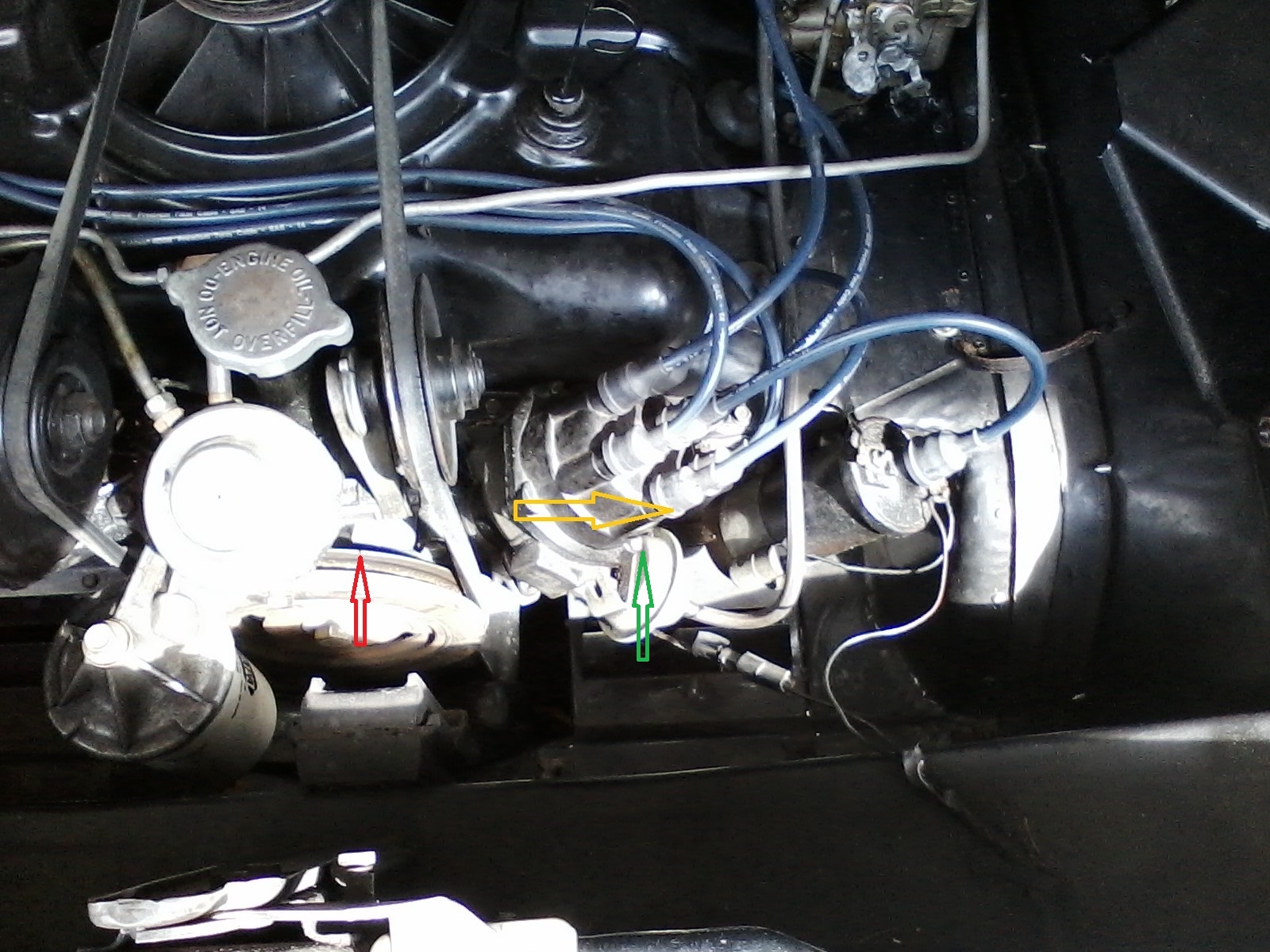

What's making you think the valve is open when it fires?
Earlier you said you had a fire, popped back through the carb.. Set the distributor with the rotor pointing to the number one position on the cap with the timing mark at 0, if it's on the compression stroke it will run if the cam is correct.

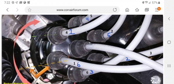

Jeff, mine's close to that. Just my #1 starts at a different position. Logic says that shouldn't be a problem, but attempting full disclosure... below is what mine is:
The popping back gets me too. But I know I have compression (IE sealed valves) and I know my spark is on the compression stroke.

So in reality your dist. is about 2 teeth off. Number one on the cap is to the left of the hold down screw, I learned that 60 plus years ago & if anyone has to work on my car they know where number one plug is because that's the way the factory makes them. You guys who move the plug wires around instead of setting it up like it's been done for over 100 years are just making a mess for the next guy who gets your car. They go to do a tune up & say what the hell. :banghead: Start the engine at TDC on 0 then put a timing light on & set it where it runs the best. Sounds like your cam might be the culprit if it won't start. Hopefully you can get it to fire up so you don't have the get into the cam & find out that wasn't it.

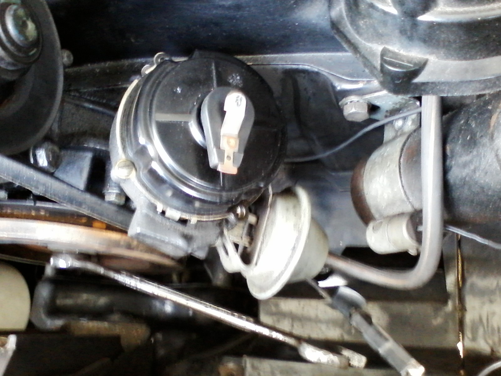

64powerglide wrote: » Tue Apr 10, 2018 3:13 pm
You should first make sure your timing is correct. In my photo I show you top dead center on compression stroke & the position of the distributor cap. When you turn the engine over with a 3/4 inch wrench you bring it around counter clockwise & line up the timing mark on the lower pulley with 0 on the timing marks on the block. Remove the cap, the rotor should be pointing to the number one plug position on the cap. If it's pointing towards the front of the car turn in one more revolution by hand & you should have it pointing to the number one plug on compression stroke. Note the position of the distributor cap. Number one position should be the first one left of the cap screw. When you have this correct start the engine & set the timing. Left click photo's to enlarge. Your RPM's will be higher in neutral & when you put it in drive it slows way down. You want 500 RPM in drive or as low as you can get it without stalling. NOTE MY VACUUM ADVANCE, it's further right than yours & in a better position to adjust the timing
With the distributor oriented like it is in the above pictures, and the rotor pointing as shown, and the crankshaft pulley aligned with the zero timing mark, you should be on the COMPRESSION STROKE (both valves closed on cylinder number one — no tension on the rocker arms on number one. If you find the exhaust valve open on number one cylinder, your distributor is inserted 180 degrees out with the piston at Top Dead Center (TDC) on the EXHAUST STROKE. This is corrected by removing the distributor, manually turning the crankshaft pulley one full turn to put the piston back at TDC, but this time on the COMPRESSION STROKE with both valves closed. Then the distributor is reinserted with the same orientation shown in the pictures. Static timing cnan be set by moving the timing mark on the pulley to the desired timing setting. Then adjust the distributor base by turning the base so that the points just open. Secure the distributor. This should be very close to te correct timing when it is confirmed with the engine running using a timing light.
If you have reason to doubt the accuracy of the timing mark on the pulley, there is a procedure shown in the video below for using a piston stop tool in place of the spark plug in the number one cylinder. As shown in the video, the piston stop tool causes the top of the piston to contact the tool and prevent the engine from being rotated any further. At this point a mark is placed on the pulley showing the location where the piston stop tool causes the engine to stop rotating. (Never use the starter motor to rotate the engine when doing this procedure. You do not want the starter motor ramming the piston with a lot of force into the stop tool!)
