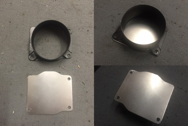

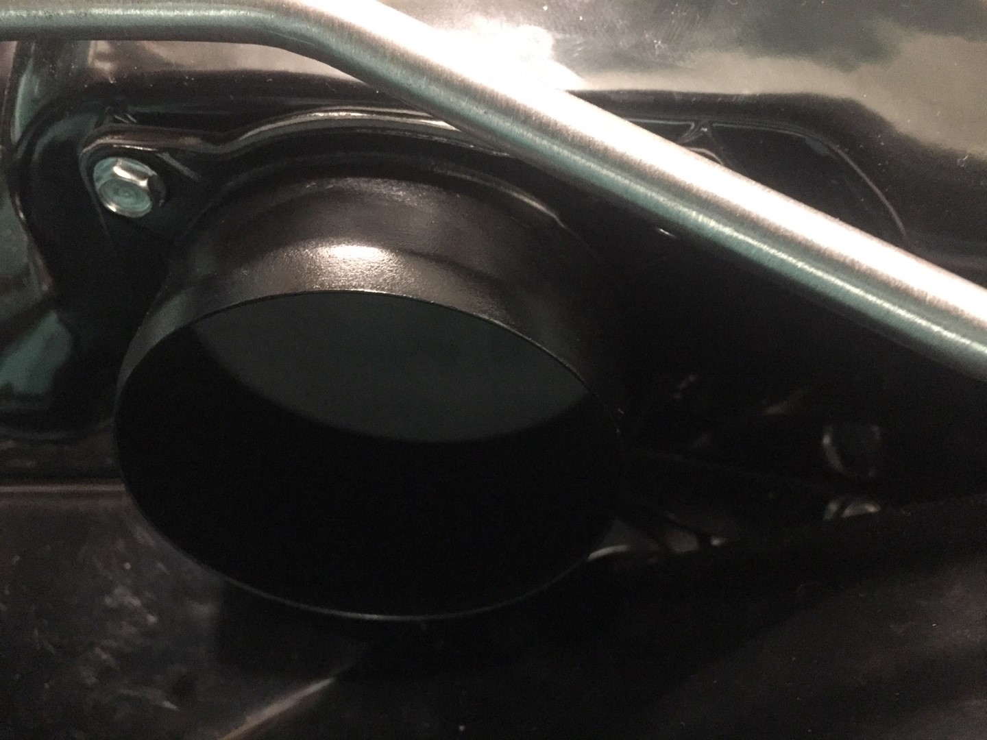

I got some advice from Corvair Owners Group and i made a block off plate for the hot air intake.
Cilindar 5 is happy. ready for paint and install.

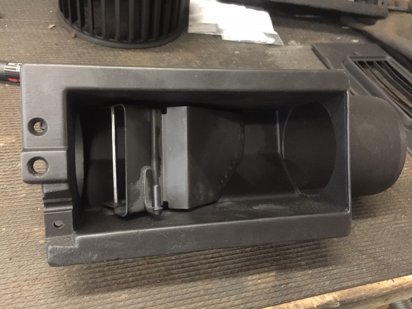

The block off plate parts

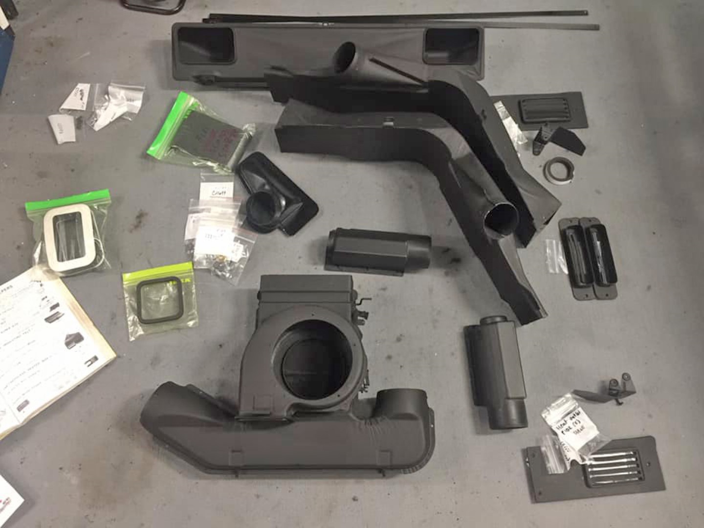

All the parts for the heat system Part by part back together (this one is almost done, the felt and the foam, and its done) and inch by inch the lines are on the Lakewood, thanks to the help of my best friend, always nice to work together on the Lakewood! Stay tuned, more and more to come!
And installed
At the moment i'm working on 2 things, the heater / fresh air system & the brake / gas linesAll the parts for the heat system Part by part back together (this one is almost done, the felt and the foam, and its done) and inch by inch the lines are on the Lakewood, thanks to the help of my best friend, always nice to work together on the Lakewood! Stay tuned, more and more to come!

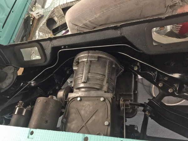

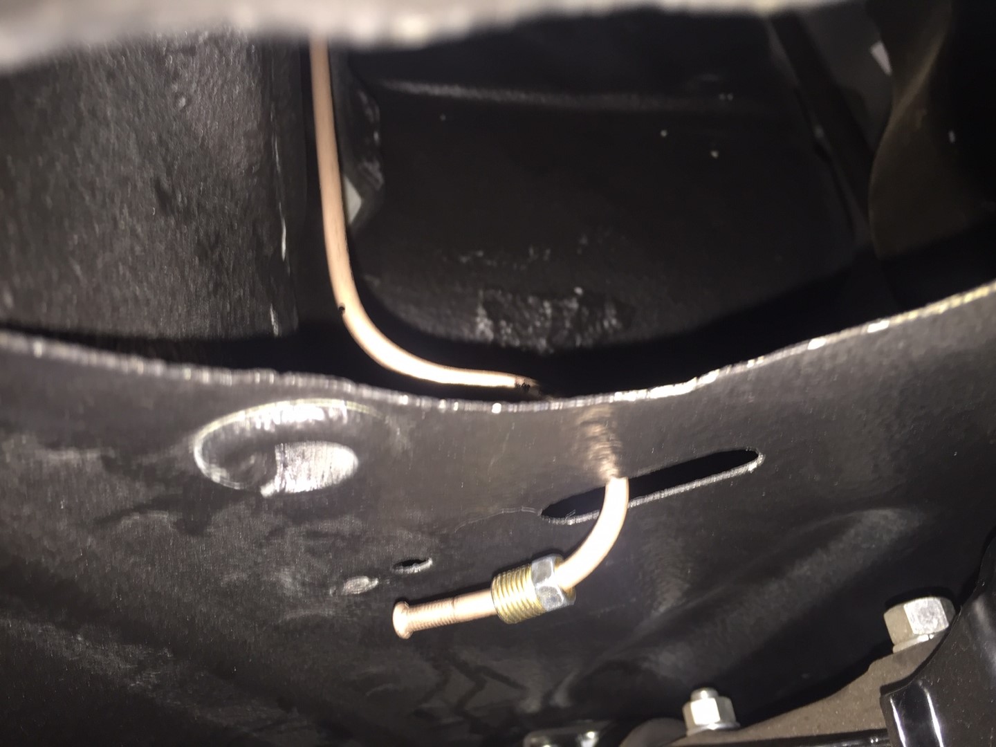

We took the other lines out. I had bought nice stainless steel lines, but they are too hard to flare
So after 2 weeks of searching for tools, other workshop that could help me, I gave up and bought Cunifer lines. They look awesome too, little more red, but easy to work with.

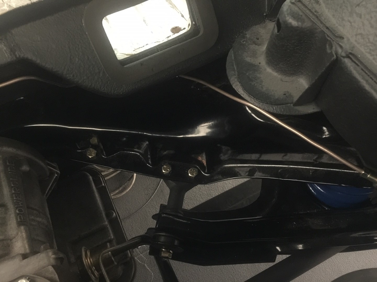

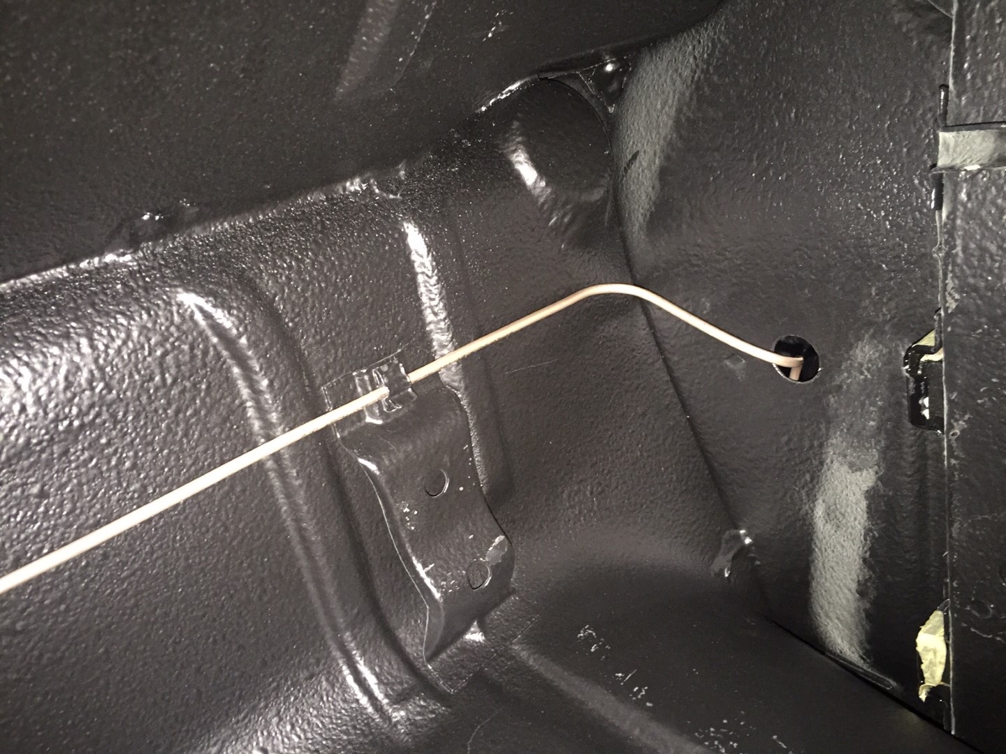

Fuel lines out, and newly hand bend lines in. Perfect the way i want it.
Same with the brake line, step by step bend to fit.
And the connection to the front brake lines. We needed to drop the fuel tank to make and place the front brake lines. The fuel tank is out already, soon we start working on the front brake lines. Heater parts are done to and ready to go in when the lines are done.

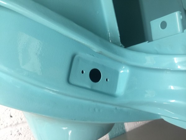

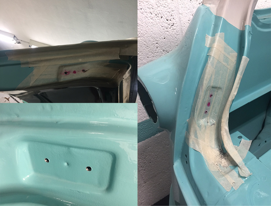

Well more progress drilling holes in the body work
The first result, we need a bigger drill for the center section

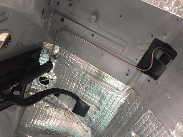

other part was bending and more bending, brake lines in the front. Lines are bent, time to find the correct grommets and rebuild the master brake cylinder. After that we can connect everything and tighten the "nuts and bolt". the car is so dirty of dust
There were some pretty weird lines to bend

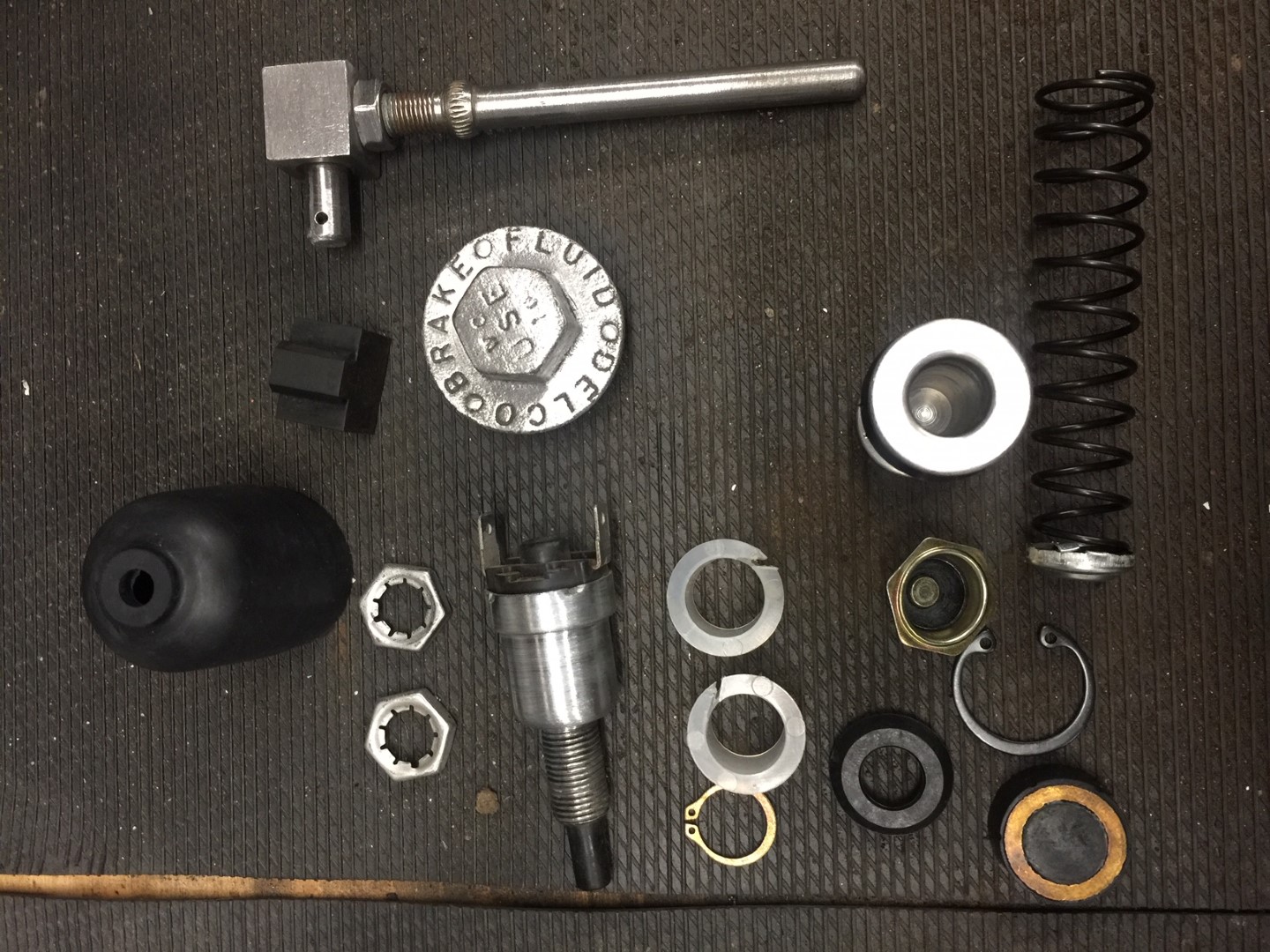

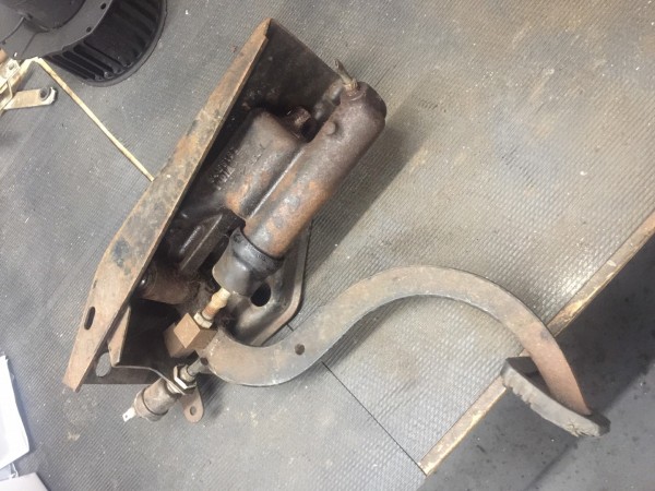

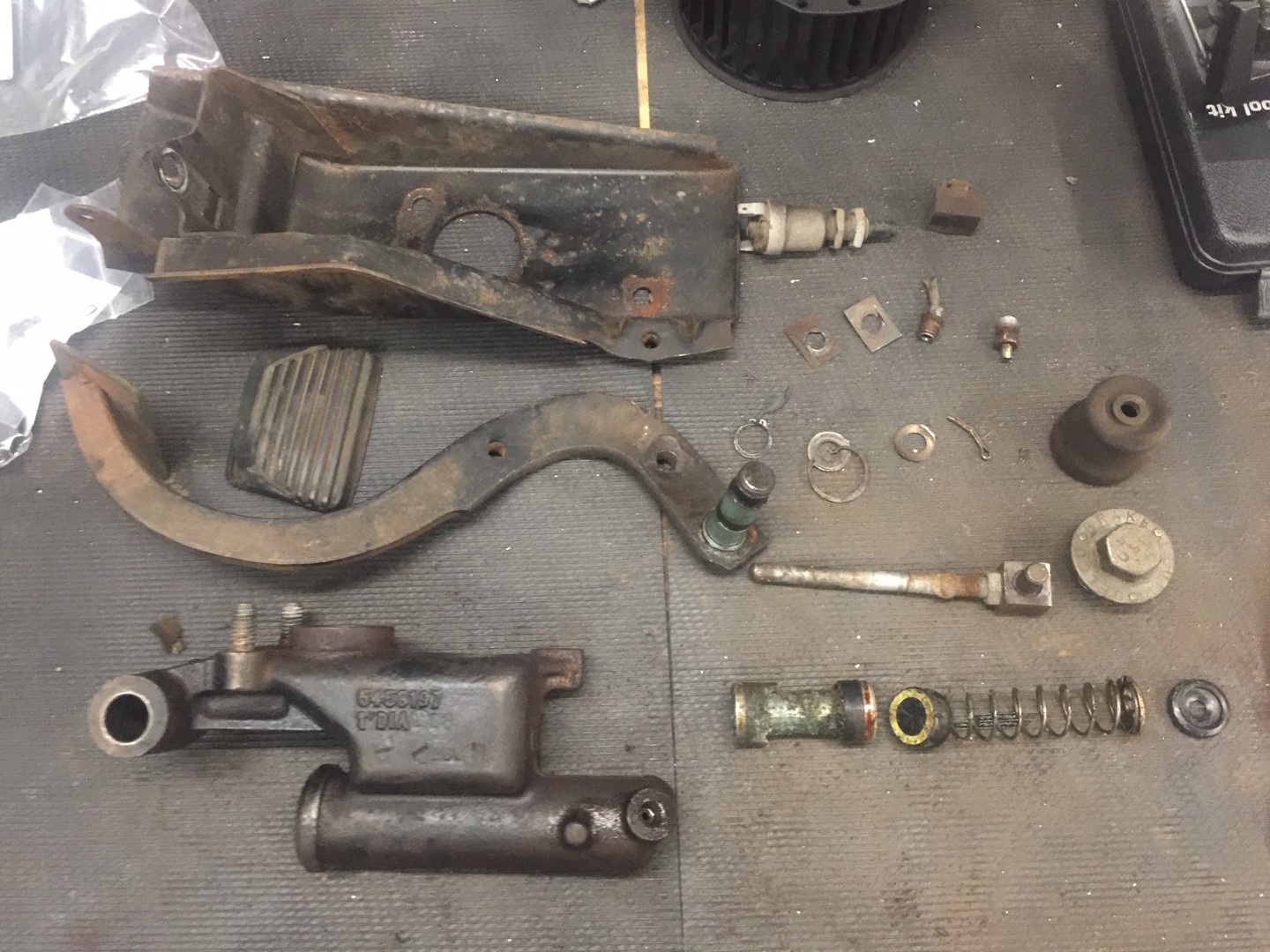

Time to rebuild the master brake cylinder
All the parts, old parts and dirty parts
Nice new and clean parts, ready for the build up
I always lay everthing down like the exploded view drawings, a good check if i got all the parts or wich part i need to order for a replacement (in this setup 3 new parts are on the list, but all can we replaced when it is in place)
And there you have it, a fresh new brake padel en master cylinder
Time to connect the last brake lines to the this part!

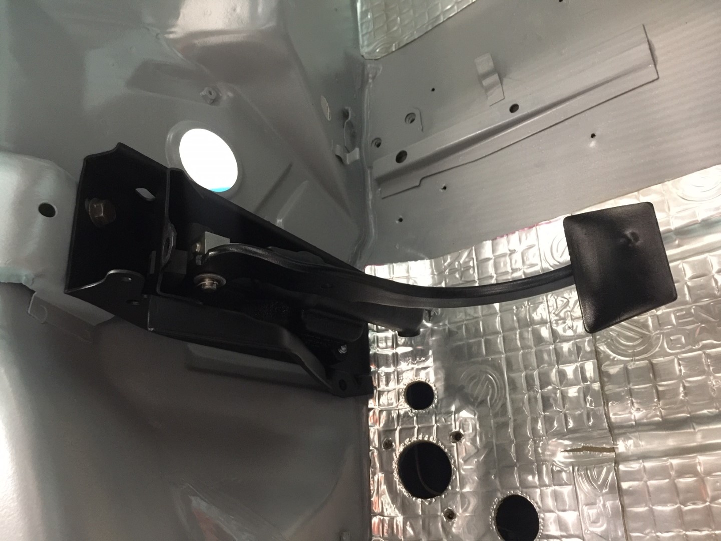

The last brake lines are bent and placed in position. some pretty weird "corners" . This was a harder job than we thought, but we pulled it off!
Connected to the brake pedal

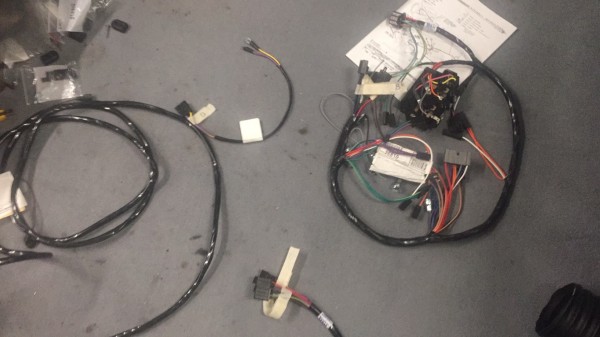

Beside the "stupid" gas tank we had some fun with the electric as well, figuring out how the electric works / back in position. We will try to "finish" this as soon as possible,but first WE NEED TO CLEAN UP THE WORKSHOP! it is a mess, so this weekend we start cleaning and from there go go go on the Lakewood.

DOT5 fluid is a good idea since the system is vented and DOT3 and DOT4 are hygroscopic.
- TikiRalf
- Posts: 621
- Joined: Tue May 24, 2011 1:07 am
- Location: Valkenswaard - Netherlands - Europe
Re: Corvair Lakewood 61 - NL
DOT5 it is / will bejoelsplace wrote: ↑Wed Jul 10, 2019 9:57 pm DOT5 fluid is a good idea since the system is vented and DOT3 and DOT4 are hygroscopic.
I got already a bottle at home to fill to system (i dont know how many there goes in the system)

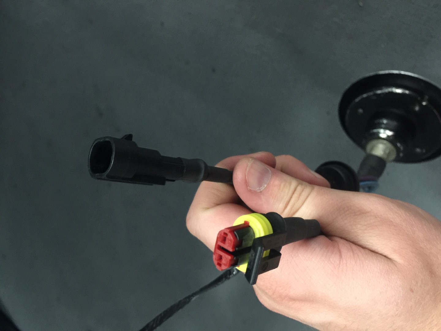

All small things, from new waterproof connectors

Drilling bigger holes in the body for the back up light system
