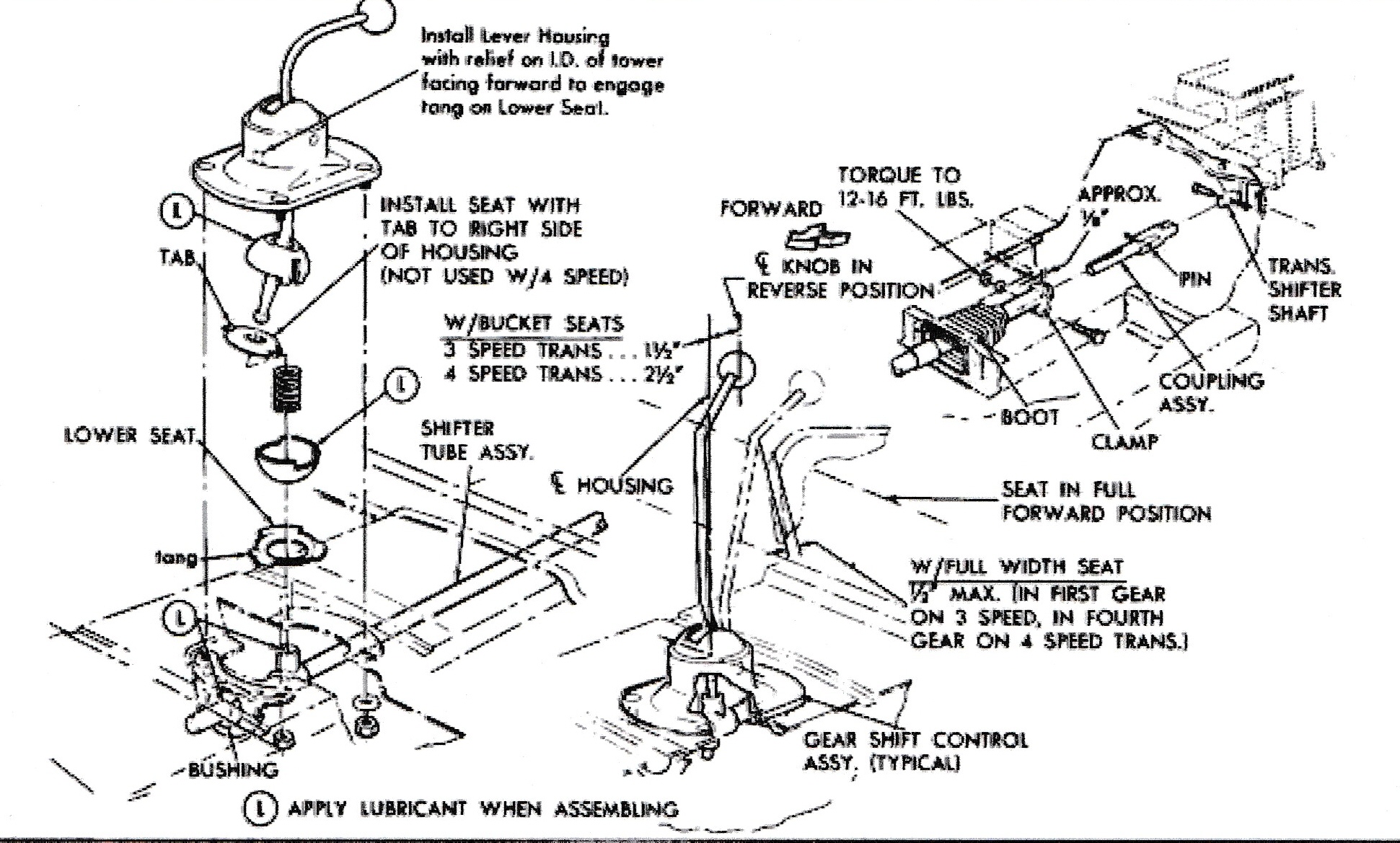

I don't know much about the shift adjustments but is the support bracket on right or should it be turned around on the same bolts?? Or is that the only way it will go on? :dontknow:
Support bracket.JPG (71.42 KiB) Viewed 1508 times

You may be onto something there Jeff. I don't have a 4-speed on a lift to look at right now.
The picture actually looks like the bracket isn't sitting against the floor like it should. Looks like it is sitting on the ridge where if you flipped it 180 it would sit flat and give the shifter more throw.

this is how it was and looks right to the manual if anyone has a pic of a 64 to confirm this would be great

That bracket is on backwards & that is the cause of your problem. The bracket is made offset & it's in the way the way it is & your shifting will never be right until you rotate it. Note the curve in the bracket to match the hole.

I have just turned that bracket around and the shifting is better now, Thanks for all the help
