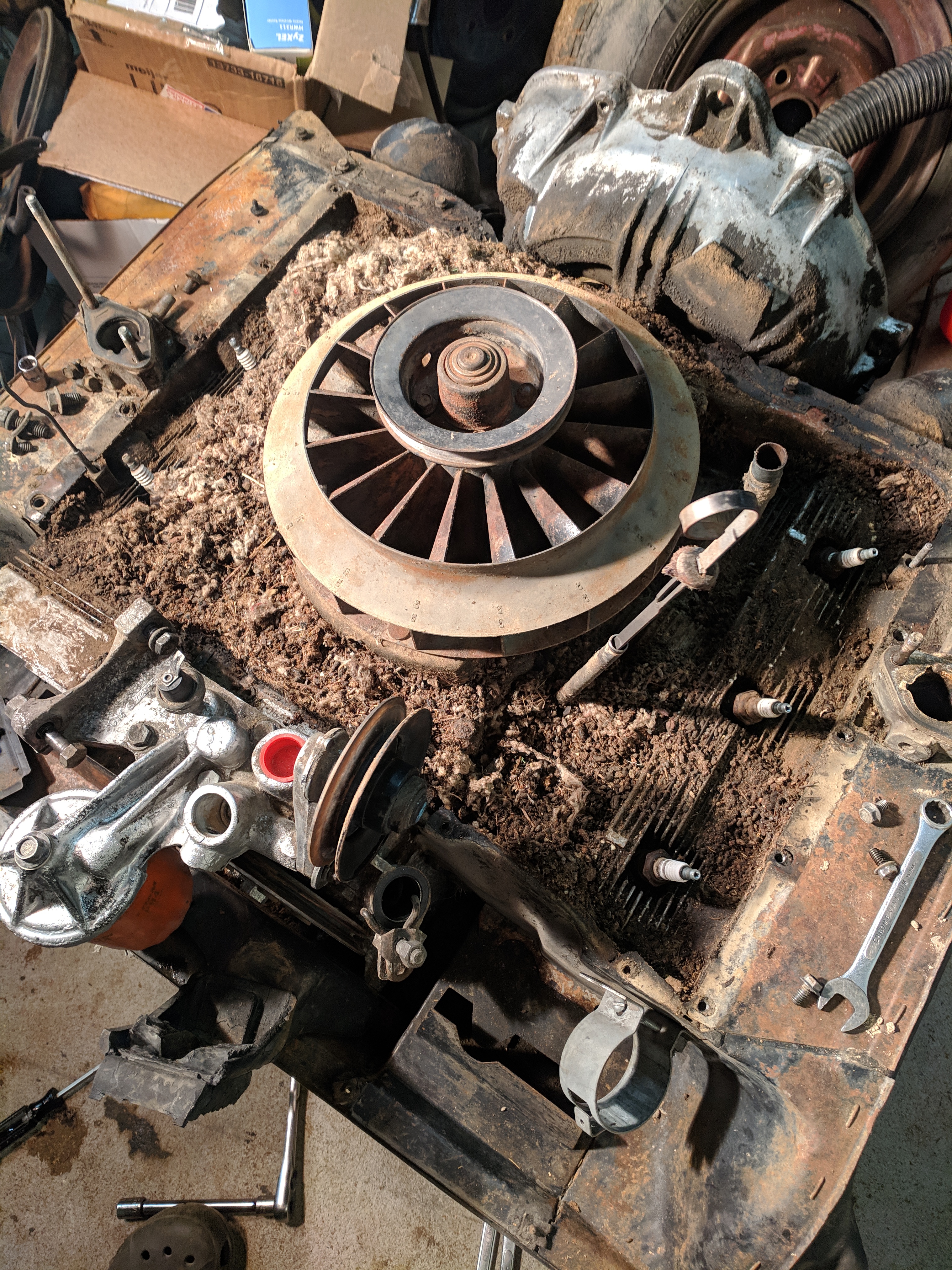

I started to take it apart and thought I would share pictures of the mouse nest I found. The fins and such are completely filled with crud, so I will be working on this a bit to get it clean. After that I will determine how far I will go on a rebuild.

Oh wow, that needs a good vacuuming!

Wow! That engine looks worse than mine was! Let us know when you discover the spider sacks and hornets nests. I had about 35 hornets nest in my whole car. Spider sacks looked like tight packed cotton-balls plugging all of the ducting. Fun!

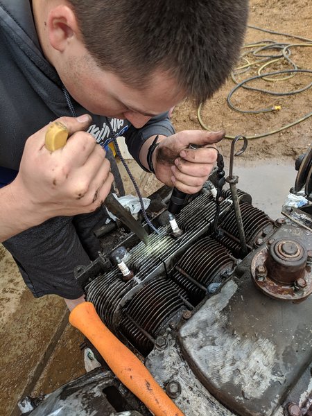

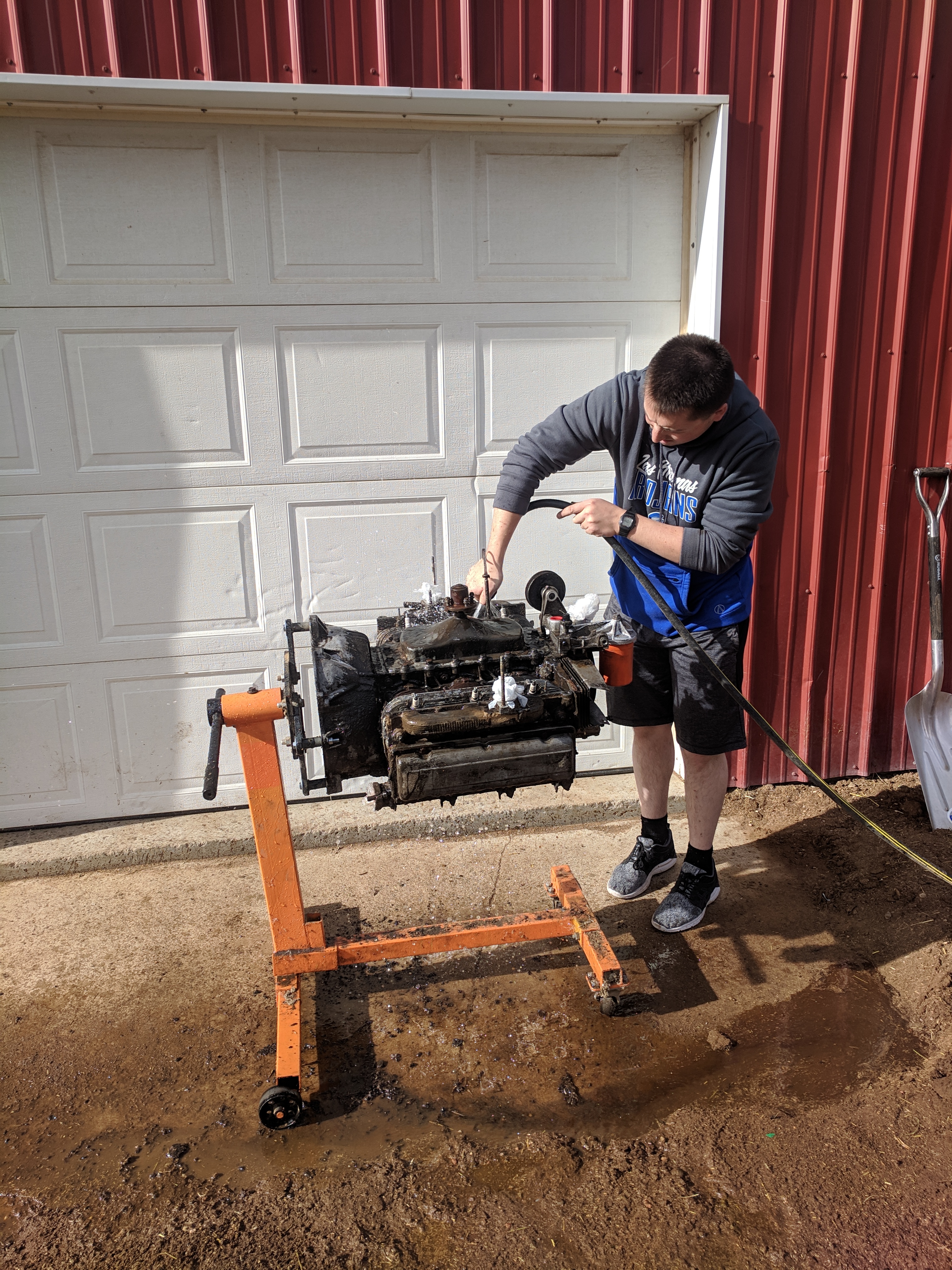

My wife was out of town, so my son and I worked on cleaning the engine. Spent over 3 hours trying to clean out the fins. Got most of it, but man was the stuff caked in...

Did you try using hacksaw blades to clear the guck and any flashing from between the cooling fins? If for some reason, they are clogged with oil/dirt, and the normal liquid degreaser is not working, I recommend liberal application of "Gojo" hand cleaner (formerly GOOP?), the creamy white stuff (not the gritty "orange" cleaner). Use a stiff parts cleaning brush, get it as far in as possible, and let it soak over night. Power wash with hot water if possible (cold will do). I use this stuff for all my degreasing.

Looks like they were de-flashing the heads in one of the pictures above.
