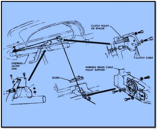

Here are a few more tips for a new Corvair owner...
As you are probably aware, the emergency/parking brake is the ONLY thing that prevents your Powerglide automatic transmission-based Corvair from rolling away when it is parked. Unlike most automatic transmission-based cars, the Corvair Powerglide does not have a PARK position on the shift lever! There is no mechanism in the Corvair automatic transmission to lock it when parked. This makes the condition of the Corvair parking brake cables and pulleys particularly important.
An aging cable can snap without warning, and nobody has to be present to witness the event! You should also inspect the plastic cable pulleys along the main cable route.
