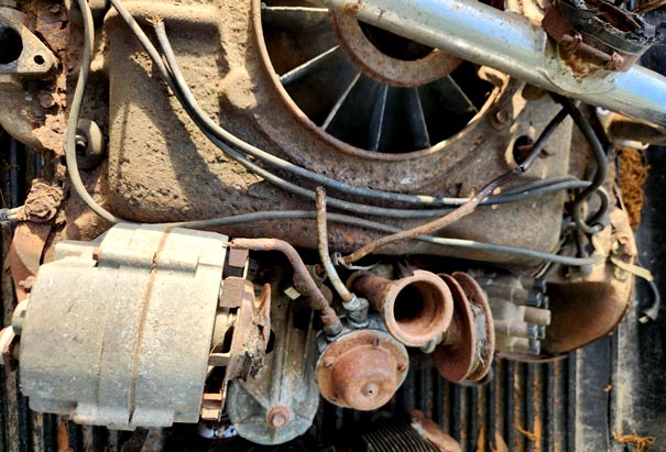

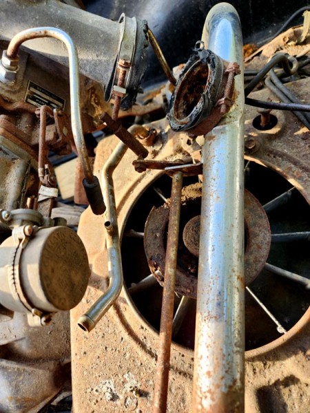

I see a 12 plate cover and an alt adapter also. Does the turbo engine have the long special 4" heater hose extension on the right hand side? May be a rear cover with the long timing tab. There appears to be the '65, '66 thick washer spacer that is suppose to go between the alt brace and the alt.

I will take some close ups of each. I will post when I have them. Right now taking a break from a small concreting job.

66vairguy, I saw those parts around the 12 plate oil cooler. I knew they need cleaning before declaring them good parts. The rear housing hopefully will be salvageable. The heater hose on 66s was on the left side, but I will check. If the hose adapter is good, it will be saved. Here is the Part Catalogue info on the brace. Nothing specific for a turbo engine.
2-317 BRACE-SPACER. Generator
Length - Slot - Offset - Shape
65-69 CORVAIR, FC 5 1/2 - 3/4 - 1 1/8 - Curved - 3883889
65-67 CORVAIR 3883890 SPACER. gen. brace to gen

Besides the 4" heater hose extension on the RH side that is usally missing. The part that the extension attaches to is usally still there. Since the hole is "D" shaped it is a turbo only part, if it isn't rusted away.

Rex: I will address the part you are talking about on the turbo in the next post. This post is smaller and about the 140 engine, or the remains of one.

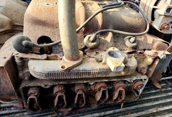

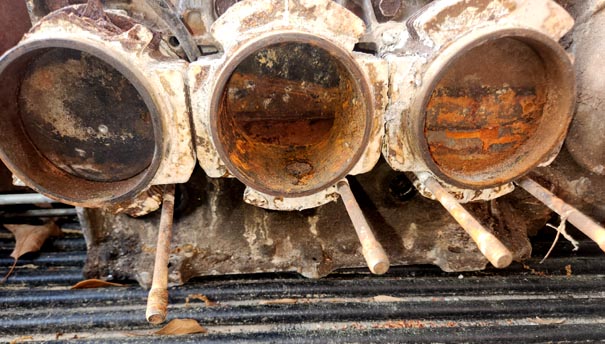

140 RT engine remains Photos:
LH head assembly: Not much here. Carb studs, maybe a thermister, but I doubt someone left it behind. No one wants the washers under the valve springs , or any of the lower stud related parts. Scrap steel and aluminum is all I see.
Pressure plate and flywheel for someone who wants to have them bead blasted & resurfaced. If no one steps up, I have scrap steel and aluminum (bell housing).
Maybe a crankshaft. Rods are too far gone with rust (JMO). Scrap steel and aluminum seen here.
This may the one to cut the rods and case to extract the crankshaft. Scrap the rest as steel.

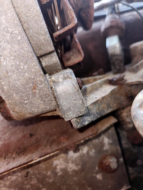

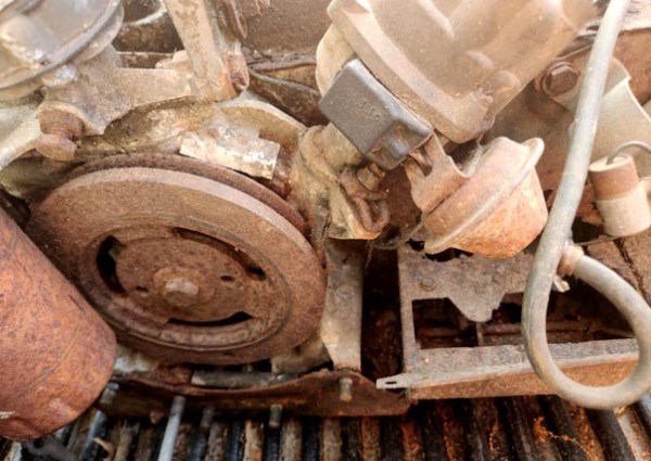

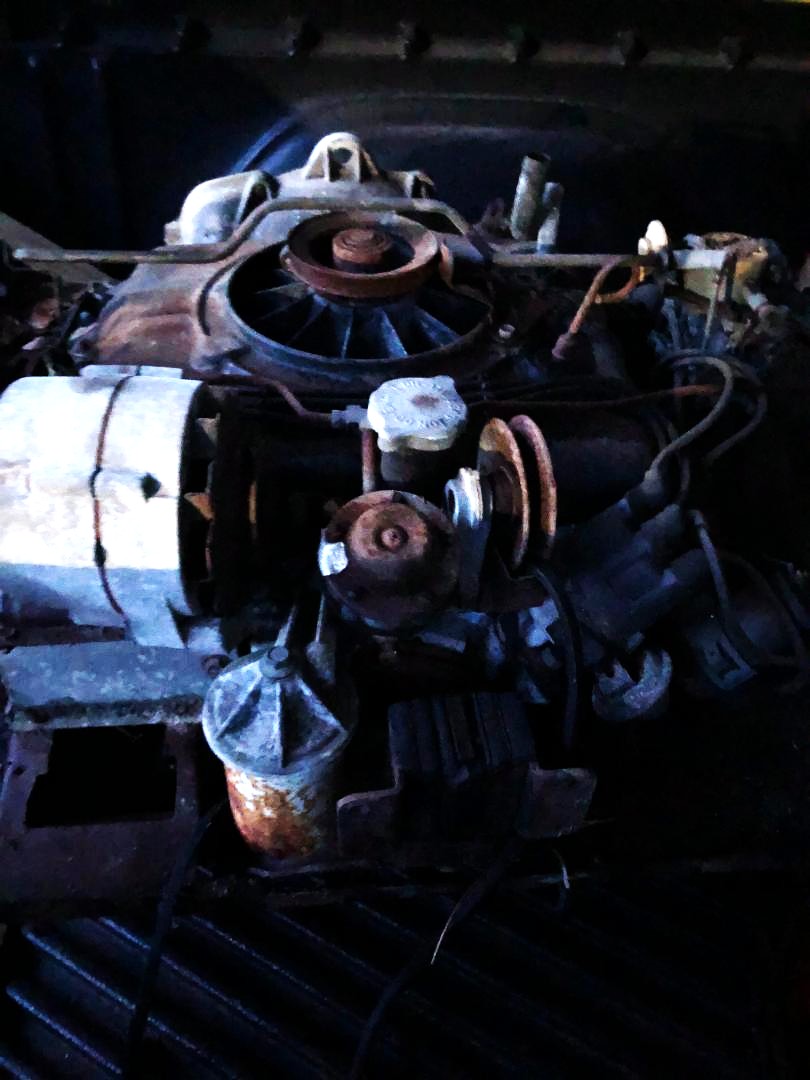

Rex: you get to see where your post fits into the photos now. It is only could possibly be found on the 4th photo. But you are right, it is gone due to an attack by the environmental atmosphere of southwest Georgia.
Turbo 180 Engine Remains Photos
Flex plate and PG bell housing on engine. Interesting Parts to scrap. Turbo and carb parts to save for someone to call about. Fan shroud scrap. Turbo pipe & mount scrap. Intake pipe scrap. Fuel lines scrap, but good chrome save. Linkage save for someone to call about.
Left air outlet scrap. Is there a thermister at end of wire? I have to be careful in area until I know for sure.
LH head. Looks like a scrap item.
Same comments as photo 183829. Plus the Turbo only RH heat air metal duct is rusted off gone, along with most of the cover panel it attaches to.
Fuel pump and idler pulley scrap. Dispose of plug wires.
12 plate cooler- save and its cover plate.
RH head. Looks like a scrap item.
Harmonic balancer, needs rebuild. Turbo rear housing with special timing plate. Turbo distributor with a retard unit I think. EM RH cooling box - scrap..
Alternator fan, destroyed. Hopefully front housing is OK. A good view of a Generator Adaptor on a 1966 Turbo Engine with an alternator mounted on it.
Alternator/Oil Fill Adapter is really a Generator/Oil Fill adaptor. Scrap Item. Have to pull steel items off.
Now you all now what I think I have, which is possibly a nitrided crankshaft in this engine.

It looks like that engine was hooked to a PG in an early. The top shrould has been switched.
- Posts: 1105
- Location: Southeast Georgia
Re: New Dismantling Project
I believe you are correct on that assumption. But to a PG is sort of unbelievable.
