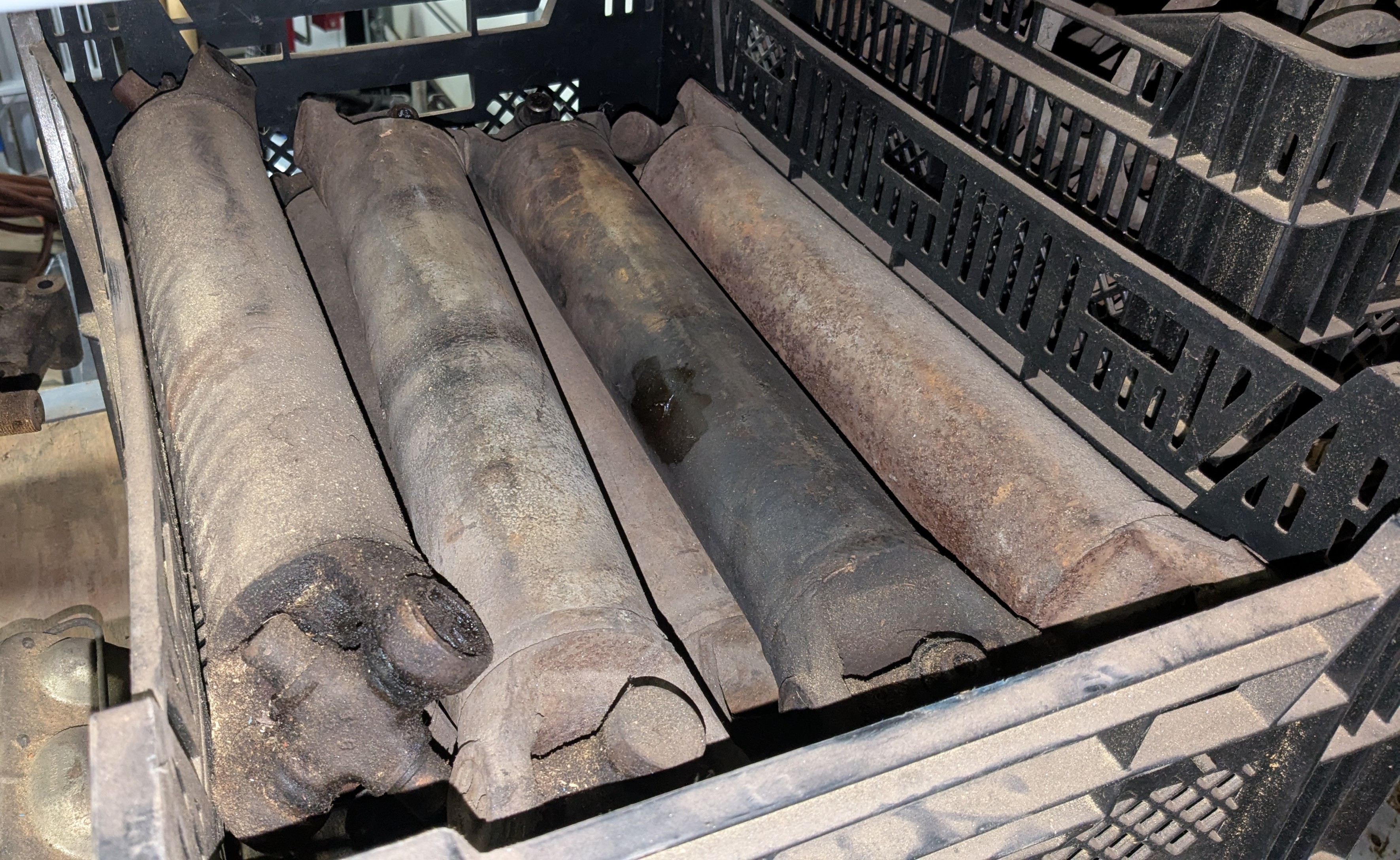

Between the different model years, body styles, transmissions, and related performance mods, was there any variation among LM rear axles? I've found three crates of the things so far tonight. Not sure whether there is any finer detail to be mindful of during the sort.

All the LM car rear axles are the same, 1965-69.

The only difference you may find on USED axle drive shafts is the universal joint. Some aftermarket u-joints installed by unknown persons may have used a one with a fitting for a grease gun.

Not much seems to go wrong with them except getting scored by a low hanging heater hose.
Re: LM Axle Question
I always wondered about reports of the heater hose wire cutting into a shaft, THEN I found a worn shaft on a car. AMAZINGLY the metal was worn down about 1/16" were the hose rubbed on the tube!!! That hose wire must be hard!!!jimbrandberg wrote: ↑Wed Apr 16, 2025 5:03 am Not much seems to go wrong with them except getting scored by a low hanging heater hose.

I've seen the early axles also cut into by the heater hose wire. I've also seen LM axles rusted in two, but not on cars in use....
I also have seen axles which had the ears bent when u-joints were installed/removed and put the joint into a bind. Usually a slight bind can be fixed with BFH applied correctly. This applies to long driveshafts also.
