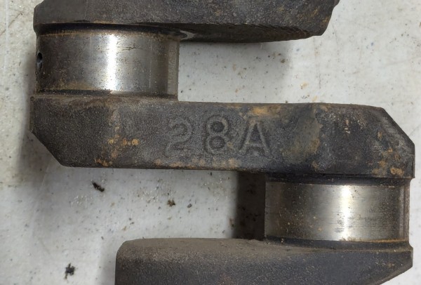

I've pulled one from the group and photographed its markings.

It seems this one is nitrided. Here is what the ampersand marking on the flywheel end of the crankshaft actually looks like:

Sorry about the misleading info regarding which end the stamp is on. Old man syndrome trying to remember little details. Get them wrong occasionally and my photo didn't help. That photo was of a crankshaft of a group I had nitrided down in Florida. Photo mislead me which end it was on. I had 6 bare crankshafts done. I put the ampersand on the flywheel end, when I got them back from nitriding and the machine shop final check. Then, it could be identified as a post production nitrided crankshaft, it got the ampersand and a number. The #3 is the 3rd line item in my document, defining of what engine sn it came from. That was way back in 2016.

Not entirely your fault "Old Man". I think your pictures are of the flywheel end......there's just no hub pressed on yet. See where the torque converter left its signature mark? On the other one it looks like a pilot bushing that didn't like nitriding.

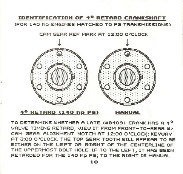

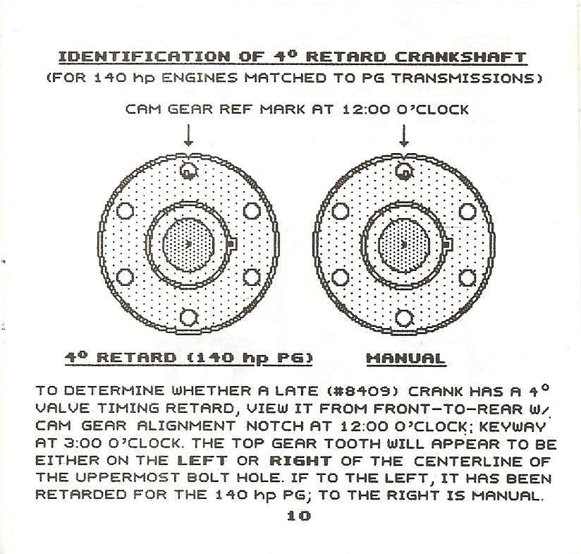

I didn't follow the link above either but I'll add that 140 PG crankshafts have a special gear to retard the cam timing 4 degrees. There's a picture in the Junkyard Primer book that shows how to tell when viewing a tooth through one of the holes.
- Posts: 336
Re: Crankshaft Identification
jimbrandberg wrote: ↑Tue Apr 08, 2025 5:13 am I didn't follow the link above either but I'll add that 140 PG crankshafts have a special gear to retard the cam timing 4 degrees. There's a picture in the Junkyard Primer book that shows how to tell when viewing a tooth through one of the holes.
Anyone have that photo handy?
