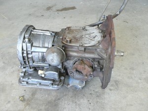

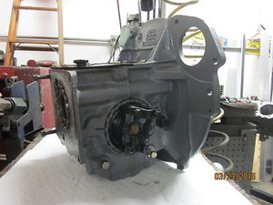

Hopefully the illustrations below will help you to visualize the components in the back of your Corvair that connect engine power to the rear wheels. With an automatic transmission arrangement, power from the engine is linked to the transmission via a fluid coupling called a torque converter. From the torque converter that power is transferred via a long shaft to the transmission that provides shifting (first gear, second gear, neutral, reverse). The power is then sent back to the differential in the middle, where it takes a 90° turn and is distributed via the two axles to the rear wheels. The whole assembly of the transmission and differential is called a transaxle. The transaxle is unique to the rear engine vehicle in that it is a combined package. With a front engine, rear wheel drive car, the transmission is mounted directly on the engine and is connected via a driveshaft to the differential at the rear of the car, which in turn transfers the power to the rear wheels.
1964 DIFFERENTIAL
DIFFERENTIAL AND AXLE ASSEMBLIES - EXPLODED VIEW
POWERGLIDE 2-SPEED AUTOMATIC TRANSMISSION
DIFFERENTIAL AXLE YOKE WITH UNIVERSAL JOINT
COMPLETE TRANSAXLE WITH POWERGLIDE TRANSMISSION AND DIFFERENTIAL
1964 Corvair Transverse Leaf Spring (Suspension component attaches to the differential in the center)
The axle bearings are physically located behind the wheel hub on each wheel, and supports the weight of the vehicle on each axle. If an axle bearing failed during the time you were towing the vehicle, it may have separated and allowed the axle and attached wheel to pull free from the differential. As shown in the above picture, the axle yoke is simply a splined shaft that inserts in each side of the differential. The universal joints that are a part of each axle yoke allow for flexibility as the wheels move up and down while the vehicle is driven. In 1960-1964 Corvairs the axle yolks are not bolted to the differential. They are simply held in place by the wheel bearings and the axles, and are free to pull out of the differential if the wheel bearing assembly is detached from the suspension, or if it breaks and fails, which would allow the wheel and axle to pull out of the differential. Under these circumstances damage to the differential and transmission would be unlikely. However, oil circulation within the Powerglide transmission is only accomplished with the engine running, which in turn drives the pumps within the transmission to circulate oil. Towing the vehicle on the ground would cause the rear wheels to turn the differential, which would in-turn turn some components within the Powerglide transmission. Under these circumstances there would be little or no oil circulation within the Powerglide transmission to lubricate the spinning components. That is why towing the car on the ground can damage the Powerglide transmission. On a normal front engine, rear wheel drive car with an automatic transmission, it would be recommended that the driveshaft be removed that connects the differential to the transmission while towing the vehicle. This would prevent the rear wheels and differential from turning the transmission components without oil circulation being provided because of the idle engine. Separating power transmission between the rear wheels and the integrated Powerglide transmission on the transaxle is not possible. That is why it is not recommended that automatic transmission-based Corvair be towed with the rear wheels on the ground.
