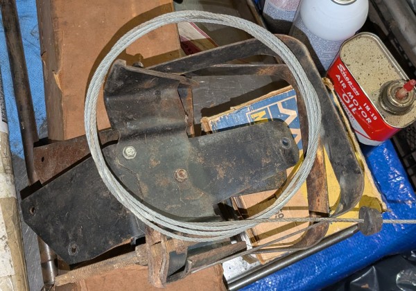

Is this circled part the special bracket you're talking about, or is it something on the other side of the firewall / whatever panel that provides this assembly something to bolt to?
AZDave Washer Fluid Bracket.jpg (26.75 KiB) Viewed 99 times
They're not nicely plated like what you have photographed, but I've found these two in a crate of otherwise random parts. Will put them with the A/C parts if it is warranted.

That is the bracket. I have NEVER seen them plated, just painted black. That said ---- I have not seen many either and some may have been plated, or someone made a copy.

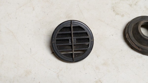

12) This Thing
Showed up in another crate alongside another compressor. Looks like a vent register, but not sure where it would live, or what kind of Corvair it might belong to.

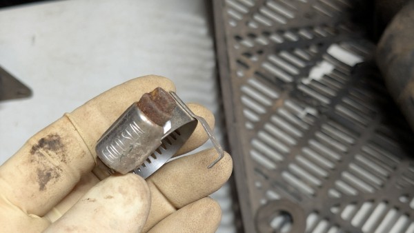

13) Refrigerant Hose Clamps
The clamps I've found so far have a little tab hanging off of them. Is this feature a must-have for hanging onto the hoses in this application?

The tabs are to space the clamps the proper distance from the end of the hose so that it correctly engages the barbs on the tube. I remember those vents, but don't remember what they were on.

That is the vent register that goes in the evaporator housing. Swivels to direct air mostly to the passenger area.

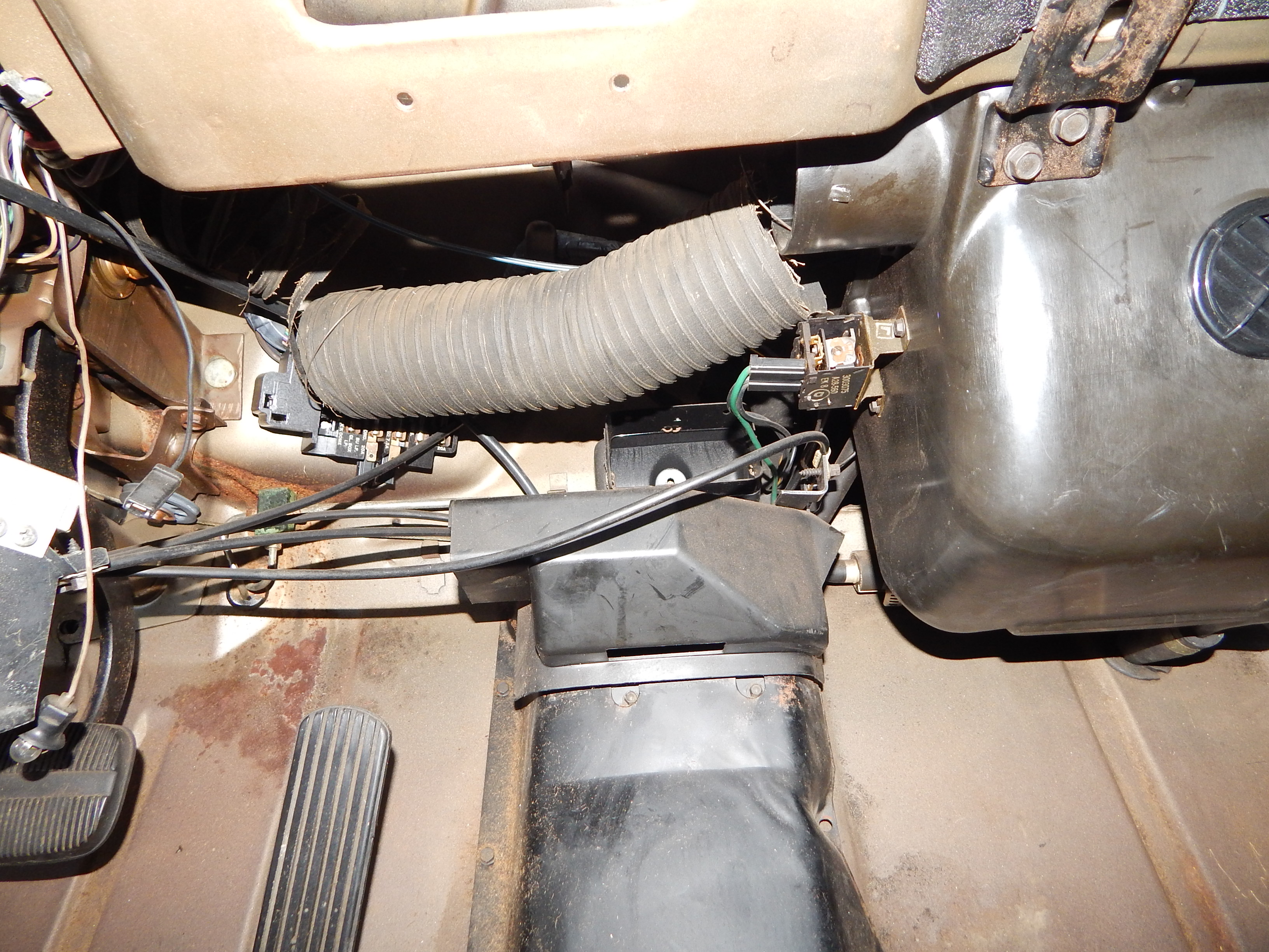

Correct. Last week I was talking to a fellow about the LM Corvair A/C. That vent goes in a hole in the LM evaporator plastic housing the hangs under the glove box. That circular vent was NOT in all the evaporator cases!! Not sure when it was used.
That vent goes missing as the flimsy wire spring that holds it in rusts away and the vent falls out. It directed air to the "lower" body parts of the passenger. The industry calls it a "crotch cooler". See picture of original A/C, but only half of the circular vent is in the upper right side of picture.
