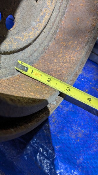

vairmech wrote: Sun May 04, 2025 5:19 pm Show a picture with a tape measure somewhere.
Front:
Rear:

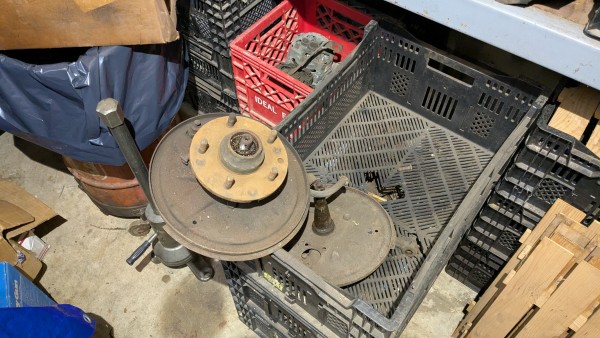

As it turns out, I've come across a crate of LM front spindles.
Seems the 1177 drums I have are hub-centric.

All drums are hub-centric because they have to be centered to the spindle. The lug nuts will not center the drum.
