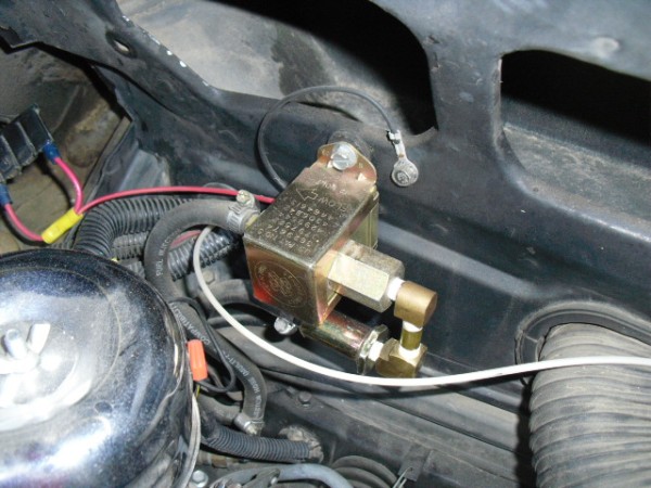

In 1989 I bought a 100% USA made Facet pump for $22, it's been in my engine compartment for 36 years, 3 engine rebuilds, 2 diffs and over 300,000 miles, You get what you pay for I guess.

Dave you should let them know, that’s a hell of a track record!

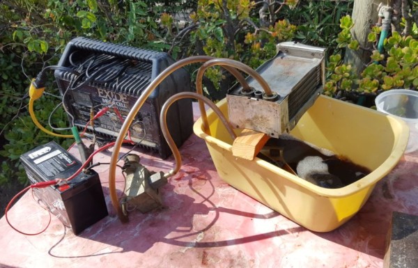

LOL, I used a Facet Cube style pump from a early 70's Mazda rotary pickup that was being scrapped to pump solvent through my oil cooler. That one is likely over 50 years old. For the Corvair I have two, new "Genuine" Chinese pumps that have been used for some time without incident (but always carry a spare) as well as an ancient Bap Geon (with external transistor) and a new-ish Purolator. Anytime I see a Cube style pump $5 and under at swap meets I grab them.
