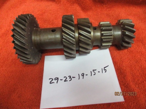

Rotary FP46 wrote:
Modified transmissions will have a different tooth count.
HTH
Marty Scarr
If you remove the side cover of the trans, you should be able to count the teeth on the cluster gear. Front to back they should be 29-23-19-15-15 On the main shaft the tooth count should be 18-21-26-29Will need to learn how to check the gearing on those.
A high torque/HP application, good for a V8 powered car.what would have been the most likely range of applications for that setup?

martyscarr wrote: ↑Mon Apr 14, 2025 8:42 am Rotary FP46 wrote:If you remove the side cover of the trans, you should be able to count the teeth on the cluster gear. Front to back they should be 29-23-19-15-15 stock saginaw cluster.jpg On the main shaft the tooth count should be 18-21-26-29Will need to learn how to check the gearing on those.
HTH
Marty Scarr
Removed the side cover. For the most part, gear tooth counts on both shafts match what you have listed. Couldn't find a reference point on the last gear of the cluster. It likely has 15 teeth, but I cannot honestly say I took the extra steps needed to get an accurate count on that one.
Just a normal 66+ 4-speed, it seems.
