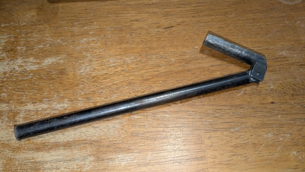

Clarks Push Rod Tube Remover (about $77) Make sure to adjust nut to have it just snug , so tube adapter is not loose.
https://ssl.corvair.com/user-cgi/search.cgi?part=C5346

4 years & 15k on my push rod tube seals, when I had to pull them in 2021 for the camshaft change. Only the Clarks tool was used to push the tubes out. No hammer. Line up tool and used my hand force to push them out.

It is the 25+ year old Neoprene (Buna-N) o-rings that fight you. My go to is a 8 oz. ball peen hammer on a homemade version of the Clark's tool (w/o swivel). You can see how many tubes I hammered out with hard seals on them.

Lane66Monza wrote: ↑Thu Mar 20, 2025 4:47 am Good suggestions that work is what we are all about.
Here are other tools known to work.
THANK you, Al. I found this thing while going through the tool chests months ago. I've seen a lot of tools, and still didn't know what to make of this. Thought it would end up being something really weird...like a horse speculum. Can finally put this one to bed.
Mwahaha.
Matthew Rose
Eldersburg, MD
1965 Monza
1966 Corsa Convertible
1963 Rampside
Many Tons of Parts

Glad I could help with the photo of a tool.
