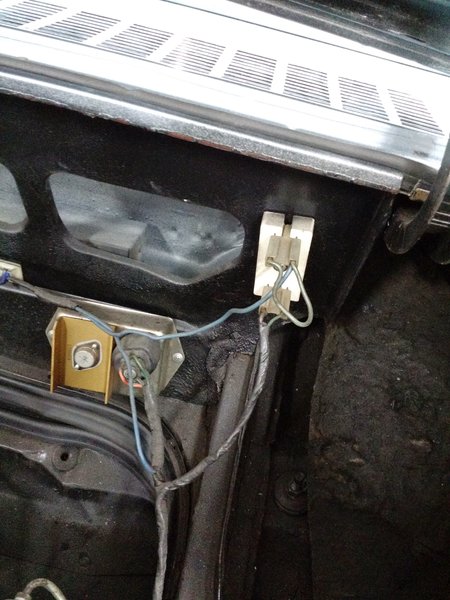

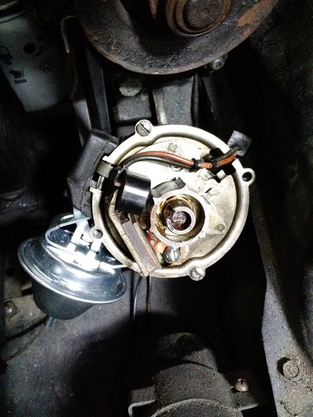

Im finally getting some time to go over my car since purchasing around the holidays and noticed a few things of interest. The distributor has some type of older pointless ignition system (WELLS?) and I am looking to get some more info on what is installed if possible (see pictures attached).

coppertop666 wrote:The distributor has some type of older pointless ignition system (WELLS?) and I am looking to get some more info on what is installed if possible.
looks like a dale hei conversion. you can use the mopar electronics box like you have or a gm hei module if the mopar box dies & you want something smaller.

Its a 319 Dizzy on a 110 - any tips from the experts out there regarding timing and or plug gaps etc? Also Brad Bodie noticed in a previous post that the vacuum advance was disconnected and plugged by the PO, is this something that was common for this type of conversion for some reason?

The breakerless ignition conversion eliminates the antiquated ignition points and condenser — a system that was difficult to maintain for accurate and consistent timing.
New ignition points begin to wear out from burning and arcing as soon as they are placed in service. As the point gap changes with wear and use, the dwell and timing changes. In the Corvair (and other vehicles that utilize ignition points) the Chevrolet design engineers inserted a ballast resistor in the primary ignition circuit to reduce the voltage from approximately 12 VDC to a nominal 6-7 VDC. This lower voltage reduces the high secondary output voltage produced by the coil, but it is still considered adequate for normal operation. The reduced voltage reduces arcing and burning of the ignition points, which extends the expected length of operational service. The primary ignition circuit is also connected to a switched voltage output of the starter solenoid. Whenever the starter is engaged, voltage to the coil primary circuit is increased to a full 12 VDC for the duration of the engine cranking cycle. This boosts the high voltage spark output of the coil, to help promote engine starting. As soon as the engine starts and the starter is disengaged, the primary ignition coil circuit reverts back to the normal 6-7 VDC.
The ignition points system was found in cars from about 1910 through the 1970's. Electronic switching began to be phased in and modern cars no longer use ignition points. The electronic switching system is generally more reliable and is not subject to the continuous variations found with ignition points. As a result timing control is much-more accurate. As sensor-based computer control was phased in, centrifugal and vacuum advance mechanisms were also phased out.
Electronic control of the ignition coil was made available as a modification to the Corvair distributor decades ago, but the need for both centrifugal and vacuum advance in the Corvair ignition system remains.
