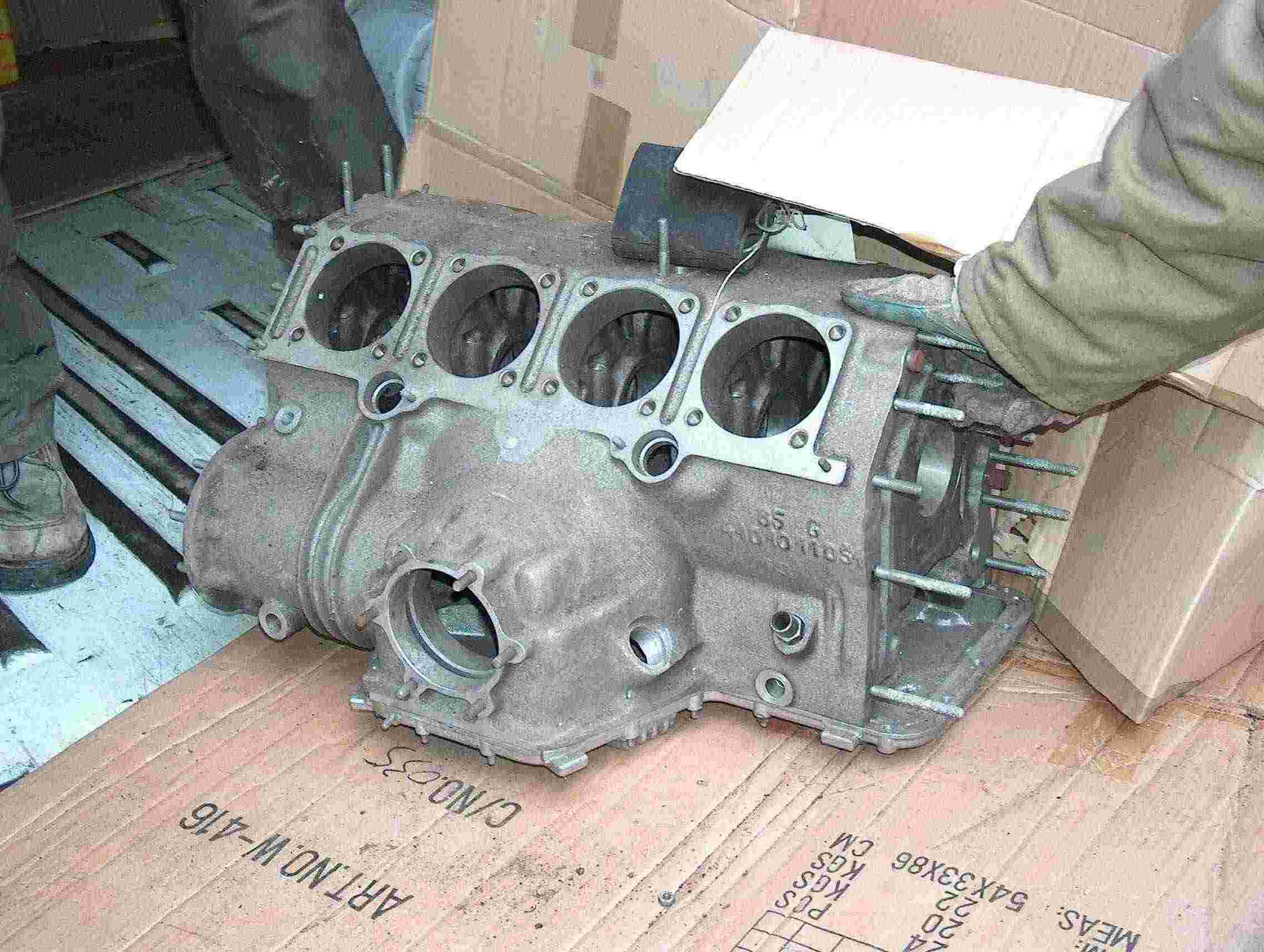

I spoke with Ray Sedman about having a billet 8-cylinder crankshaft made for such an engine, and he said he would be happy to do the work but that the cost would run somewhere north of $2000. I have a pair of engine cases squirreled away in the garage for whenever I am finally able to scrape up enough money to actually go for it, till then it's just a crazy idea I had been kicking around. Even have the TIG machine now to be able to join the cases together.
Biggest problem is that no 2 cases are alike when it comes to dimensions, meaning you can't even align the crank/cam tunnels between the two in order to weld them together. Instead you would get them close enough, keeping in mind the top cover and oil pan surfaces, do the welding, then linebore both tunnels and machine all the other surfaces to make them match. A lot of work to be sure, but it could be done. I anticipate I'll have my own mill capable of doing this work myself before beginning, which means it could be a lot of years before I get around to it. Only when I am successful in joining the 2 will I give Ray a call, so he can chuck me up a piece of 4340 and go to town on it...
Then there's the heads- since the cylinders come in 3's, you have 2 options:
1. weld a 4th cylinder onto a Corvair head, do the necessary machine work- do this twice.
2. Cut a cylinder off a Corvair head, then simply add the valve cover rail- do it 4 times.
Personally I'd rather have 2-cylinders/head rather than a super long 4-cylinder one, for the simple fact that it would be easier to do and it would also be easier to remove/replace 2-cylinder heads in the event something goes wrong. And you still have all the other problems with how to cool it and handle induction, but those are simple compared to assembling the longblock for sure. My engine would be fuel injected with ITB's, but would be set up for low RPM torque production with a roller cam- another Sedman part.
