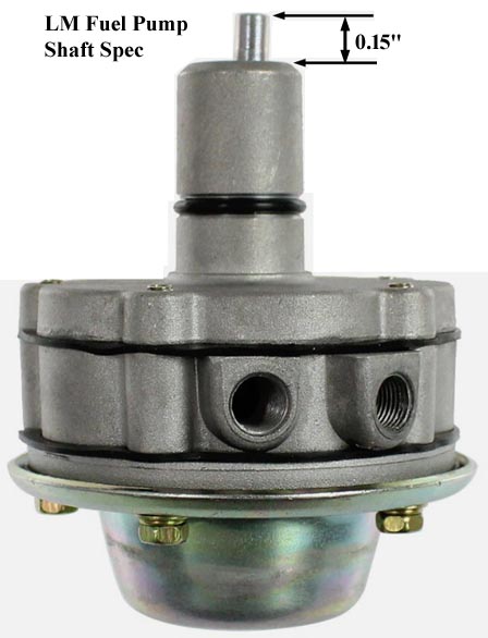

A longer shaft pump can be used in a LM engine requiring the short shaft. But it is either opening up the pump and swapping in a short shaft or trimming the shaft.
I have a long shaft pump that Bill Pritchard checked out this weekend and he said it was a good pump. He also mentioned it is a Delco pump. It is for sale, as I only use electric pumps. Ad to be posted as soon as I get it out of the trailker and take photos. I have to get the failed ones out to get the short shaft out for supplement to pump, if needed.
The fix for my pump to fit LM engines needing the short shaft is easy: grind the stem down a bit, until it is about 0.15" long from housing stem casting. But I can also supply a shaft from a frozen up LM short shaft pump, I will be scrapping.

If you need to shorten the rod coming out of the pump I would probably measure from the dimple, if it has one. If they can't make the rod the correct length, what are the odds they got the height from the dimple to the bottom of the casting correct?

With the thought of, "Don't raise the bridge..., lower the river," it would seem some simple spacer rings would solve the "too long" rod problem. And it would make the "dimple" a moot point. Install the pump tighten the bolt (to mark), remove pump, drill indent. Even have a cardboard "Go/No Go" gage to determine the size (or number of) spacers. It seems so simple I'm surprised there isn't a "Sticky" for it.

Or change shaft with a known proper shaft from failed short shaft pump.
Shaft is crimped to the rubber diaphragms, so changing the shaft means using the failed rubber diaphragms.

Thank you ,Frank. I didn't know the insides of a good pump. The pumps I scrapped, the shafts were not attached.
Now I don't have to look for the frozen pumps in the trailer I took to Helen. Just have to locate the good long shaft pump in one of the bins in the trailer.

When it takes just a couple of minutes to measure and grind off the rod why would you to do it any other way?
