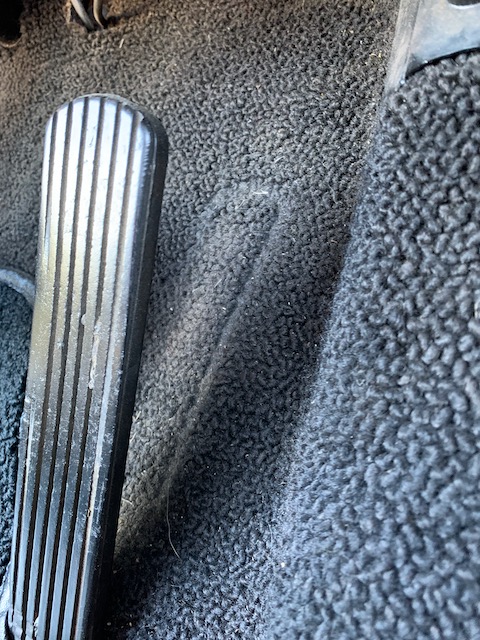

Take off your shoes before you go in the house, Gary.
