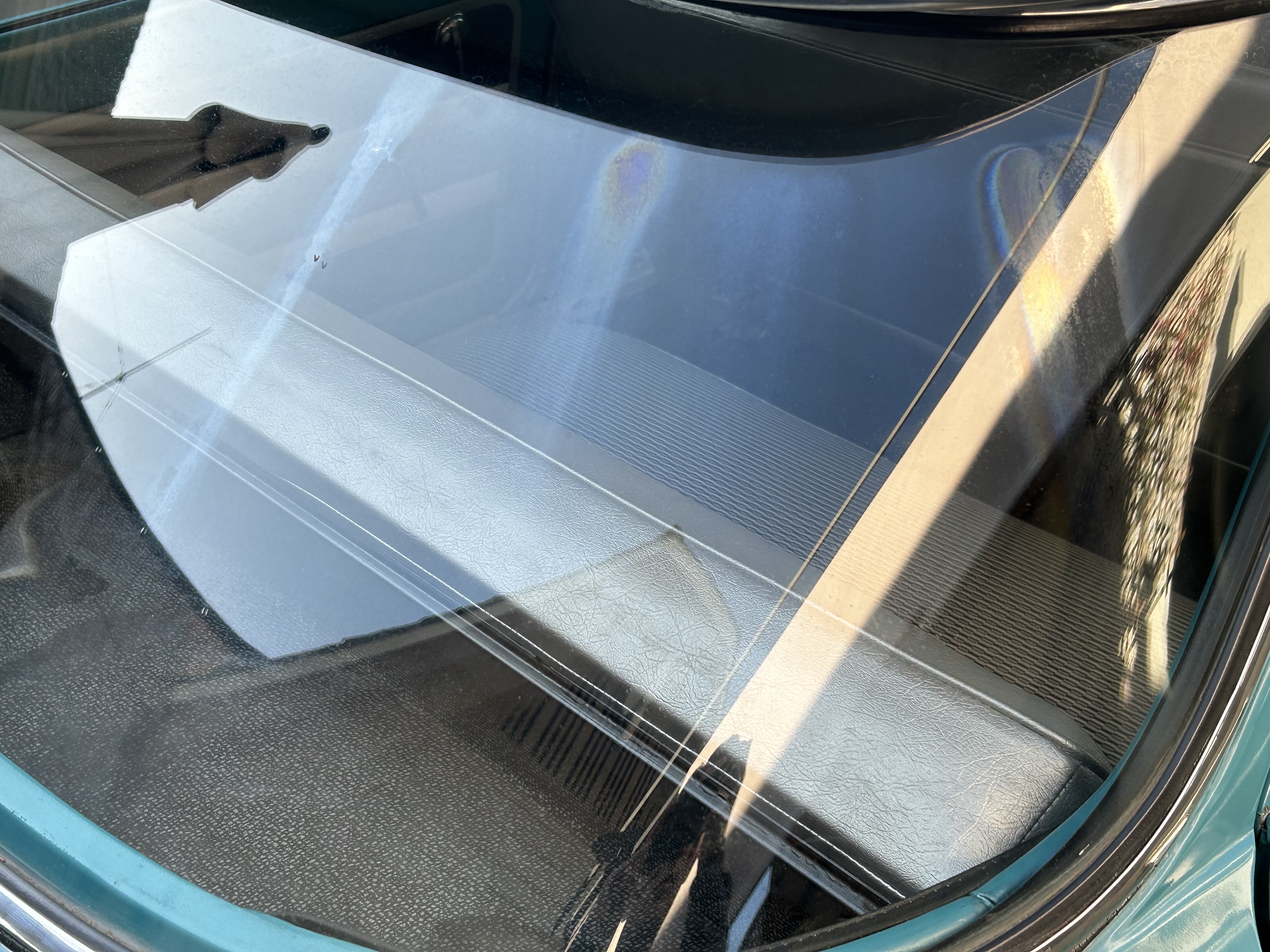

Ever since I bought my Corvair sedan, there have been these noticeable vertical streaks on the rear window, which seem to align with the drain ports from the roof's overhang. The streaks are discolored, only residing on the outside of the glass. Doing some research, these may or may not be related to rusty water. I have used solvent to try to remove them, but they're persistent.

That doesn't seem to work. The stains are perfectly leveled with the glass surface, smooth to the touch. I've tried solvents such as acetone, and no luck.

Yes rusty drainage will STICK to glass. You will need to use glass polish, BUT go online and learn how to use it. 3M makes a good product, but it is a big bottle and about $100.00!!!! Griots Garage sells a small bottle (you won't need much) Glass Polish #11017. Prices vary, but Amazon seems to have a good price.
Your stains are mild so use a "fine" glass polish. If you use a "coarse" polish, you will have to go over it with a "fine" polish.
All kinds of "kits" to polish glass and many come with pads to use in a small electric drill. BEWARE that if you get an area too hot the glass WILL SHATTER!
A razor blade will remove major crud, but it tends to scratch the glass!!!! BTDT

Before using any kind of abrasive, try vinegar or some CLR. Often, strong solvents such as lacquer thinner, acetone, mineral spirits, etc. will have little to no effect on some stains that are water soluble
Posts: 6563
Re: Removing Rust Streaks on Window
Vinegar will slooowly remove rust
CLR is good, but do a test area since some say it will etch glass, others say it is safe. Maybe it is the type of glass???
DO NOT LET CLR get on metal, paint, or polished stainless trim !!!!!!!!!!!!!
Steel wool or scouring powder work, but they WILL leave minor scratches that you will need to polish out to get rid of.
The pictures of the stains indicate you should not need an aggressive cutting agent like steel wool or scouring powder.
