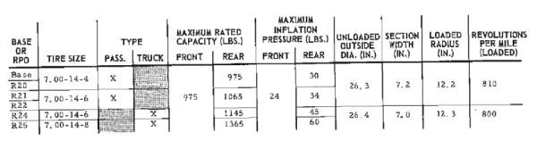

Let's back up a bit, what did GM originally specify for the FCs?
Per the 64 FC engineering specs, it seems like the vans could either have a standard 4 ply tire, or a 6 ply tire option.
It seems to imply that trucks either had a 6 ply or 8 ply tire. Remember, bias ply.
Theoretically, a 4 ply equivalent passenger tire should be adequate based on this. But we also know that at least some FC people and some VW people don't think highly of passenger tires. I'm not old enough to have ever experienced bias-ply tires (feel old yet?

Our FCs are lighter and get by with a lower load index. Per the 64 engineering specs the FC weight tops out at around 4600 lbs with curb weight and a full load. If I assume a 50-50 weight distribution that puts around 1150 lbs on each tire at full load.
This would equate to a minimum load index of 87, or 90 for a Passenger tire with load derating considered. Since it would be difficult to find a tire with an index this low, the load index on most tires is acceptable. This is also why I didn't calculate the numbers more accurately.
Since we want better, we want more than a 4 ply equivalent SL tire. There are also XL range passenger tires available for some sizes, these should theoretically be slightly stiffer as a result of a bit more load capacity. Actual confirmation of this was impossible to find. There is also no published construction information to compare an SL to an XL tire.

If you look through the Samba thread, you'll see that the VW busses need a higher load index of around 100 to be acceptable for use. This has the adverse affect of tires that fall below this being unmentioned and untested in the threads.
Generally, a load index of 90, or greater, is acceptable

For my Greenbrier van (sold) , I did a search and found the factory 7.00-14 tire had a 26.8 diameter. 225/60R15 tire has a 25.6 diameter, but with a tire search for Corvair tires it seemed to be the prevalent tire of choice. The 215/70R15 seems closer to diameter at 26.9". I will get with local Goodyear store and see what they have in this size and reasonable cost.
