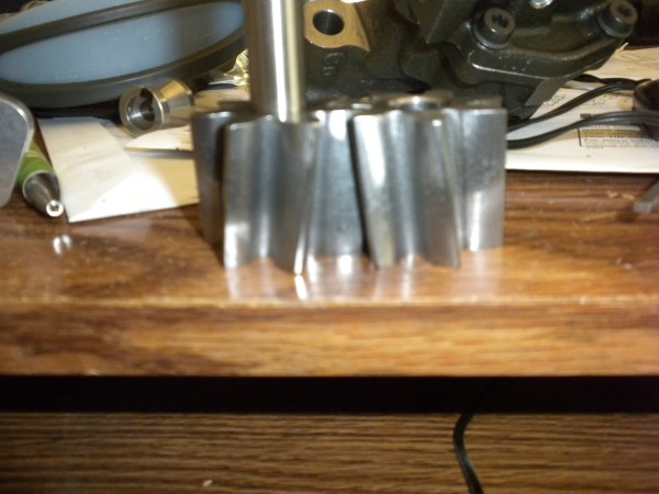

Where did those fancy gears come from?
Re: oil pressure
I bought those from Melling supplier, they are only available by buying the complete HV small block pump assembly.
That SBC HV pump is the same size as the old 7 lobe 409 pump that we use for HV pumps. It is freaking UNREAL how smooth
and effortless those Shark Tooth gears turn compared to the older straight cut gears.
